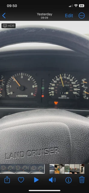

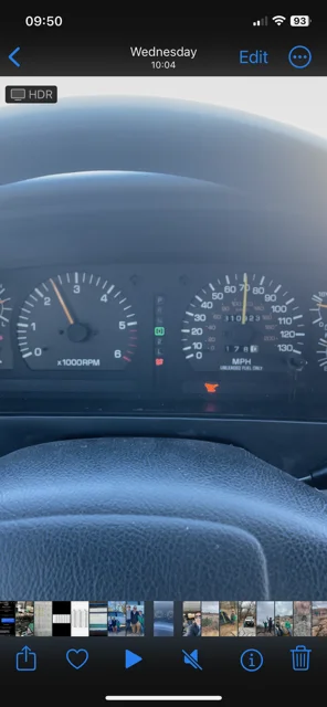

Shifting gears, literally. Using the Overland bound app as a speedometer check. My speedo is off about 6mph. On the slow side. Indicates 6mph slow. That’s with a gm4L80 and stock LC gearing on 35s. I took some videos of speed and eng rpms to see if I’m in an appropriate power band or cruising rpm. I think I’m over revving for current speed. Burning extra fuel.
Onscreen shots of videos. Realize, this is 5-6mph slow. So it’s closer to 65 and 75. For an rpm comparison.
65mph- 2150/2200 RPMs
75/76 mph- 2400 RPMs
Does anyone have any insight or comparisons?? I think I’m really hurting in fuel economy at highway speeds. Now I know it ain’t a Prius. But I want to make sure I’m not wasting fuel economy, thinking about longer trips and fuel efficiency for off road destinations.

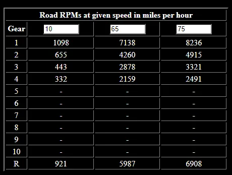

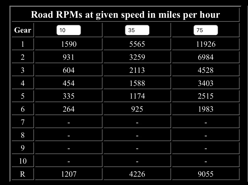

The 4L80e has a 0.75 overdrive ratio which isn’t ideal for that setup. Here’s what the calculator kicks out for your configuration.
The 4L60e has a higher overdrive at 0.70 which drops the RPM to a better point.
A 6L80e drops is even further:
-Rob

Something is wrong. Your math doesn't math.
Is the converter locked? Do you have underdrive gearing in the transfercase?

Not sure what you mean my math is incorrect. I didn’t do any yet, The Toyota gear train is stock. It has a stock 4L80e in it. I “believe” the torque converter is locking. It is shifting smoothly and the pedal to engine feel seems to becorrect for a locked torque converter. Meaning I don’t feel I’m riding on the rpm’s, there is a lag when you ease into the pedal to pass then a down shift. But I could be wrong. I could drive it with a tuner to verify trans operation.
For the Toyota drive train. I should clarify, I didn’t do anything to it. Now I bought it at 310k. It was a grocery getter, so I doubt anything was done.

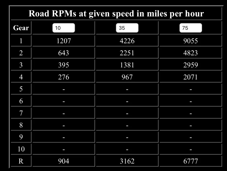

What calculator did you use?? According to that sheet. It says I should be closer to 2200 rpm’s at 75. I’m at 2400. So high but not crazy. Was it online that you put in some other data? Thank you for the post.

The specs you've given don't match the numbers you have. Something you have stated is not accurate if you have 2400@75.
I was involved with a similar 80 series situation and it turned out it had 4.56 gears installed. Nobody knew.

Ok, So either my speed is off for my estimate, or the rpms are off? Or based on your calculations, tire size or gear ration is throwing off your calculations. When I opened the transfercase, it seemed as if it had never been opened, so if something is different it would be in the differentials would be my guess.
To be specific, tire size is 315/75/R16.. so not quiet 35s I suppose
What is the gear ratio for the 94? Im messing around with that calculator now. I put in 4:10. I think that is correct. Pet that calculator I should be doing about 200 rpms less. Could be tolerance stacking errors, error int he RPM gauge, inaccurate speed etc.

Seems to work if you have 4.56 axle gears rather than 4.10
