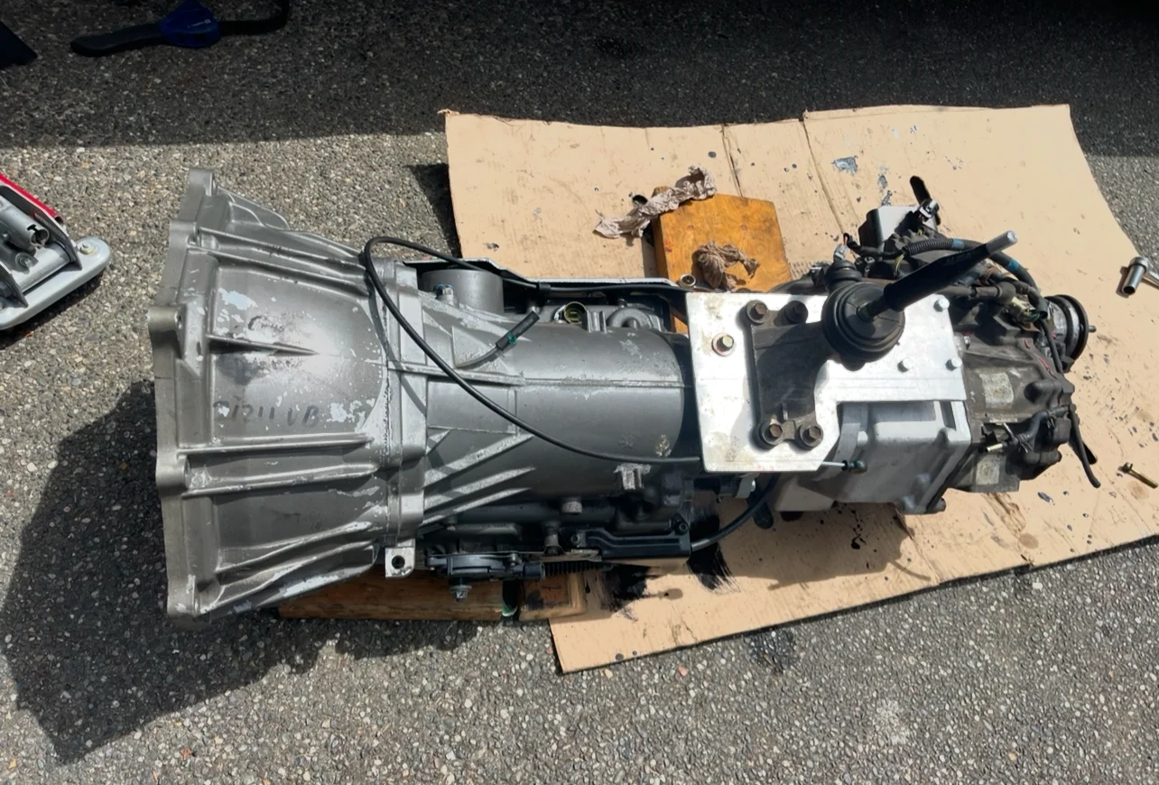

Sorry guys. I have been reading this thread for hours and I can’t find anything that anyone has done to adapt the later style hi/lo shifter to the marks 4l80 t case adapter. I know it was meant for the earlier years shifter. And I see what 808keith did with the earlier style shifter. My question and thought is to create an oversized plate that bolts to the adapter and then have the shifter bolt to the plate outside of the adapter. But that wont work because the shifter’s base covers the holes on the adapter.
Should I shell the cash out for a 94 model shifter?? I’d rather not
Ran into an issue like your situation. Won’t work. Had to ghettoly fabricated an aluminum plate. I used a 92 shifter, 4l60e transmission. My Lc is a 1997.

lol got it. Well I opened my box of parts again today. And my adapter didn’t even come with a plate. So I’m forced to fab one regardless haha

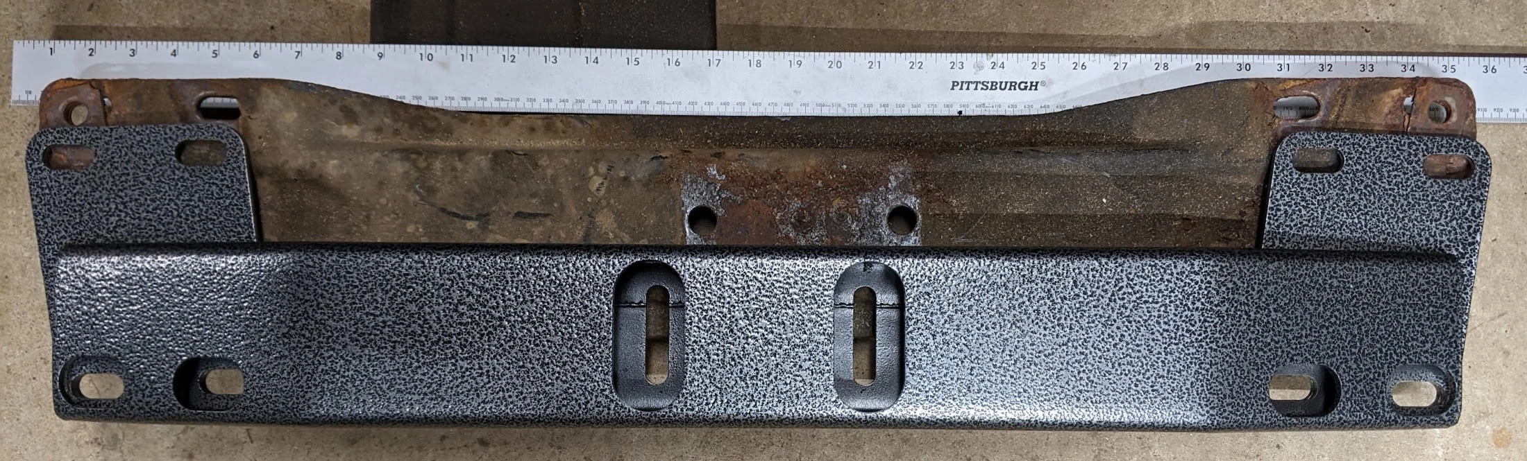

I originally was going to use the Selkirk offroad crossmember as well and bought it. I thought I could modify it for my use. Nope. I still have it if anyone wants to buy it. 😁
The Selkirk crossmember shifts the engine way to the US passenger side and forward, and it does assume using their mounts and not @cruisermatt mounts.
IMHO, it shifts the engine too far because you will run into oil pan/diff clearance issues, thus the reason for the mandatory lift. If your vehicle is a mall crawler, then this is probably fine. I will call it out though if I see it on a LS swapped vehicle looking to sell. 😄

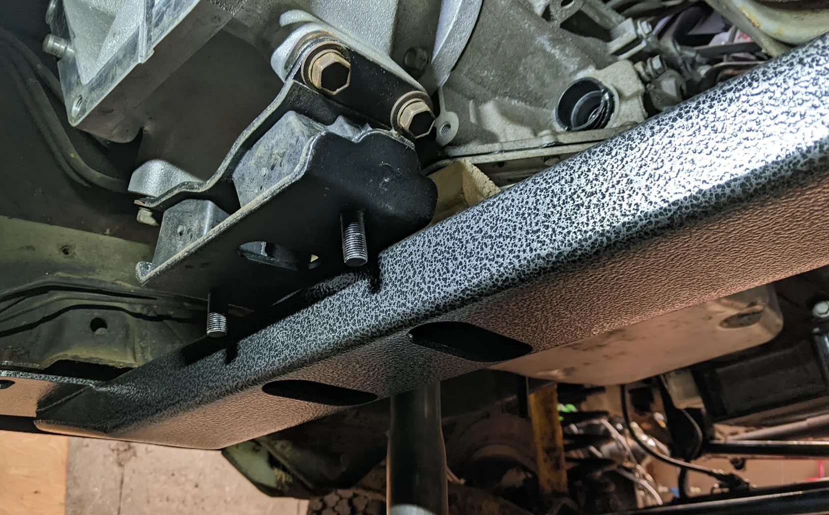

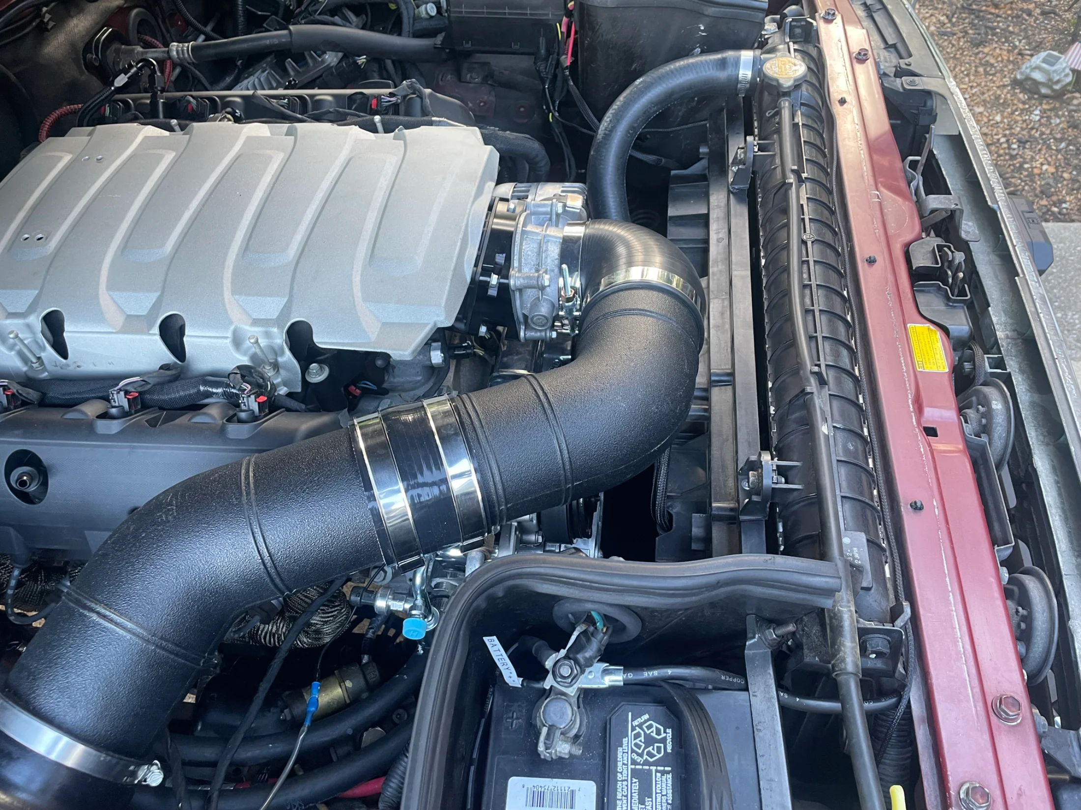

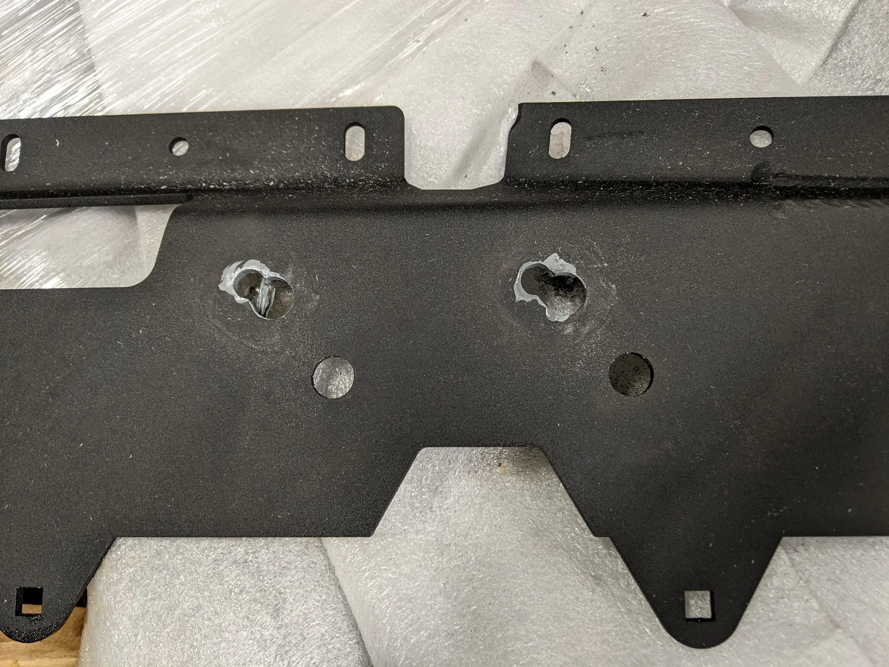

Here is my first attempt at using their crossmember. Not even close...
This is with Mark's 4WD mounts in the stock location with a 6L90e, which I think is slightly shorter than a 4L80e.
I later moved the engine mounts 1.25" forward and 1/2" to the US passenger side to gain clearance for the type II steering pump, found on gen IV/V motors. The return on those pumps point straight at the frame rail.
I ended up just drilling new holes in a DeltaVS crossmember. I ended up very close to the original Toyota mounting holes, just to the passenger side 0.5" since I did move the motor in that direction and to the back about 0.25-0.5". The other holes, down and to the right in the picture, is where DeltaVS thinks a LS swapped motor should be...way to the US driver's side and forward.
Mine did not come with a plate either and my tcase shifter is a 96. I already assumed from what I've seen from others I will be making my own plate adapter to get the shifter in the correct location even with an early style one with the correct bolt pattern.

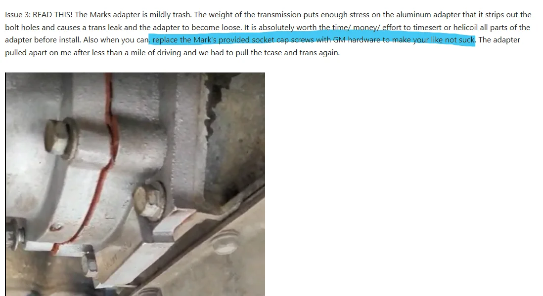

Hey guys. Maybe a dumb question. I’m going through Marks4wd install instruction to mate my 4l80 to the adapter and my t case. It says apply a small smear of silastic to the mating surfaces with the o-rings. Wtf is silastic? Are we creating a gasket here on the 2 mating surfaces? Do I use permatex rtv silicone? Do I use grease?

This youtube video on installing the mark's adapter was helpful for me. I used ultra black rtv.
According to Ai, Silastic is a trademarked name for a type of silicone elastomer, known for its flexibility and inertness. It's often used in medical implants, mold making, and various other applications where a flexible, durable material is needed. By the way, others advice to replace the less robust allen bolts with hex bolts.
Ok so we are making a gasket? That’s the point of using it. Hmm didn’t see any post on switching the hardware. Only on helicoiling the threads which is done. I will get some more hardware. That’s easy
