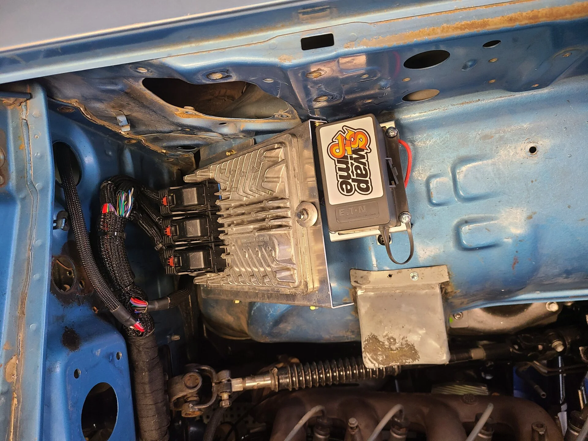

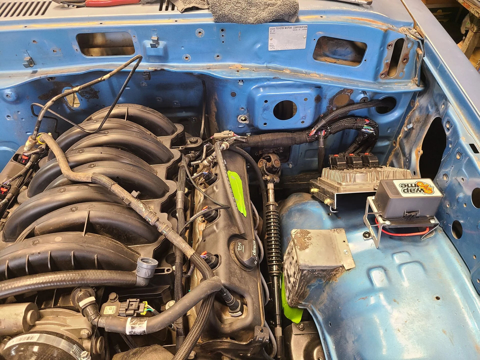

Got my ecu and fuse block mounted in my 60.

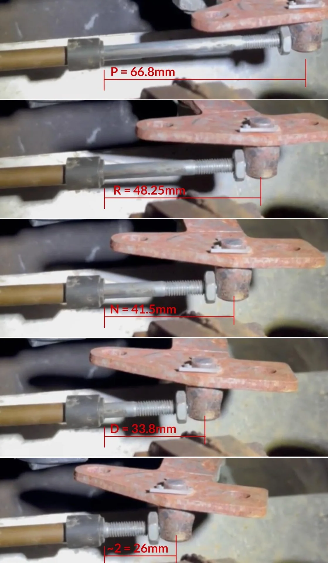

Ok, some more data hunting for the OEM shifter to 4L80E transmission issue. I got under the car with the wife at the controls. I shot this short video moving through P R N D and almost 2. You can see and hear something not quite right trying to move from D to 2. The cable looks like it could move a little further into the housing (the threads look smaller than the cable thickness) but it doesn't seem to want to. As far as I can tell, on the shifter linkage end there doesn't appear to be any physical restriction; the OEM shifter bracket looks like it could move further forward to pull more cable.

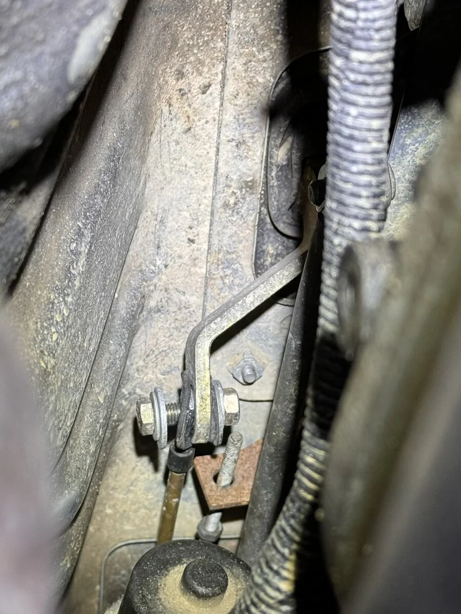

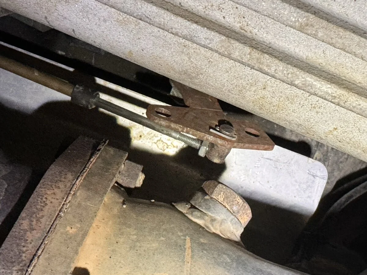

Here are some photos including step by step shifting through the available gears with cable measurements for reference (taken from the video linked above):

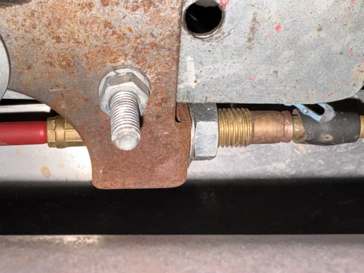

Transmission cable linkage:

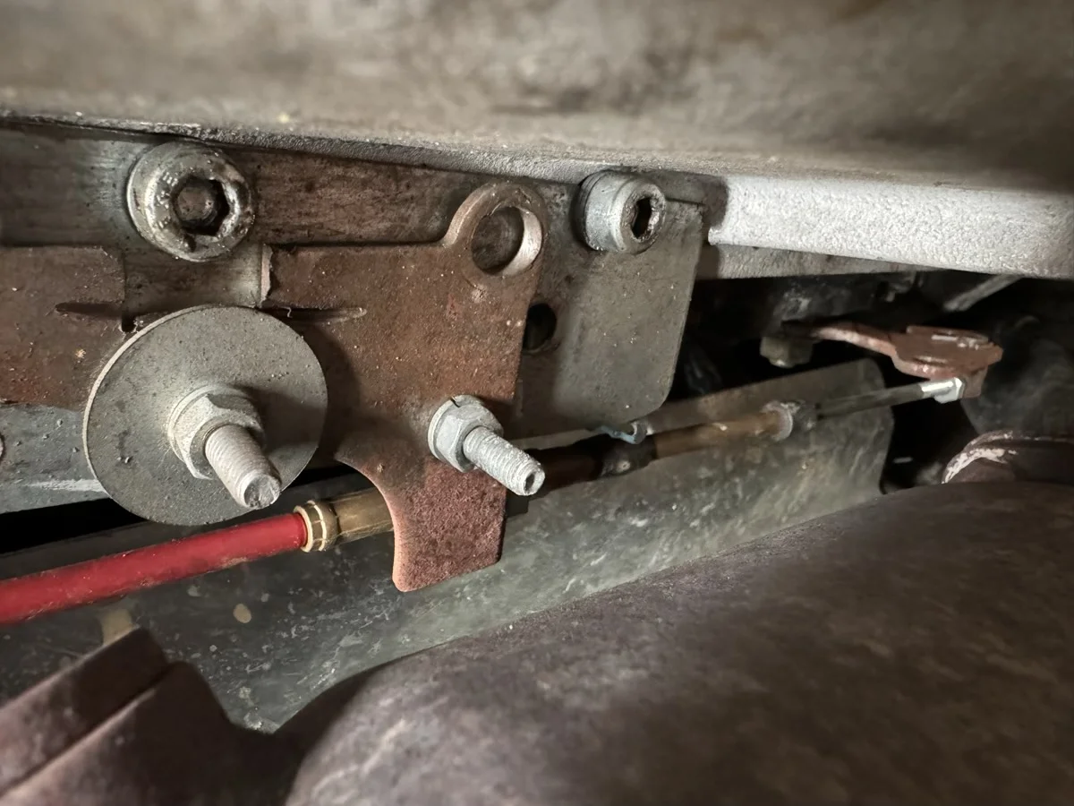

Bracket close up:
OEM shifter bracket ( pulls cable as you move from P to D):

So being new years eve with no work I got back under the car to test out a couple of extra things. Disconnected the cable from the 4L80E shift bracket thing and found:
  1. the shift bracket can be manually moved through all gears (6 clicks in total, so from P to R N D 3 2 1
  2. With the cable being detached, the OEM shifter moved smoothly between P and D, and was still some sort of binding preventing moving beyond D. It's not a hard stop though, it's slightly soft so no banging.
Given that I had previously visually inspected the shift lever bracket below the car and saw nothing that would be obviously rubbing/stopping movement, my current theory is that the installed cable does not have enough free length to pull for the 4L80E transmission. The cable measurements taken in the previous post show ~40mm cable pull between P and D+ (a bit beyond D before it binds). Looking at the photo on the B&M Racing webpage showing a shifter for a 4-speed GM transmission, I figured that the available cable length to pull was ~70+mm**. Could this be the culprit?

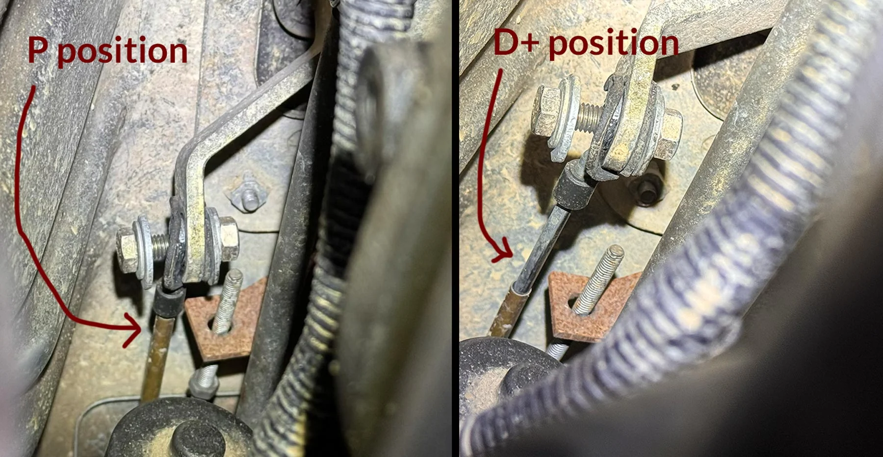

Here's how the shifter end of the cable looks when in P and then in D+:

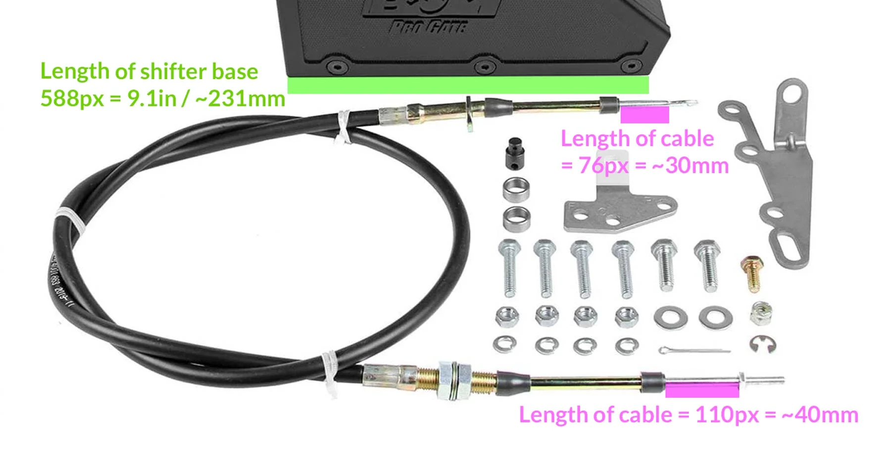

** And here's my back-of-the-photoshop calculation method on the B&M shifter:
UPDATE: 2.5” (75mm) of “cable stroke” according to the specs :)

I looked at the B&M shifter and the shift cable attaches above its pivot, and not very high up. You need to know this distance as well as the angle of the cable relative to the pivot. You need to mimic this with the FZJ80 shifter.

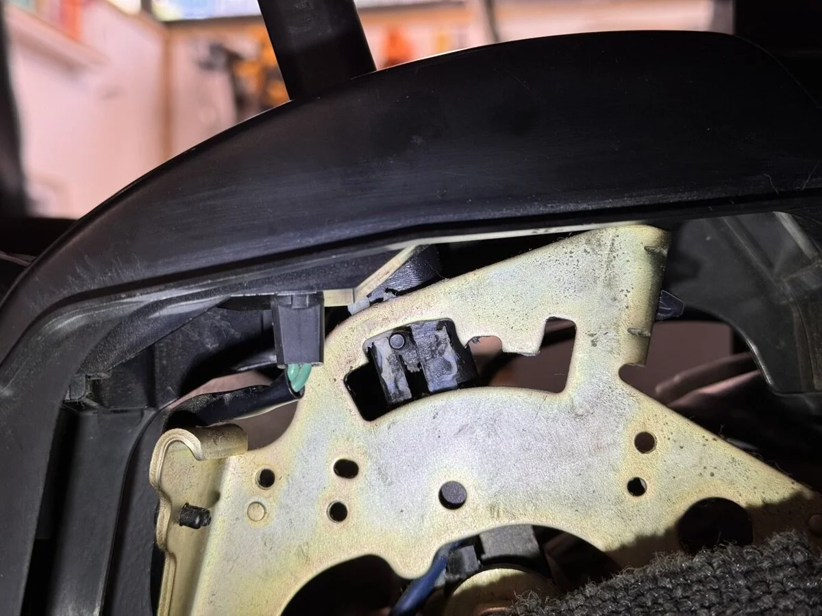

A) There are hard indents (gates) on the Toyota transmission shifter that force PRD2L positions. The gates are internal., rather than external like the B&M shifter.
B) Yes, the relative angle of the shift cable will change as it exits the cable housing. The 6l80e shifter cable end has provisions for slight angle changes as the transmission shifter travels through its arc. There should be zero back and forth movement in the cable to shifter connection, other than rotational.
Thanks for the info. Yes, it makes sense that there should be no forward back slop in the connection
You're right about the internal gates on the OEM shifter for P R N but below D the are no gates. I will have to attend to these if/when I try to restore my 2 and L gears. Currently P R N D are almost perfectly aligned to the trans indents. Hopefully I can get to this connection through the top rather than below as the exhaust and other bits are in the way. I've also noticed there is no heat shielding of the cable from the exhaust as is specified with a B&M shifter install. I wonder if 7+ years of LS swap driving has affected the cable somehow in the less-used gears 🤔
OEM shifter gates FZJ80:

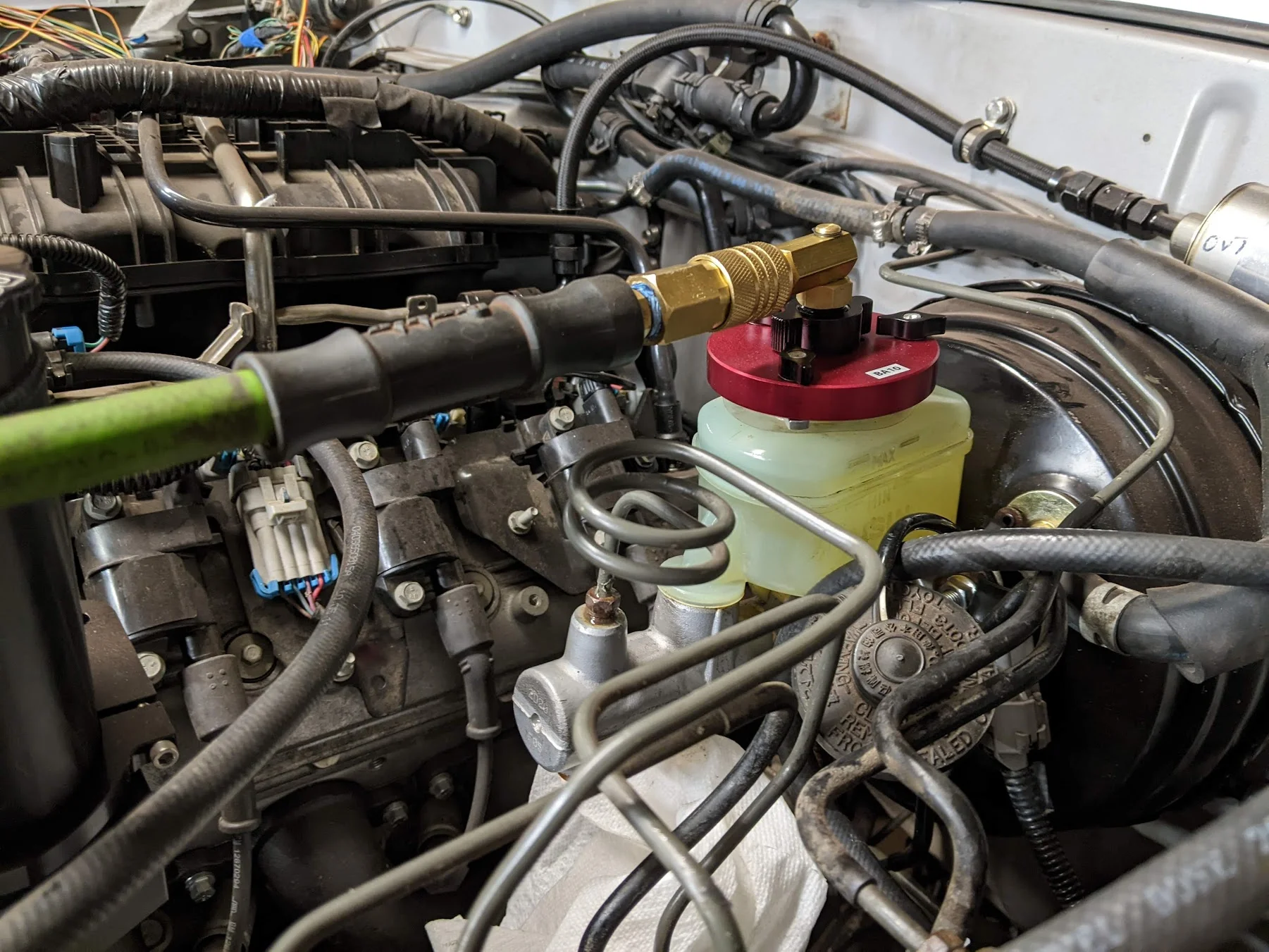

Since I am here...this is a beautiful thing for bleeding brakes. 15-20psi...just crack the lines... I don't know if it works yet since it isn't a runner yet, but it sure beats me yelling at my wife to "pump" and "hold". 😁

Yeah what is that thing? Does it work with no-one pressing on the pedal? To get all the fluid out of the master I would think one or two pumps is required. Beats my check valve on the drain line method if it works.
I used a similar one for another of my cars that was being painful to bleed, worth every cent. Pressurize system, bleed at each caliper as per usual bleed, depressurize and replace cap.
Awesome tool to have. Looks like that one has a universal clamping reservoir lid, very cool.
