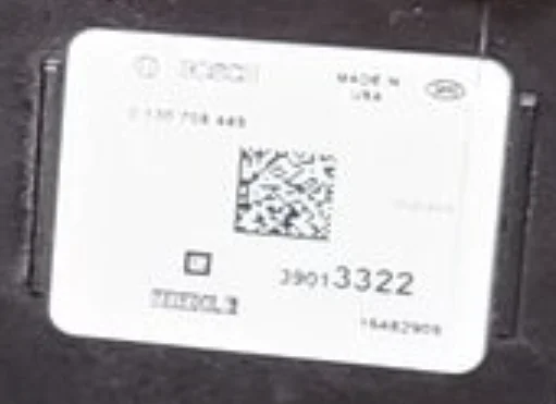

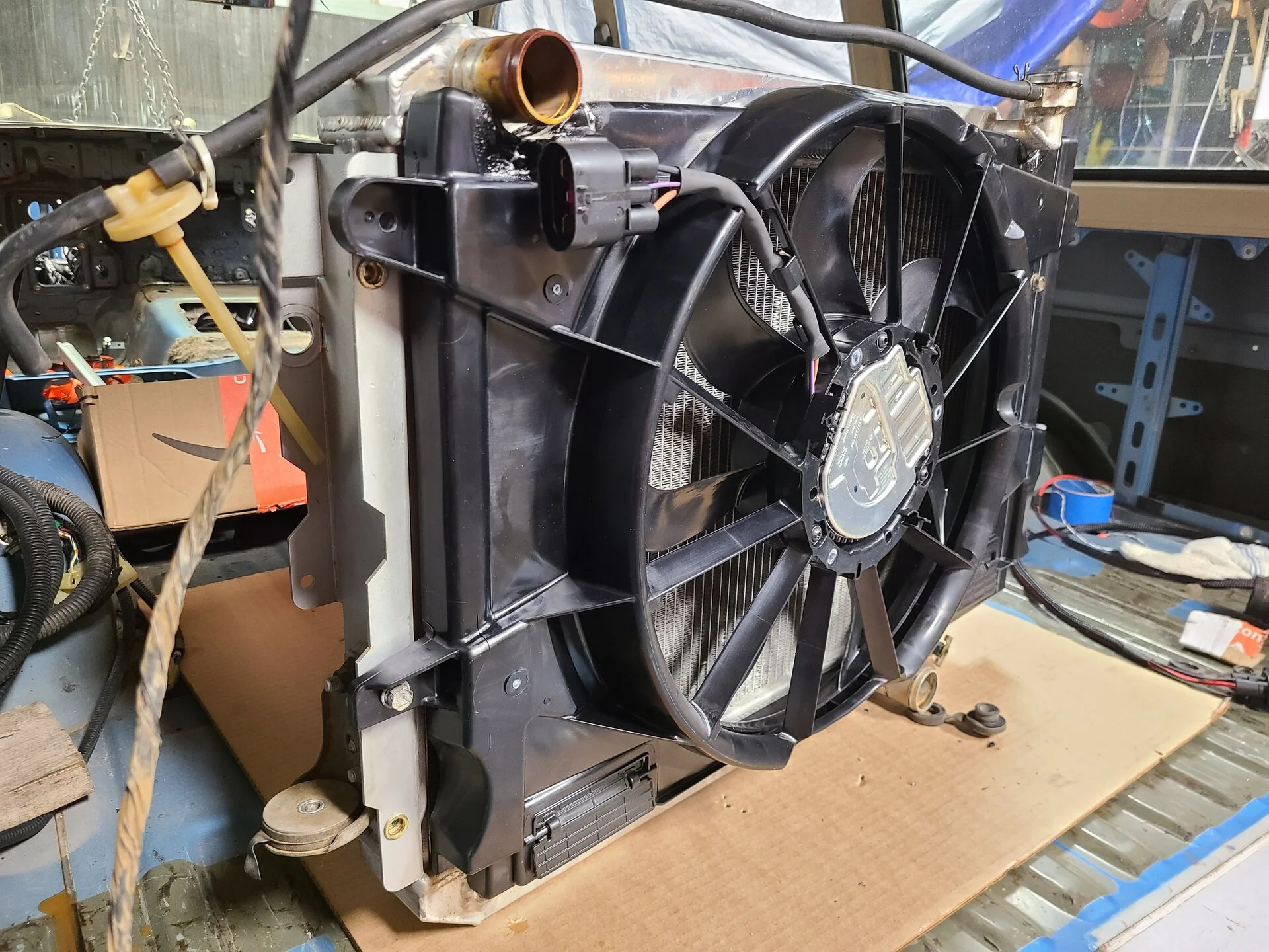

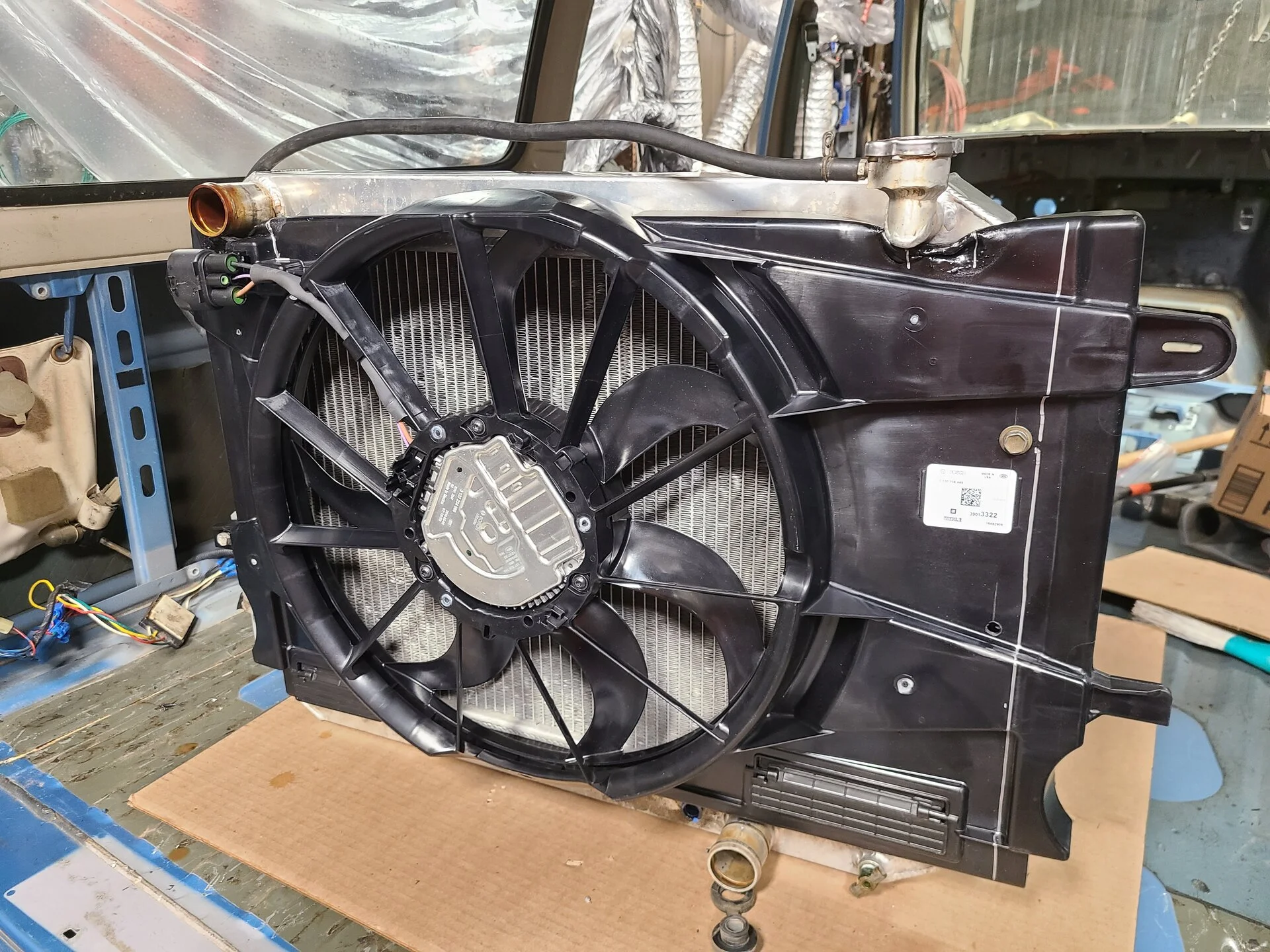

I'll throw this pic out for the group. May not apply 100% because of the FJ60 radiator but it's V8 related. And my chassis is an 80 🤪
GM PWM fan assy.
Right side needs trimmed, for my application, but you can make out the part # if you need one.
I'll throw this pic out for the group. May not apply 100% because of the FJ60 radiator but it's V8 related. And my chassis is an 80 🤪...

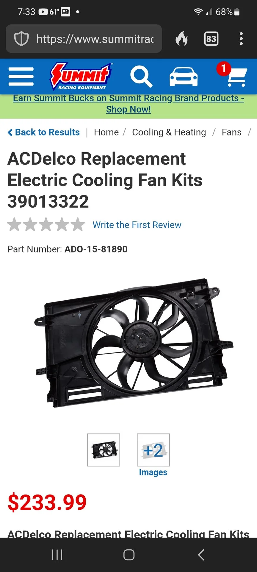

EDIT: NM Found it. 39013322 2017-2018 Chevy Cruze
Zooming in the part number is difficult to make out. Do you mind sharing the part number?
Also, how are you controlling the fan? The GM PCM or standalone?

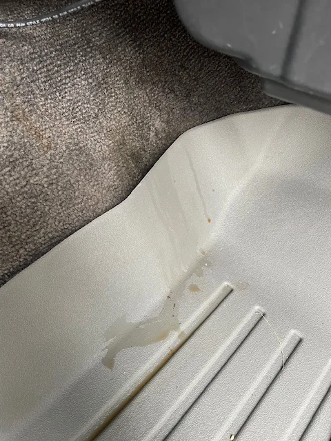

Only system not working is the ac. I’ve got it electronically working. Took it in to be serviced and won’t hold a vacuum. I asked them not to troubleshoot it. With it being a mutant I did t really want anyone digging in her. I’ll sort it out soon enough. Need to buy a little pressure pump or somtfrom harbor freight. Also. Defrost makes a pretty nice sauna in the car. It makes it worst than the fog! Got. Hester core leak. Probably swap it and the ac evaporator at the same time. Since I think you dang near need to take the dash apart.
