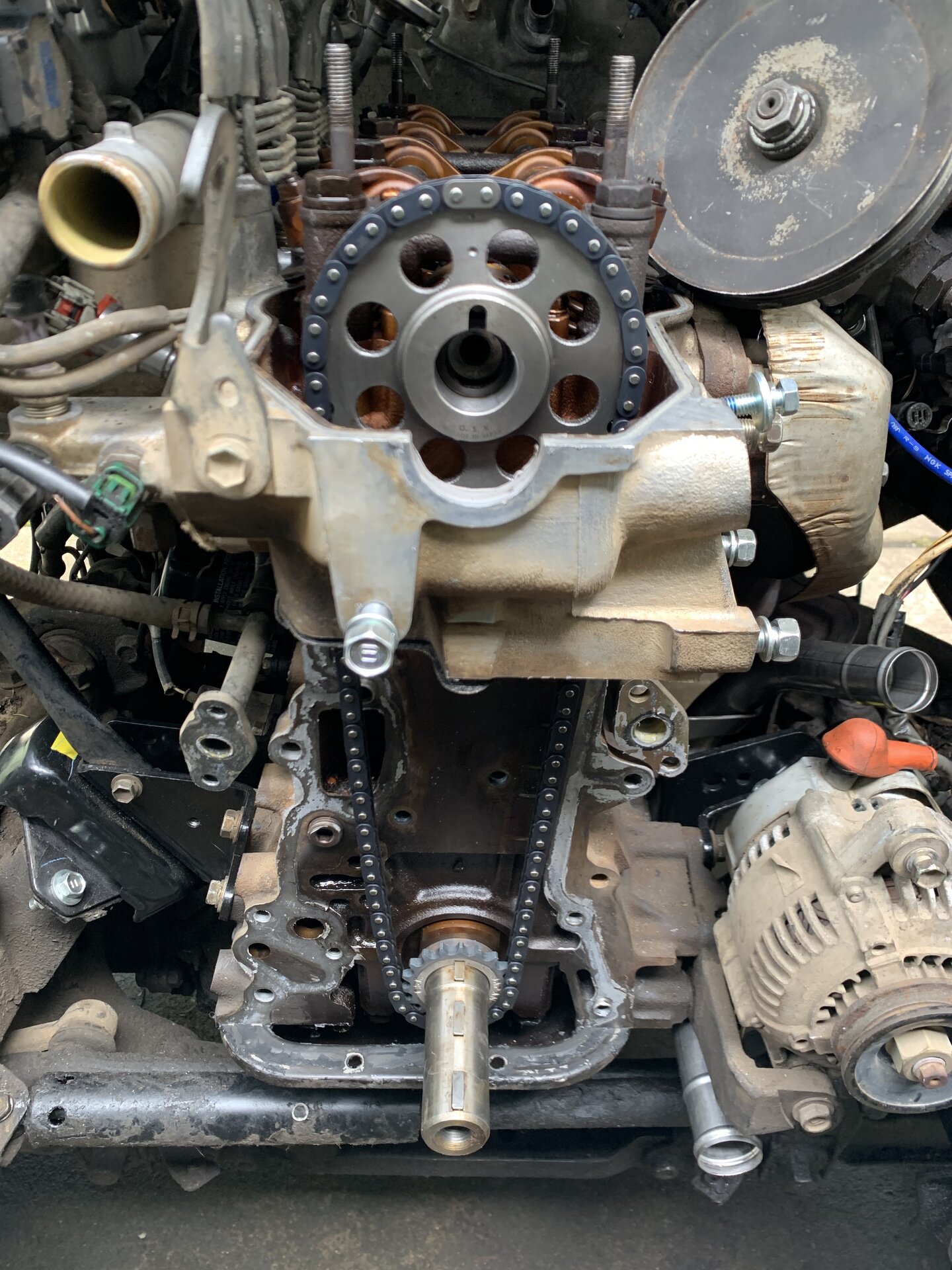

Unfortunately, I really did screw things up. Its surprising because I usually triple check everything, and had no probs when I did the timing on my 2UZ.
Anyway, got things taken apart and we’re looking much better now. Thankful these little motors are so easy to work on.

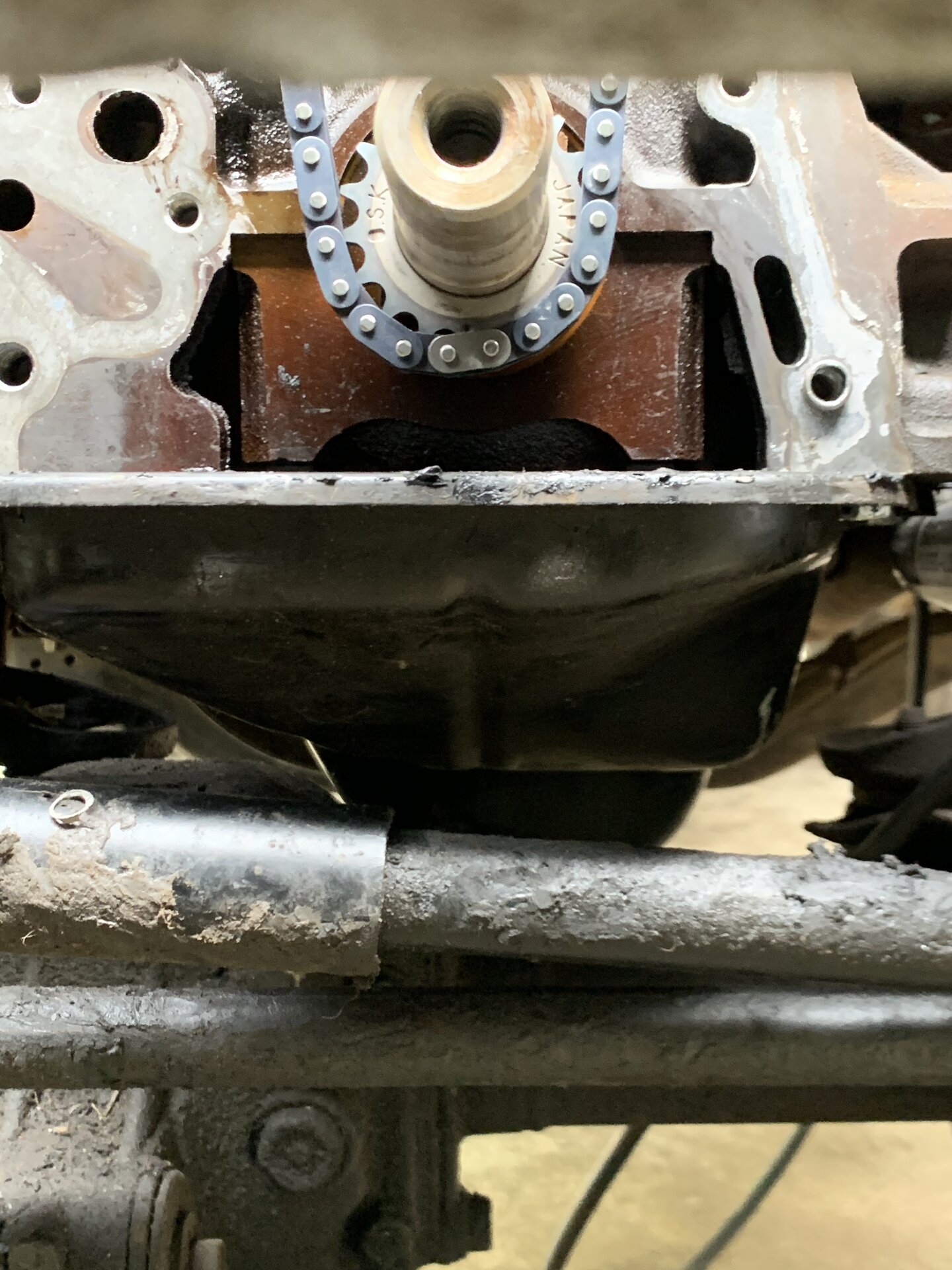

Welp. I think I screwed up with the timing chain install. I believe I lined up the link w the dimple on the cam gear and the crank key on the crank gear. I believe the dimple should have been down. At least from my photo
Will put the crank at tdc tomorrow and see where the cam gear is.
Back on track today.
If anyone reads this in the future has to redo timing leave the water pump installed on the cover.
Also if you are leaving the oil pan on, it would help to apply rtv between the head and the portion of the head gasket that goes between the head and timing cover. If you do it ahead of time, there less chance of mangling the head gasket when you install the cover.

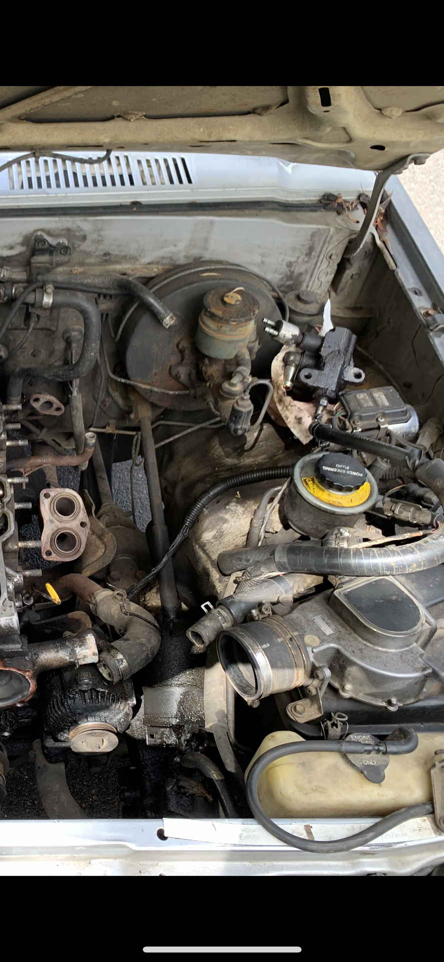

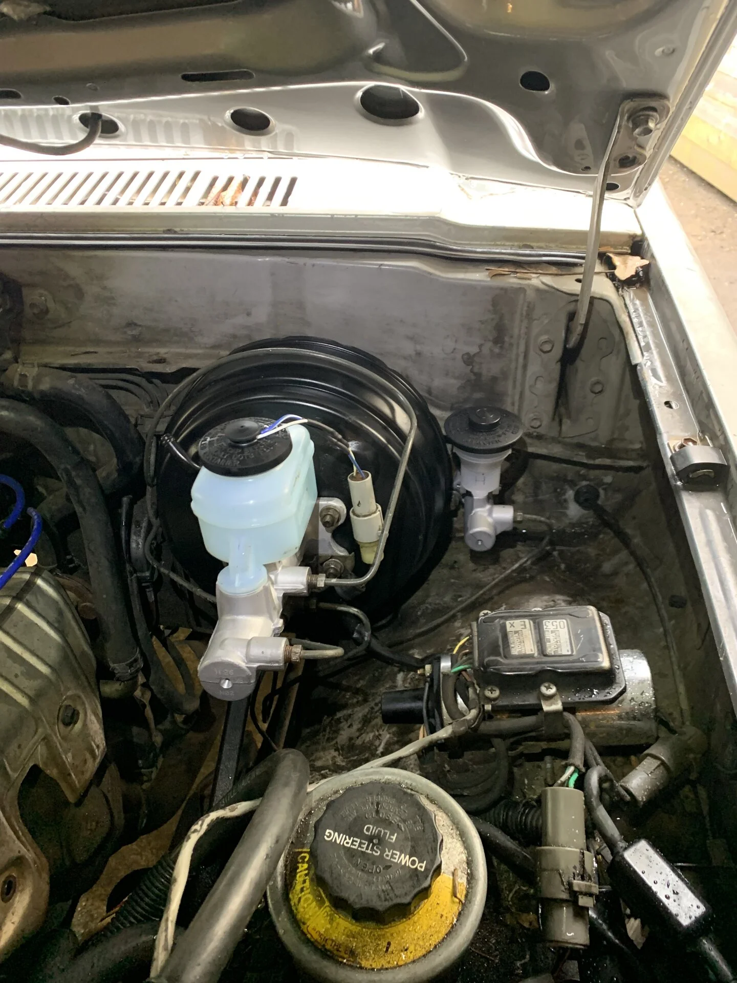

Threw in a used dual diaphragm booster and 1” master, and a new clutch master. Luckily didn’t need an extra spacer for steering shaft clearance.
Haven’t see anything about the connector compatability, but I soldered the one from the old reservoir onto the new one.
So far I fixed an exhaust leak, replaced coolant temp sensor, swapped iacv, plugged egr vacuum port, messed w timing a lot, adjusted tps (think I did it correctly) may get the allen bolts to adjust while the truck is running.
Theres been a big improvement, but really want a smooth idle.
I think the warm idle issue may be attributed to not having the idle up valve and VSV installed. I’ll get around to it eventually. Swapped in a new ngk coil and its not smelling so rich when I drive it.
