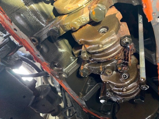

Got around to pulling the oil pan today. I used the video @HawkDriver posted on the ifs oil pan removal. I didn't have a crane, but a length of 4x4 and a floor jack allowed me enough clearance. I got some photos of the bottom end. I don't like the looks of it, but is it salvageable?
This engine have a blown head gasket? That water is coming from somewhere and I'm hoping not a cracked block.
Thats what the p/o said, but I couldnt see where the hg had failed. If anything it seemed like it had been installed incorrectly bc there was water in all 4 cylinders. Maybe the head wasnt resurfaced or the hg itself wasnt put in correctly. I guess the block could be cracked, there was water when I drained the oil but it wasnt a huge amount.
Take a look at the timing cover. If the timing chain rubbed against it, it will wear through at a coolant passage causing coolant in the oil. I’ve seen this numerous times where the customer thought they had a blown head gasket.
^^^^^^^^^ This. Glad you thought of it cuz I sure didn't.
It sure is the frequent cause of coolant in the oil, but it wouldn't cause that rust streak down the main web. That is the part that concerns me the most.
Timing cover looks good. Welp, do I start my search for a motor?
Depends on what you want to deal with. See if you can find an engine shop in your area who can pressure test the block? If the block is cracked then you may as well go looking for another engine, but if it passes the pressure test then it could be the head gasket or the head (have it inspected and/or pressure tested at the same time).
Luckily, have 2 heads for the truck. Im just questioning the chances of the bearings having good life in them.
I talked to a few engine shops in the area. The pressure test requires me pulling the block out, and taking it down to be tested. While the block is out it would probably be best to rebuild with how many miles are on the truck. I think at this point I am going to start searching for a motor.
