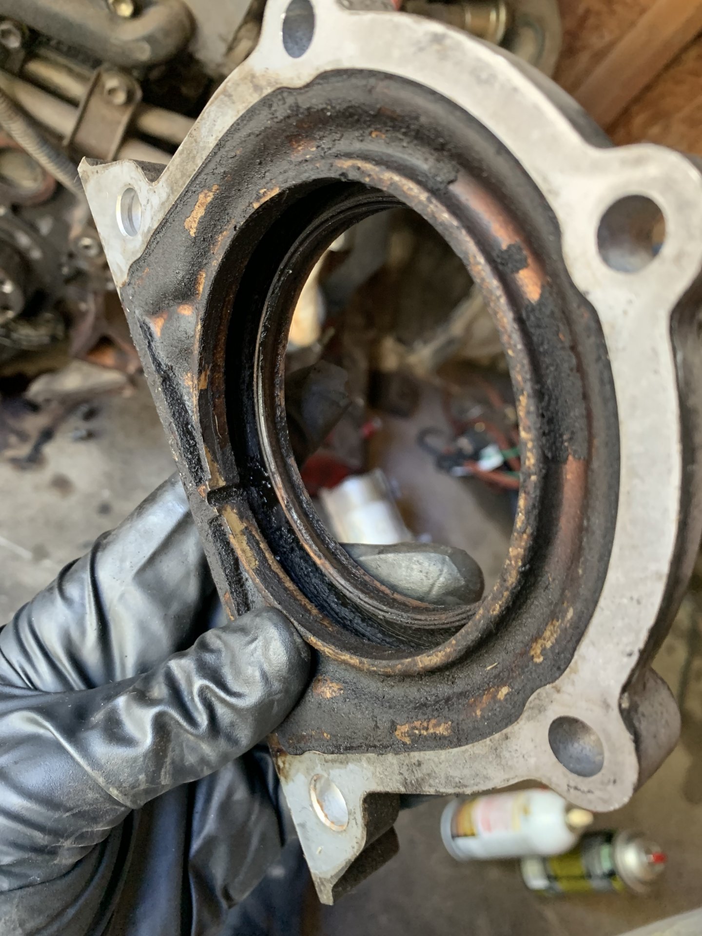

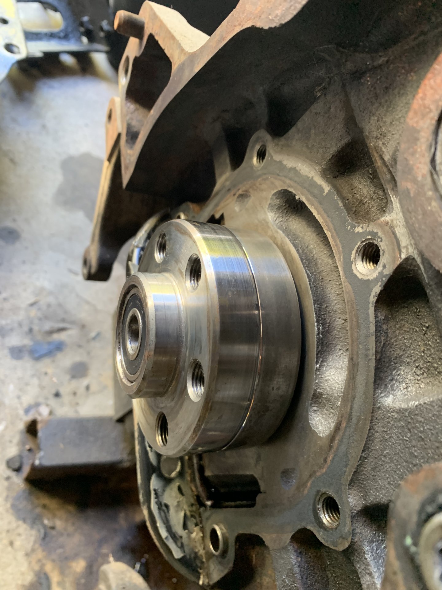

I used some throttle bottle cleaner and a brush to clean the sealing surface on the crank. I didnt get a before pic, but it looked even worse than the seal.View attachment 3005555View attachment 3005556

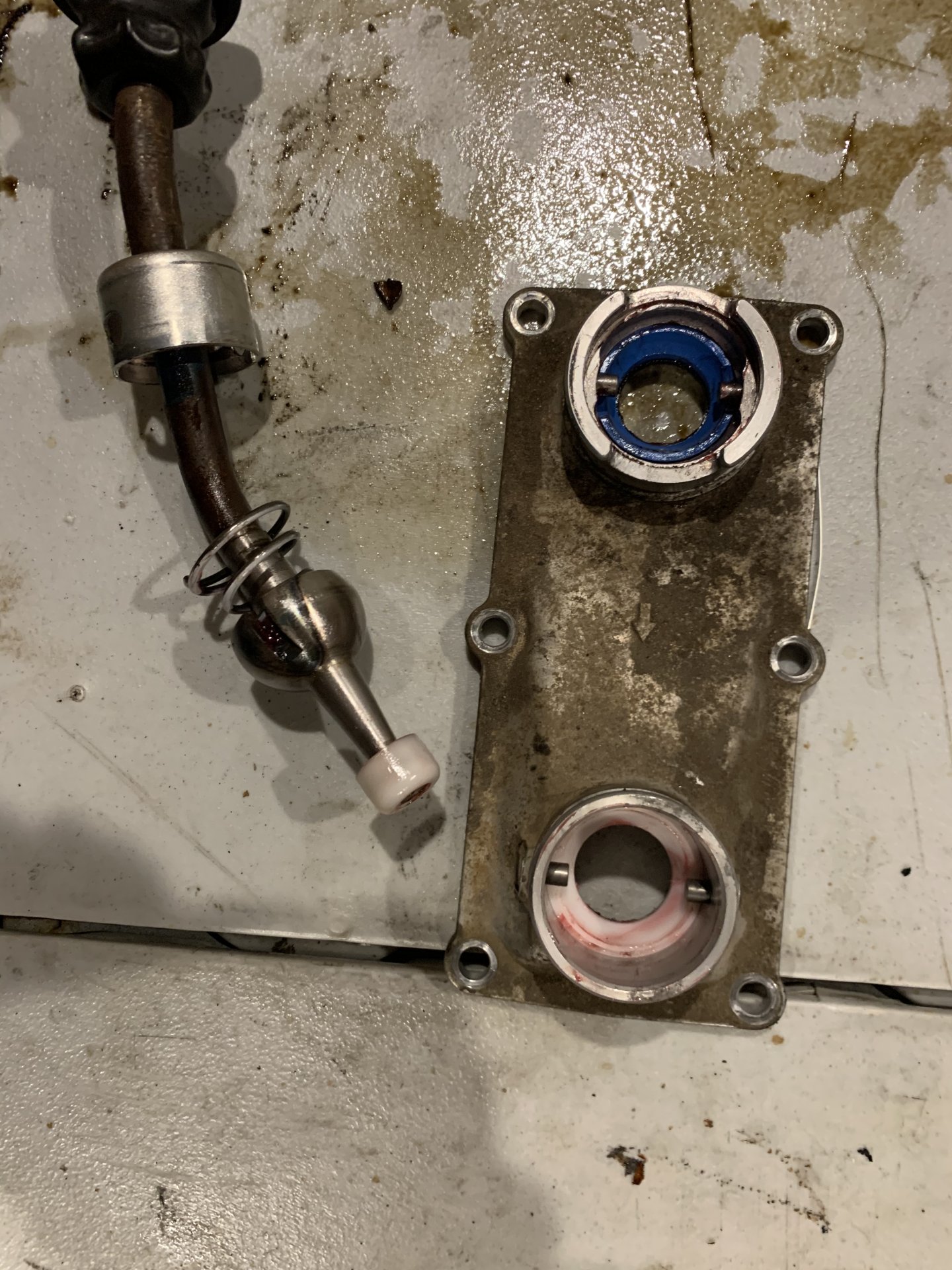

Going to replace the gasket here:
Front seal is dry, but should I change it anyway?
Looking at fluids, leaning towards redline mt and GL5 75w90.
You are in there. Replace the seal.
If the trans is not a W or an R series then a quality synthetic lube is a very good idea. If it is a W or an R synthetic is still a good idea, but not as necessary. I ran Torco in a G series for 50k and then replaced that with Redline as part of it's servicing. Sold the truck with over 50k on the Redline.
Threw the Marlin HD combo in last night. Feels pretty good, but I think I need to go back in and make sure the seats didn’t rotate when I was reinstalling the shifters.

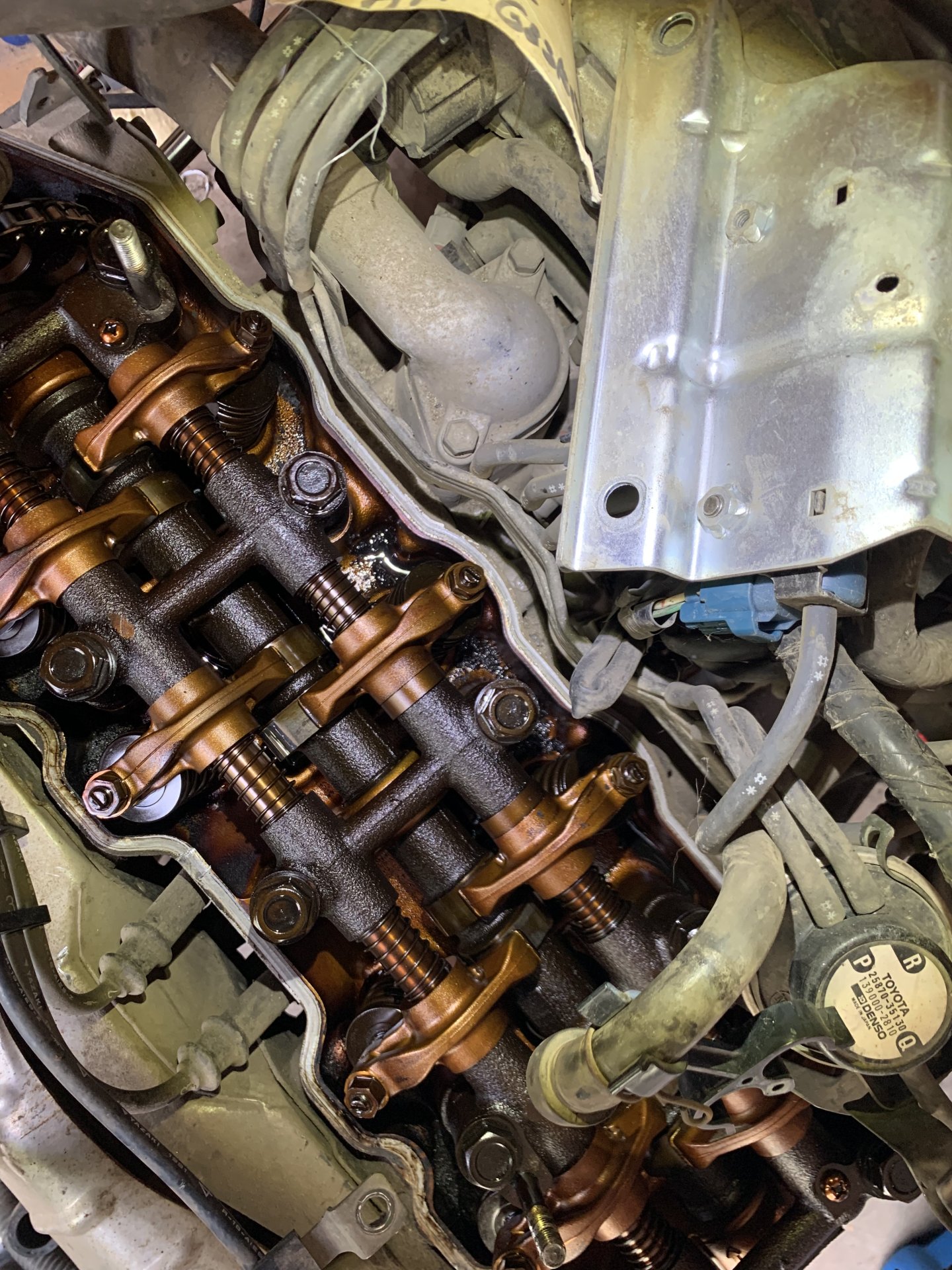

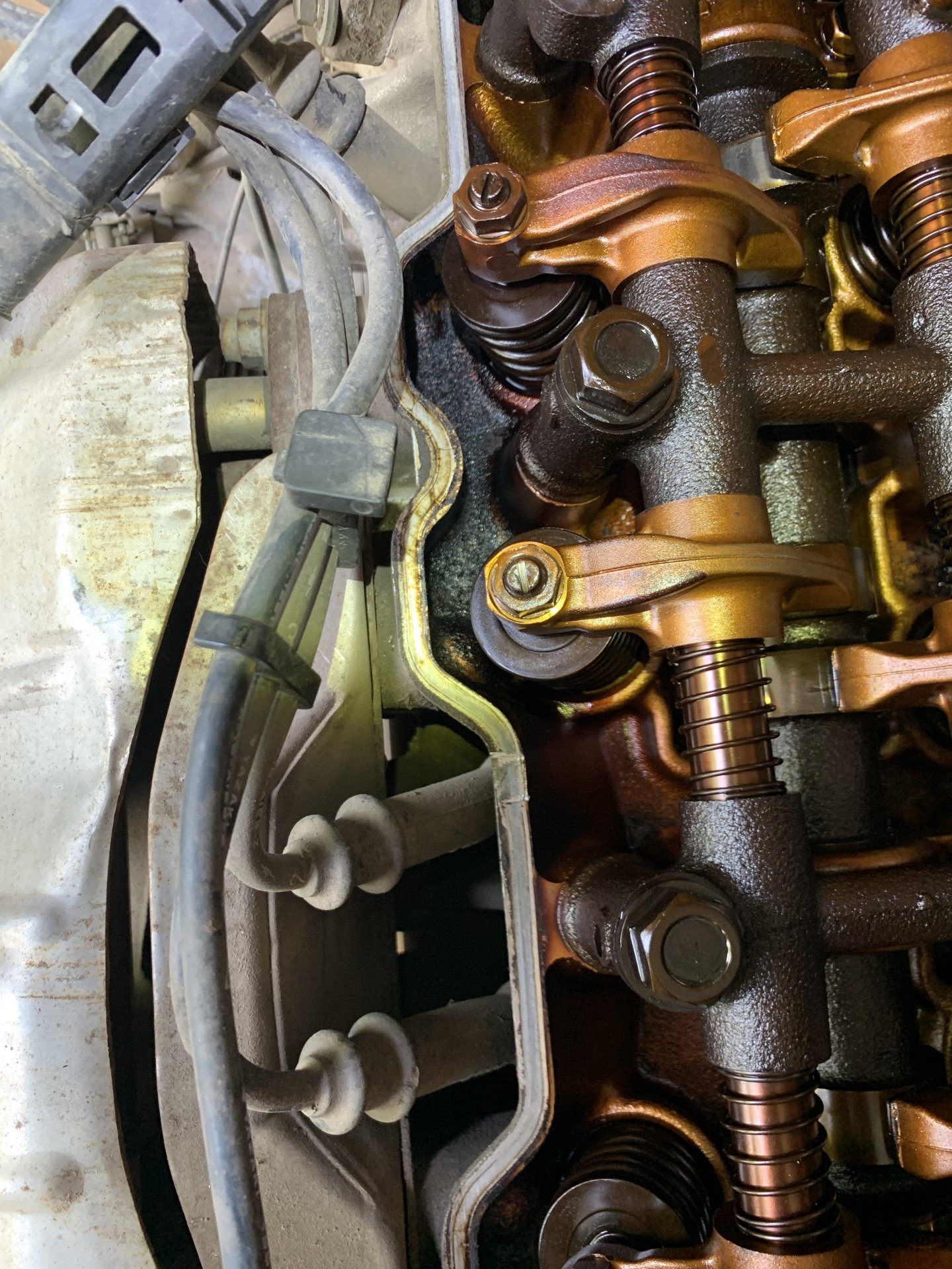

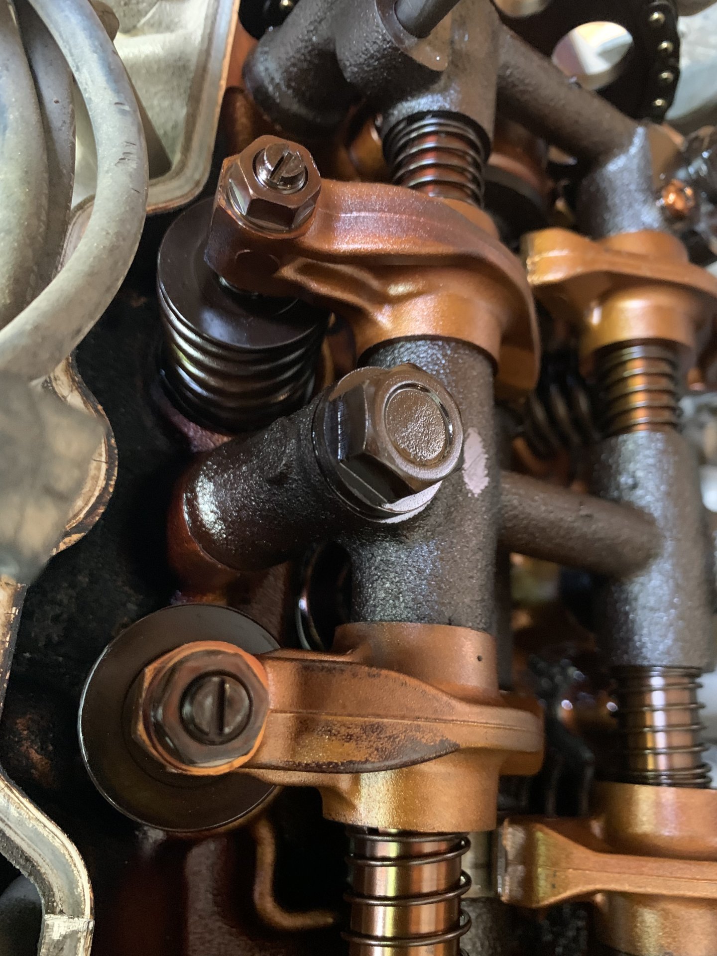

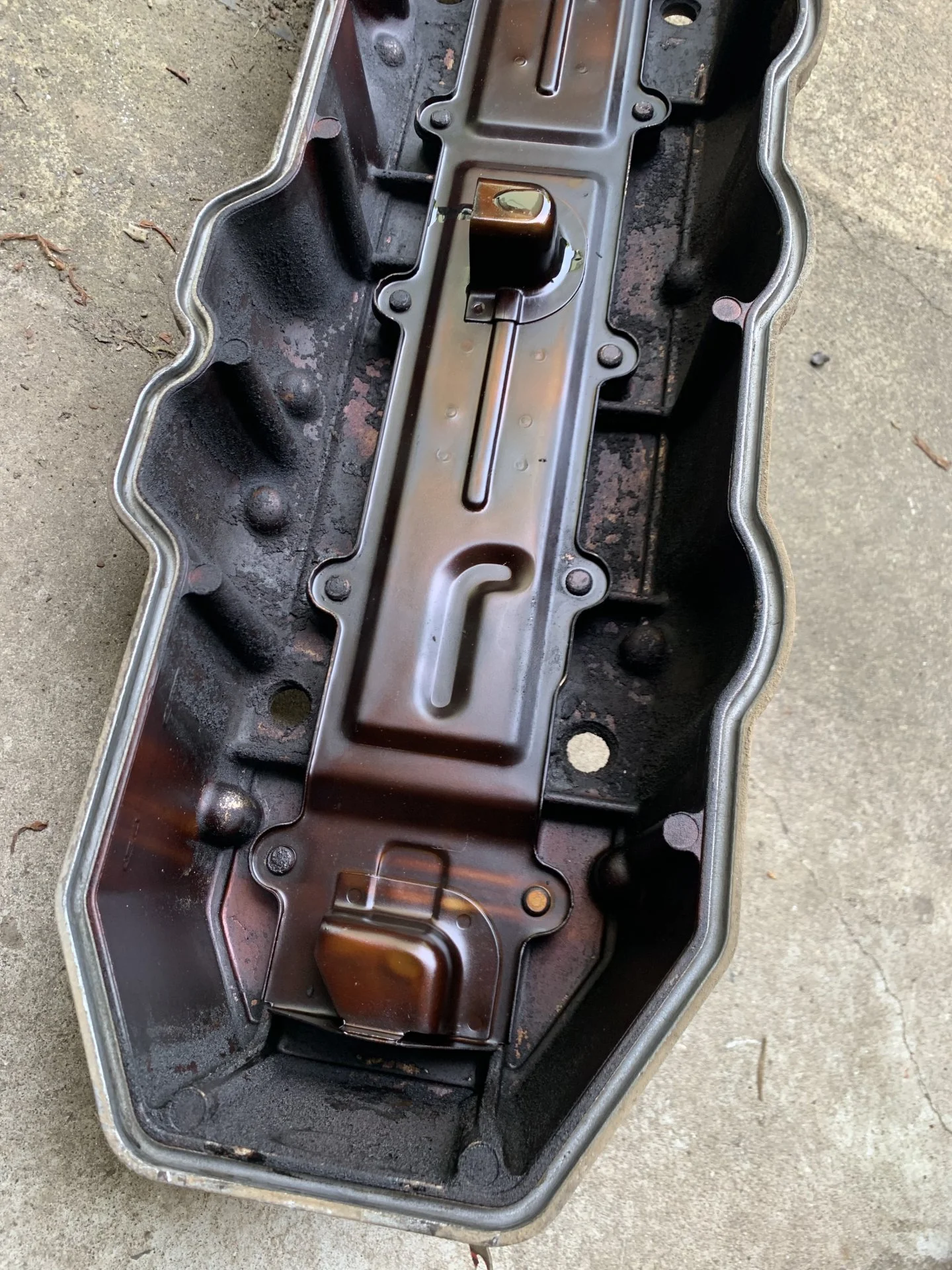

Was able to get the valve cover off motor #2 today. It does seem sooty/sludgy like the rear main cap.
Hopefully nothing too major, would appreciate any input from the community.
Could be worse, I've seen it. Going to guess the PO used a high paraffins oil like Pennzoil in it. How many miles are reportedly on it?
Either button it back up untouched, or tear it down and thoroughly clean it. Half measures are sure to bite you.
Dude, that's nothing. I would put it back together and run some quality oil through it. I would suggest syn, but it might make the seals start leaking.
Okay, thanks. 130k reported miles.
Great, thats reassuring.

There's nothing wrong with the build up on that engine. Looks like it ran a light duty/grocery getter life. Open up most any 20 yr old engine and be prepared to see this stuff. Totally common, as this is the duty cycle that the broad majority of passenger vehicles see. Run a good quality oil and filter, let it see some highway runs for 30+ minutes, and carry on. Maybe change the oil early the first couple times if that makes you feel better.
Install the rear main just a bit off that groove, replace the clutch, set the valves, replace the VC gasket and go. Enjoy the truck. Looks like a good grab.

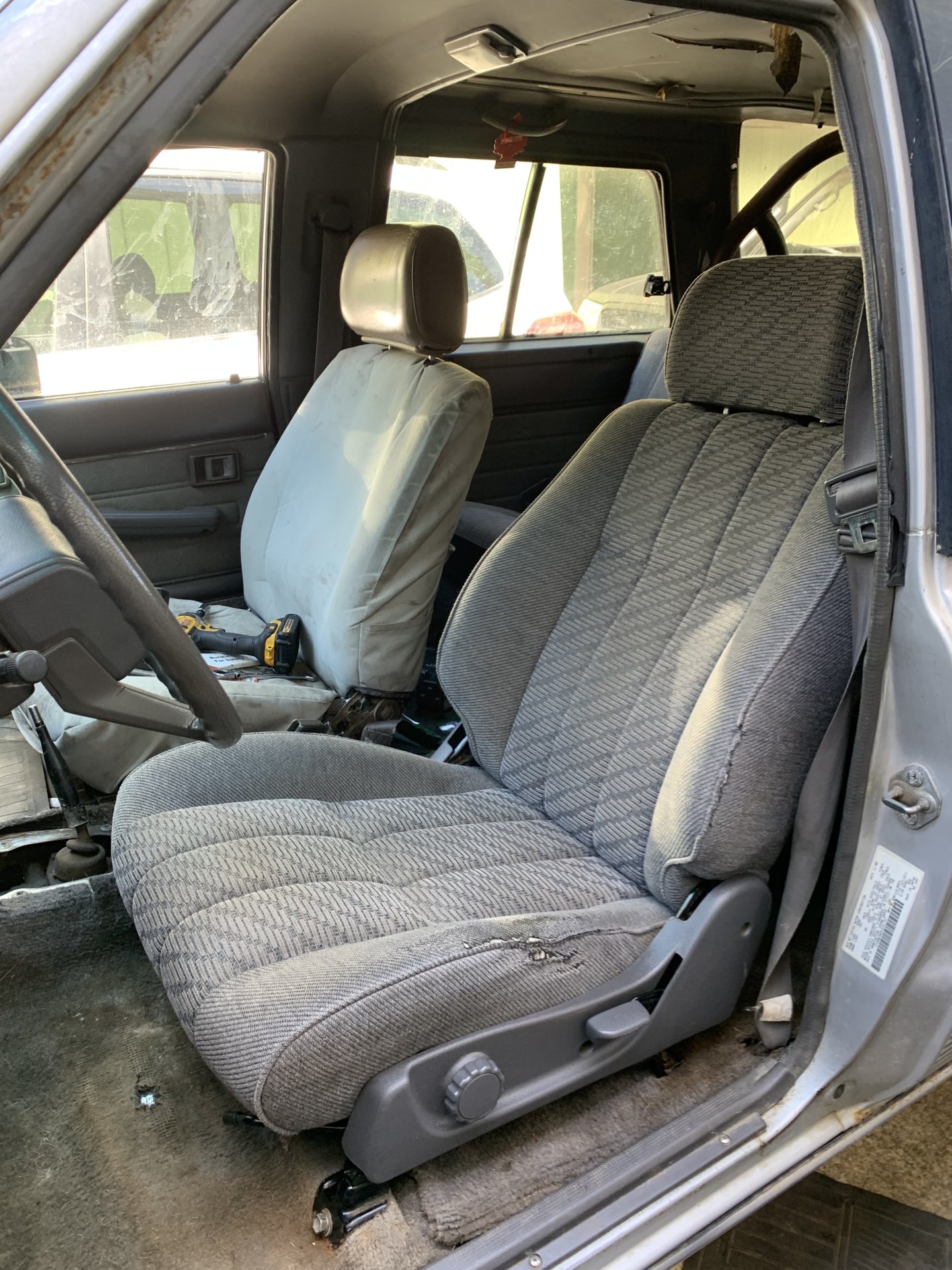

Got a 89-95 driver seat in today. Also found a box of 9mm left in the truck, pretty happy w that. Hopefully this week I can get the flywheel and clutch on and get the trans apart.
