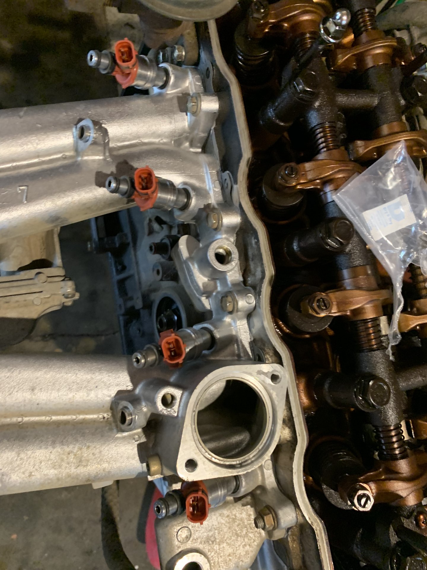

In what I’ve read so far, I’m going to move all of the sensors and harness from the old motor to the new, as well as swap injectors.
I thought it would be plug and play but the body harness from the 4runner isn’t compatible w the harness on the motor. Still trying to figure out if the difference is due to the year or bc its a 4runner vs pickup.

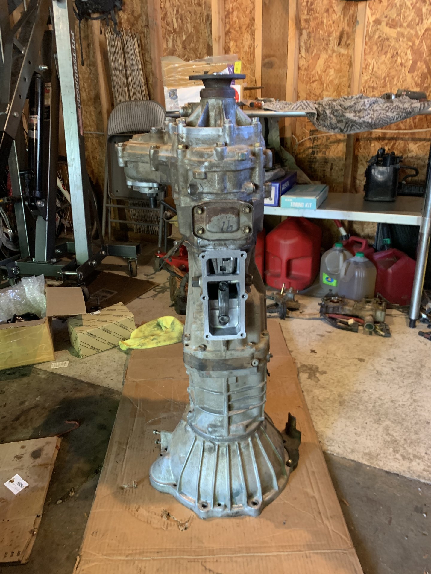

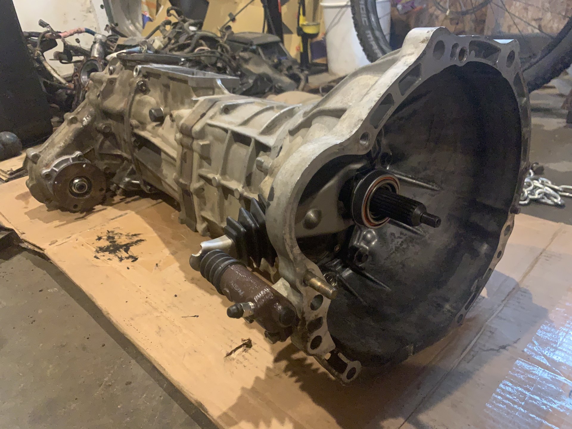

Got to do the front seal and bearing retainer plate on the front of the trans today.
Before:
Pretty happy with the outcome. There was a gasket installed by someone, but I reassembled w FIPG 103. Got the T case input shaft seal done as well. Waiting on PTFE thread sealant to put them back together.
I think I am going to go ahead and do all the gaskets on the t case while I have it out. I'll work on the harness swap and getting the old tranny out while I wait on the gaskets.

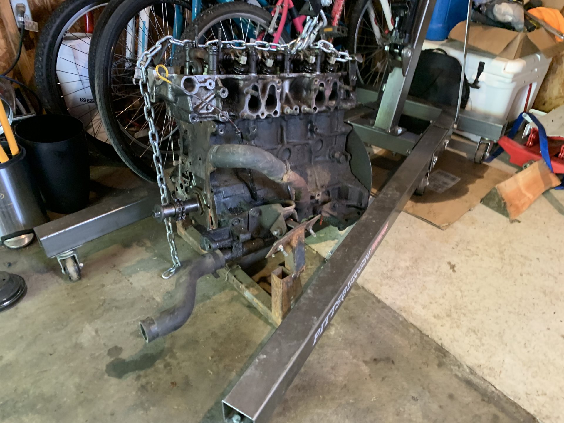

Today was able to make some progress after spending the last few weeks collecting parts. Intake and valve cover are at a metal cleaner nearby.
Crank bolt come off pretty easy.

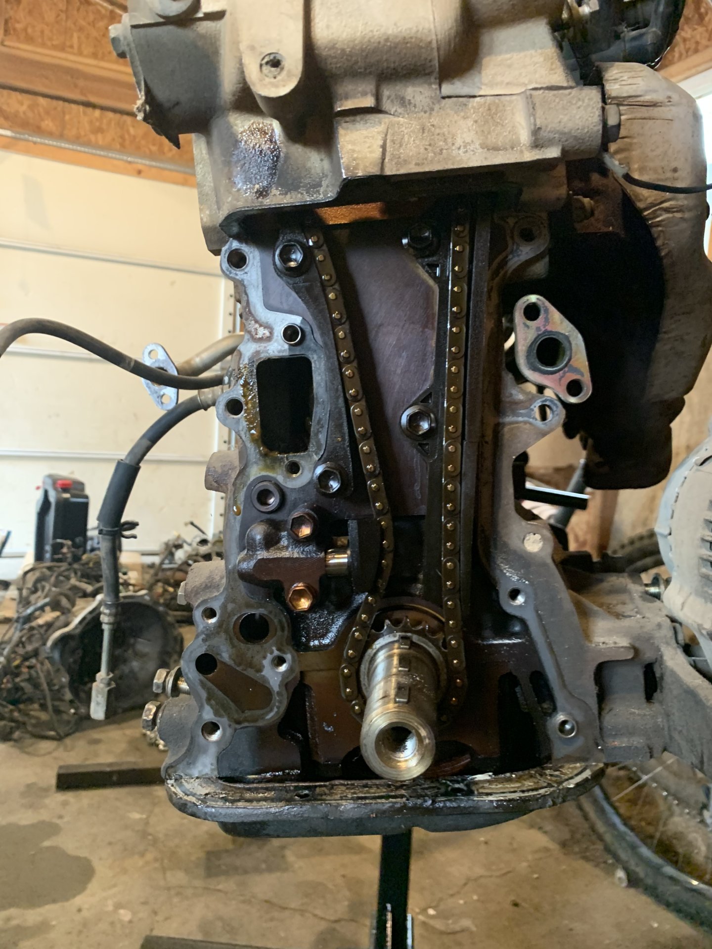

Motor still had original plastic guides, some parts of which are in the oil pan. The straight guide was broken in the middle and around the top bolt.
Also pulled the oil pan to re-do the fipg.
Installed oem chain and tensioner, OSK timing gears, and LC Engineering guides that came w the truck.

Welp. I think I screwed up with the timing chain install. I believe I lined up the link w the dimple on the cam gear and the crank key on the crank gear. I believe the dimple should have been down. At least from my photo
Will put the crank at tdc tomorrow and see where the cam gear is.
