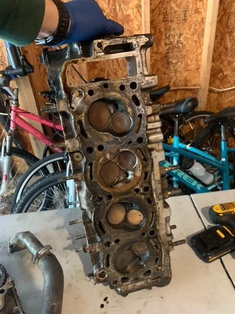

I have had some interest in the truck @ $3500. It would be cool to do a quick flip for 75% profit, but I think right now I want to get it running and enjoy it a bit before deciding whether I want to keep it or flip it. Today I pulled the head, and will take it in to the shop along w the spare and see which they think I should mount back up, and have them resurfaced.

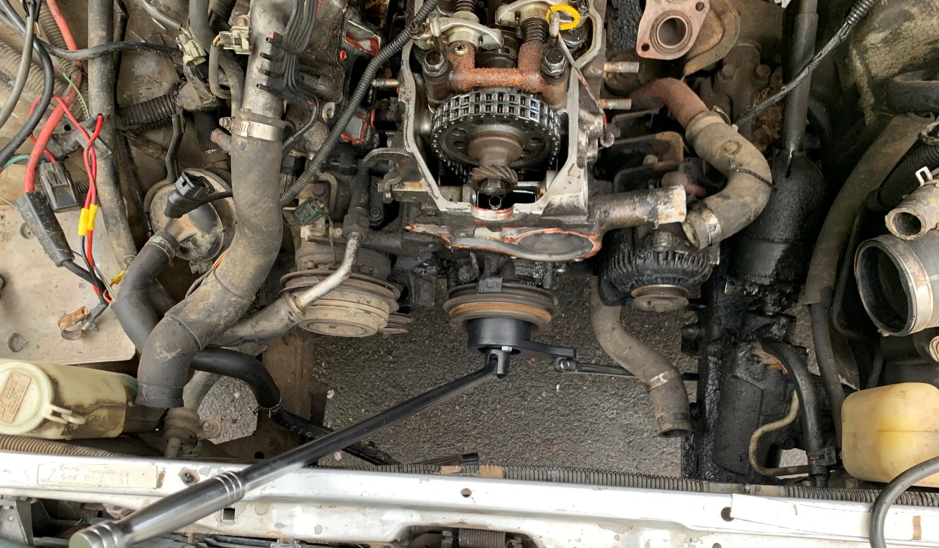

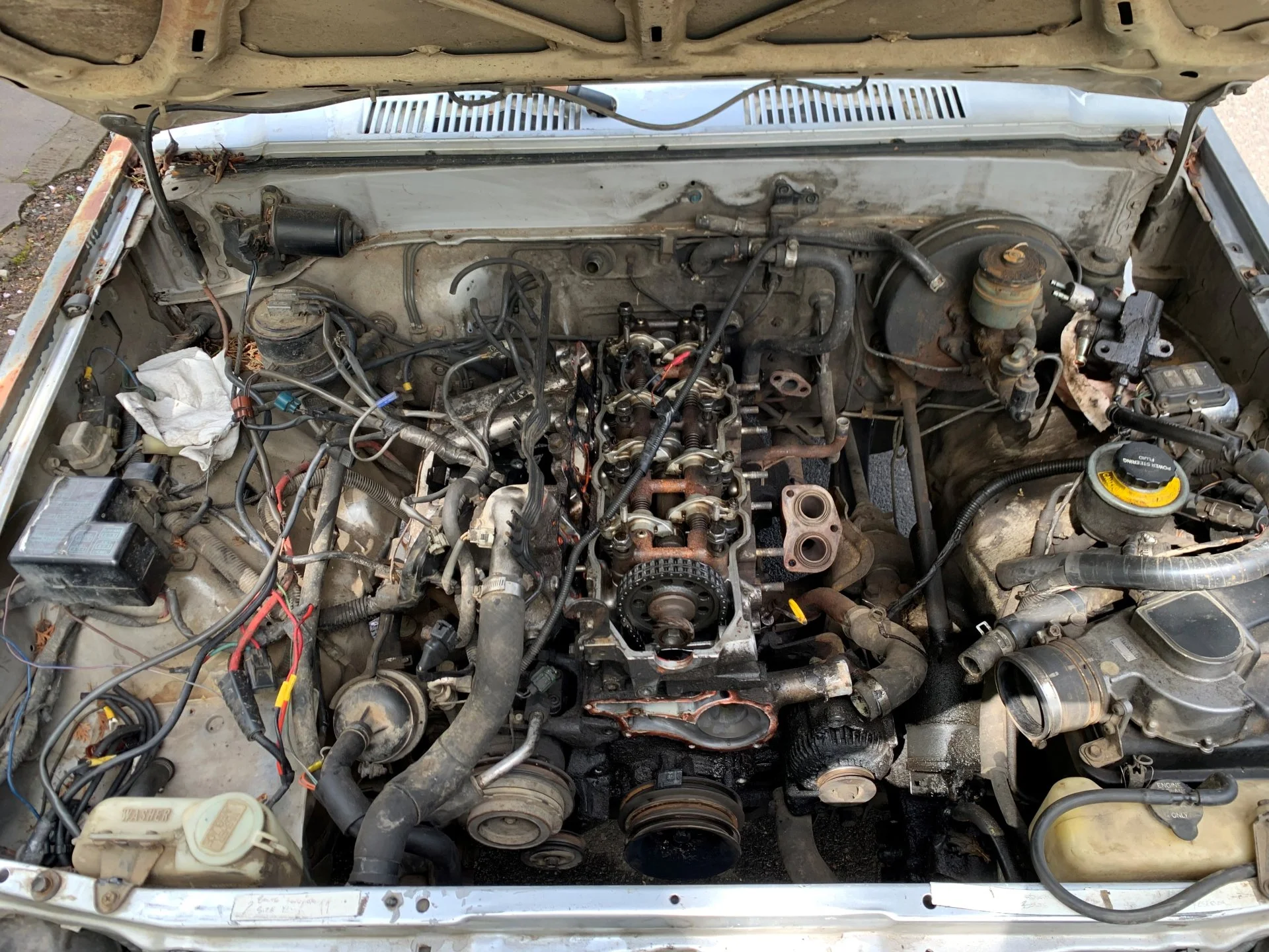

This is how the engine bay looked upon purchase. Already had the dual timing chain. P/o gave me a single kit, which I will install. The alternator and whole left side of the engine/bay and frame rail are caked w oil and grime.

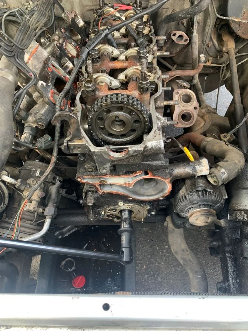

This is how I was able to break the crank bolt loose. Luckily I purchased a crank pulley holder tool for my 100 last year, so I pulled the front part of the crank pulley (4bolts), mounted it and put an 18" breaker bar on it under the driver frame rail. Then I used my 24" breaker on the actual bolt, put a foot on the bull bar and gave it hell and it finally broke loose. It was a SOB for sure, but I'm surprised the p/o sold bc of that.

Looks like a dual chain upgrade.
What's it look like behind the timing cover?
Yeah I noticed that when I looked at the new kit, the new kit is not dual, but I will install it anyway. Going to replace the timing cover while Im in there. Looks decent in
timing case, messy rtv job though.
I guess the breaker bar - starter motor trick isn't as well known as I thought it was. Not that it does you any good now, but disconnect the dist. from the ignitor so it won't start, socket on the crank bolt with the breaker bar laying on the left frame rail. Give it a quick crank with the starter. I've used this trick maybe 1/2 dozen times and it works every time.
You, and a half million other folks.
I wanted to try the starter trick, but the battery in the truck is dead and it seemed a little easier to mount the pulley holder tool than to put the battery in and jump it. Plus I think bc the ad said the crank bolt was stuck I felt like muscling it off 😅

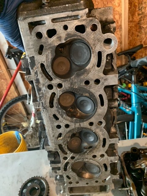

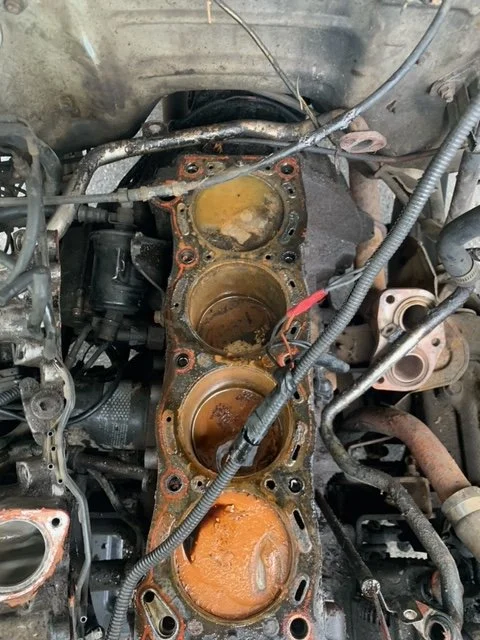

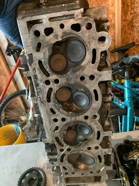

After getting the timing cover off, everything came apart very easily. The spare head looks a lot better than the one that came out of the truck. If anyone has any tips for getting the block and cylinders nice and clean I would really appreciate them. Right now Im thinking of pressure washer and compressed air and then polishing it all up.

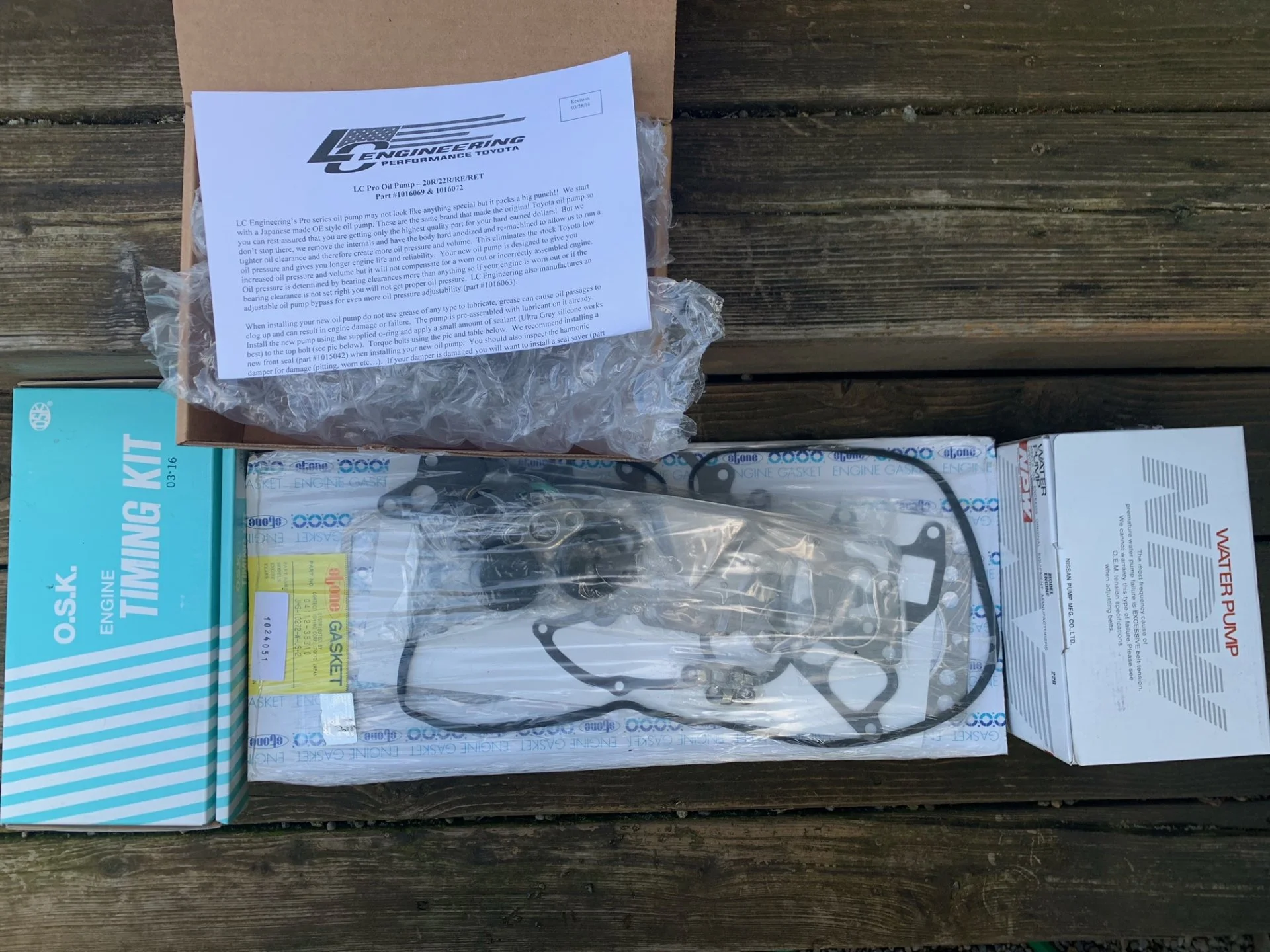

P/o Supplied me with a Nissan Water pump, OSK single row timing kit, LC Engineering Oil Pump, and Stone gasket set. Should I shelf any of these in favor of OE or another manufacturer? I'm particularly concerned with the head gasket itself.

I've had three FelPro head gaskets fail on me (I didn't install any of them). I only run OEM head gaskets. The only other part I'm going to suggest OEM is the timing chain. You might be OK with the gears. I had an aftermarket chain (installed by a reputable individual, again not me) break on the way to Baja, in a raging blizzard. It was a bummer having to abandon my truck in Flagstaff while I jumped into a buddy's truck and continue.
As far as oil and water pump, I only run OEM, or AISIN aftermarket (same thing).
Okay, thanks for the heads up. Is there a website you like? I have the oil/water pumps, timing chain and tensioner, head gasket all oem priced @ $325 shipped from partsouq.com
I've been getting stuff lately at Claremont Toyota in Claremont, CA. Discount has been around 30%, with free shipping on orders over $75. There are several discount dealers now offering free shipping. For AISIN aftermarket I use Rockauto.com, and the MUD discount.
