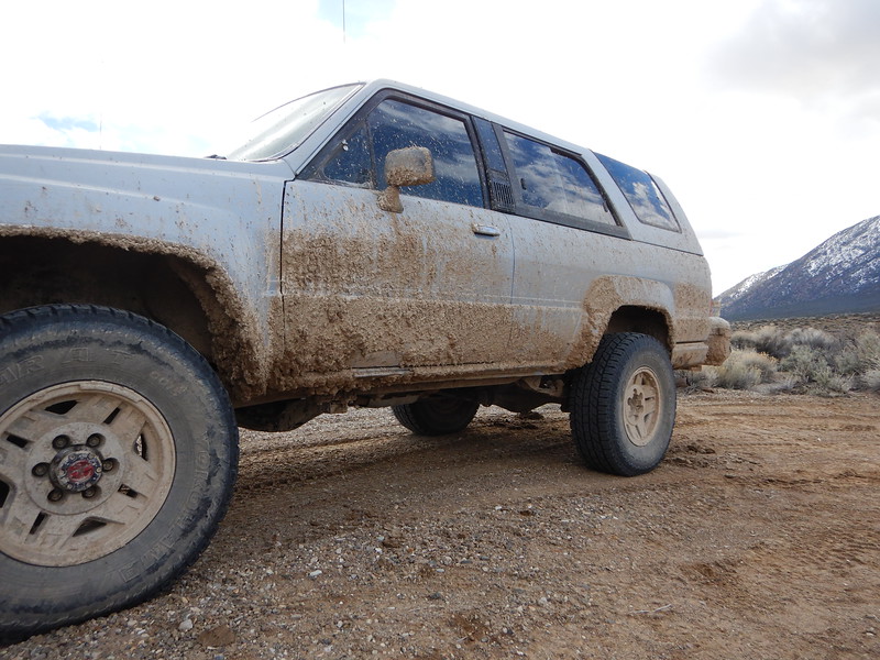

Just spent a week driving Basin & Range in NV and this was the result:
Rear springs worked well, but now that it is unloaded it is 'stinkbug' as I thought it would be. I guess I should just keep it loaded for trips?
