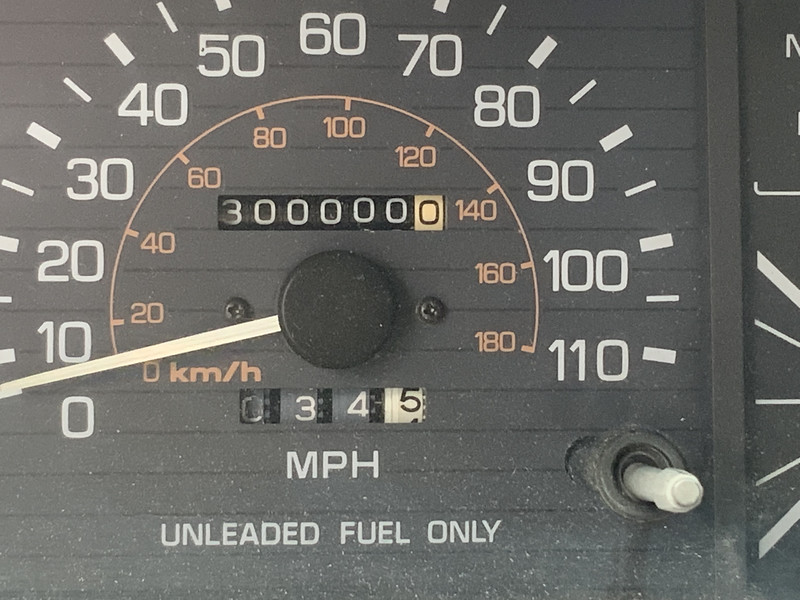

This happened today while out at lunch.

If not yotashop.com, recommended vendor(s) for injectors? With 300k on the clock this whole set of injectors doesn't owe me anything. Might be best to just replace them all rather than have them die one at a time.
