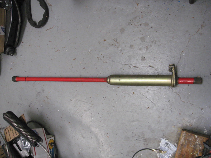

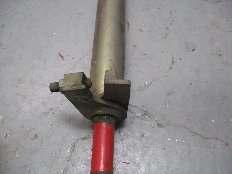

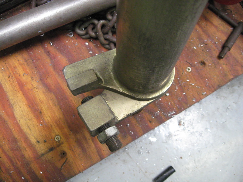

A friend gave me a set of barely used SAW IFS torsion bars. They measure 23mm, or about .5mm larger than what I measure my assumed to be OEM bars to be, but that's not the interesting part. The interesting part is these are the apparently fairly rare 2 stage torsions that SAW made for the IFS trucks back in the day. At an adjustable point in the suspension's compression a tab contacts an adjuster screw and at the point it effectively reduces the length of the t-bar by about 1/3. From that point the rest of the compression travel will be at a significantly higher spring rate.
Working on that. In the mean time I'll try to describe them in text. The anchor splines at the rear of the t-bars are longer than stock and a female splined collar with the 'stop' tab welded to it rides on them. There is a third set of splines on the bar about 1/3 forward from the anchor splines. A female splined collar fits on those, and it is welded into a short tube. The rear of the tube pilots on the stop tab splined collar's OD and has a tab welded onto it with the adjuster screw in it.
The full length of the bar twist per normal until the adjuster screw contacts the stop tab. At that point the portion of the bar under the tube no longer can twist, making the bar much shorter. Shorter torsion bar of the same OD will have a higher spring rate.
I think the stock bars are either too stiff or the RS5000's are too stiff. Whatever the cause, the front doesn't like to move much. I'm not sure that I want these t-bars, but I'm going to try them out after I get the 7100's installed. Could be that I can use them very much like a hydro-bump in that they come in very late in the compression travel and only serve to dramatically slow the suspension right before hitting the travel limiters.
