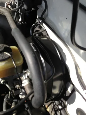

Swapped Booster
Will have another Classifieds Ad to sell the previous, because there's no change in brakes after swap.
Imagine my surprise when the first intersection I hit, the RPMs spiked to 1500. Forgot to nest the throttle cable back in the hangers, appears.
Replaced O rings on bypass tube.

Any clues why the brake pedal feel has deteriorated into spongeville?
I'd bet I've bled 10-12 quarts through system in the last year, following FSM procedure, but if any improvement it may have only been perceived.
New calipers, rotors, pads, booster, brake lines and LSPV, still sponge.
What have I overlooked?
Did you bleed the master cylinder while on the bench? Or you can bleed it while on the truck, you'll have to crack the brake fittings at the master cylinder while someone operates the brake pedal.
Bench bled the master when installing calipers, LSPV, and brake lines last year. Should've pulled it off when swapping booster, but figured the booster was the problem.
Going to re-bleed it installed, though, and bleed the rest of the system again, guess after smashing the pedal to the floor on some gravel roads ( read that bubbles can trap and activating ABS can release? ).
I'd go for fluid now, but don't have a pedal pusher available.
