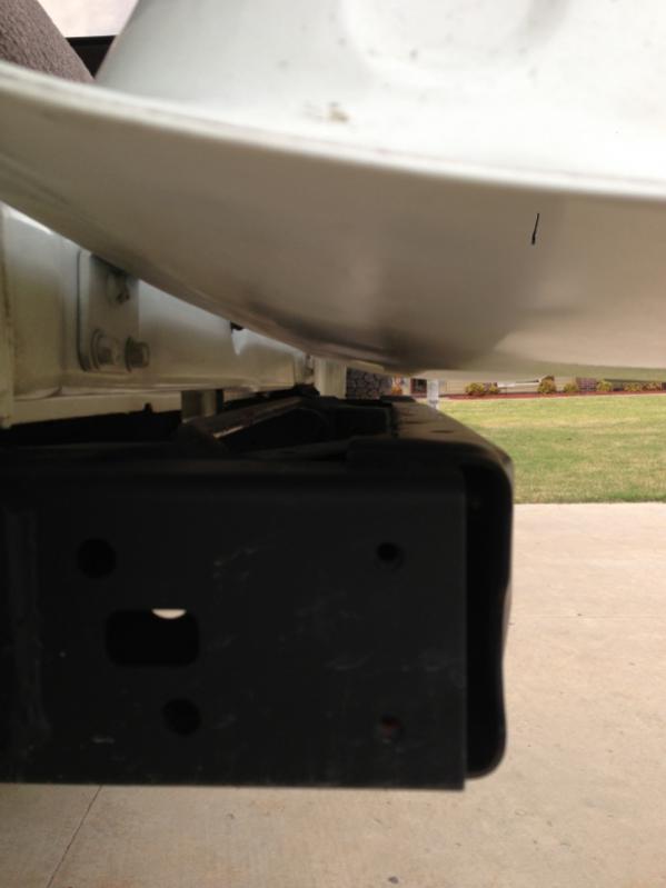

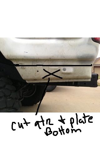

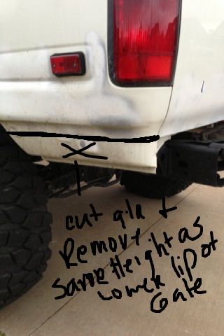

Here are a few pics of mine when I trimmed the rear quarter. I didn't cut as high as you have sketched, so when I plated the bottom, it flushed out with the area where the body mounts attach. Your plating might get a little more involved if you cut as high as you plan. Looking forward to the finished product.
Going to revisit yours.
Pics saved and template to follow. Will be sure to properly credit. Haha.
I've purposely not pulled the interior panels to see what all is involved, but in all honesty, the reason to that line was aesthetics, since it follows the bottom of the tailgate.
Will take heed of warning, and adjust.

Liking you're line better, after looking at it, but think I'm gonna try to fab a body mount that'll allow the taper at a slower angle than you chopped yours, and leave ~ 2 1/2" of meat of the frame rails.
No real reason why, but why ask why, right?
Think it's time to start cutting into the quarters and thinking I'll go ahead and do the front and rear fenders, while I'm in there.
Can always put four coats of liner on to conceal my chitty sheet metal welds.

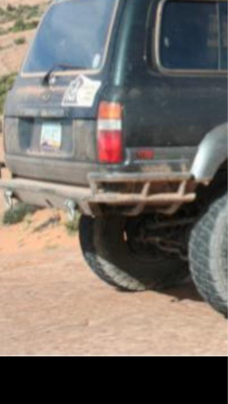

Pretty dang close to the eight thousand words describing and what I was trying to draw.
Though he edited :flipoff2: , Gumby lumping both of our substandard "levels of reading comprehension" and "inability to understand the simplest of concepts" while, possibly true for me, are misplaced for yours, since you comprehended my writing fairly accurately, which is rare.

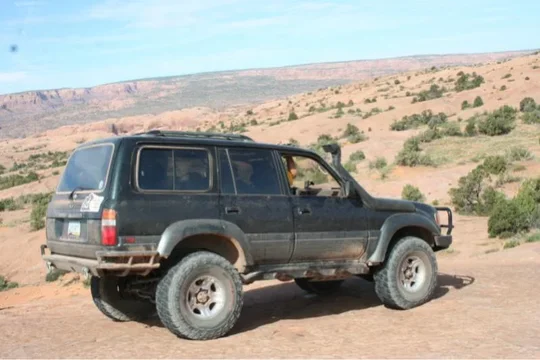

Great pic of Tool's that's 89% there, in all honesty.
In adapting what I'm looking for to similar, would like the front upright to roll with well, since I don't have flares, and the quarter protection to be higher....I think.
Rear frame rails appear to be shortened, but otherwise left alone, which if I had to live with I would. Would like to get the lower quarters and the protecting steel up a bit, to keep knocking on rocks with, but could probably live with that, too.
