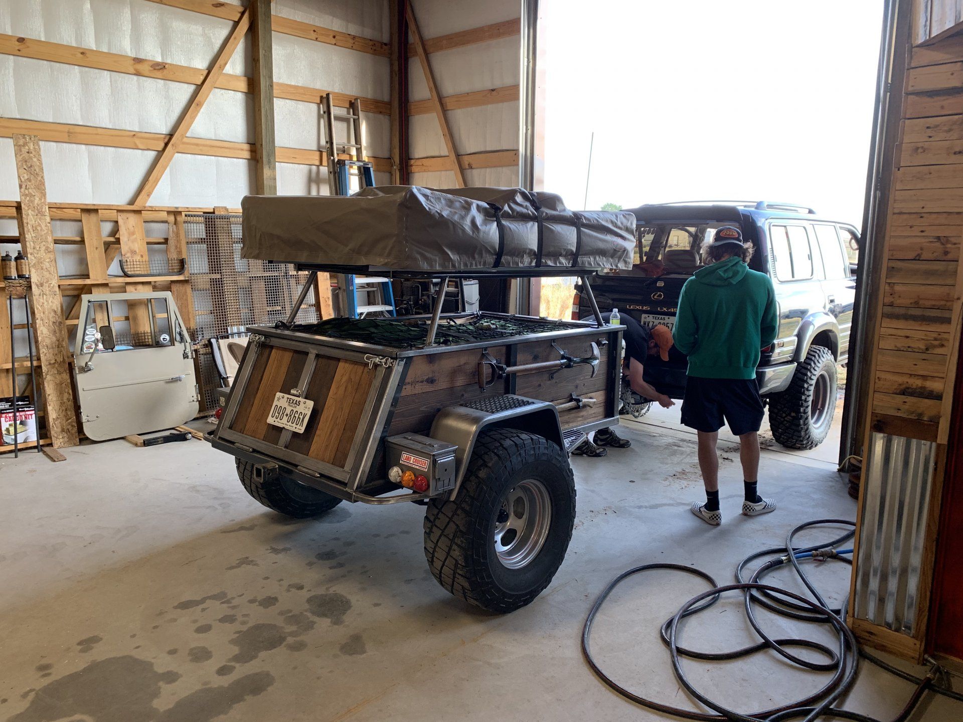

I think the bottom line is change your expectations and/or your trailer. One solution I’m planning on is a custom trailer like shown below. Loaded around 1500#, can carry it all and have a built in kitchen and really nice rooftop tent with memory foam mattress. I’ve watched these pulled on off-road passes with a stock 1FZ and go 80% of the places a LC could go without missing a beat. And 70+mph on asphalt.
