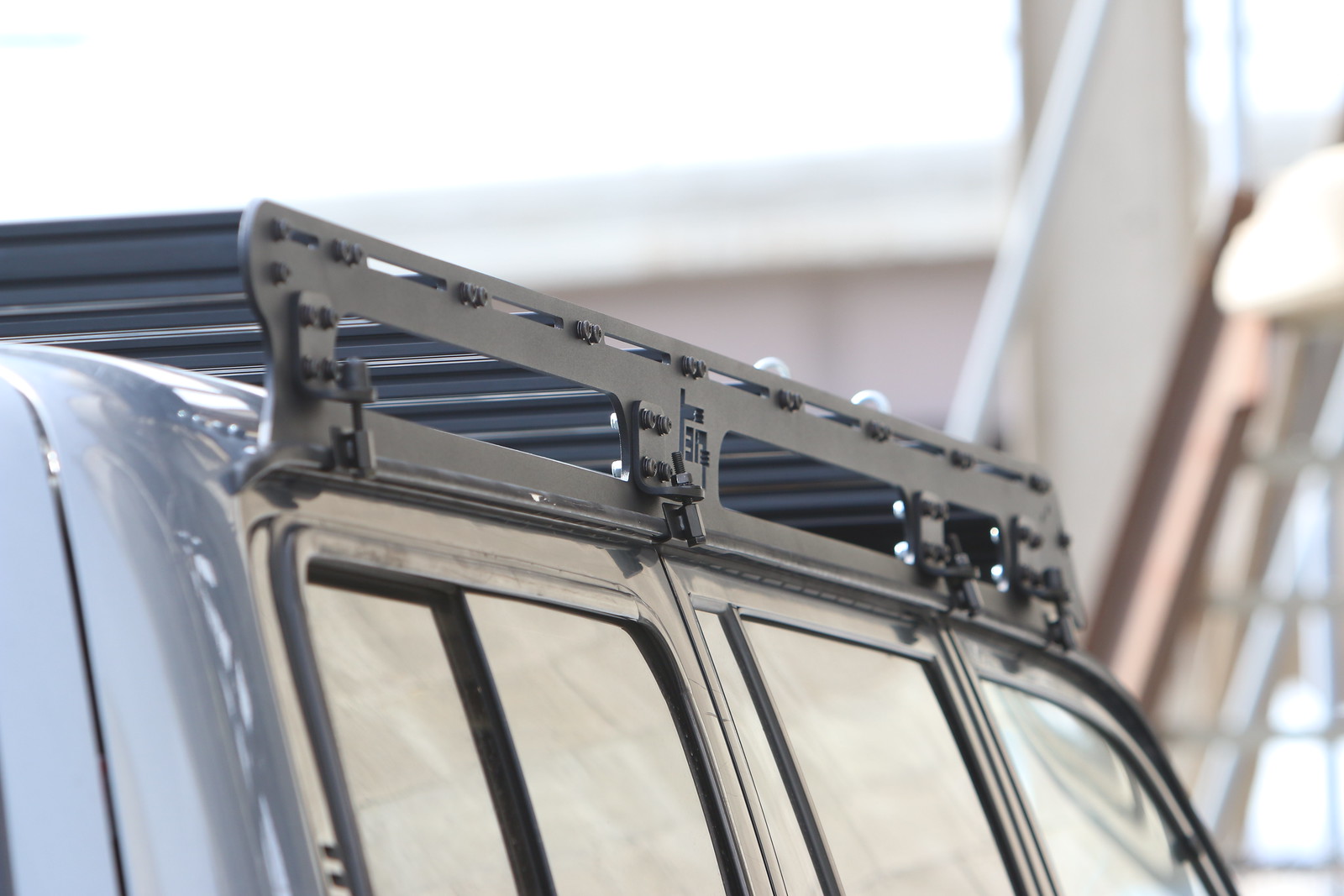

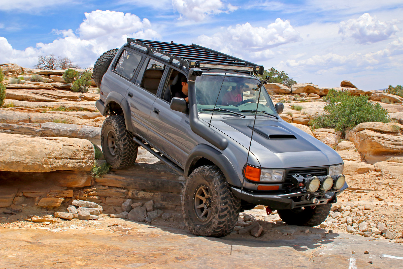

Another way to reduce the impact the rack *might* have on cracking is to get a rack with full length gutter rails like a Prinsu, or Bowfin rack. Same platform style but the rail that runs the full length of the gutter will spread the load far better than a rack with individual feet for mounting.
I have the original Prinsu 80 rack and it's been fantastic.
IMG_3254 by Adam Tolman, on Flickr
IMG_7236 by Adam Tolman, on Flickr
