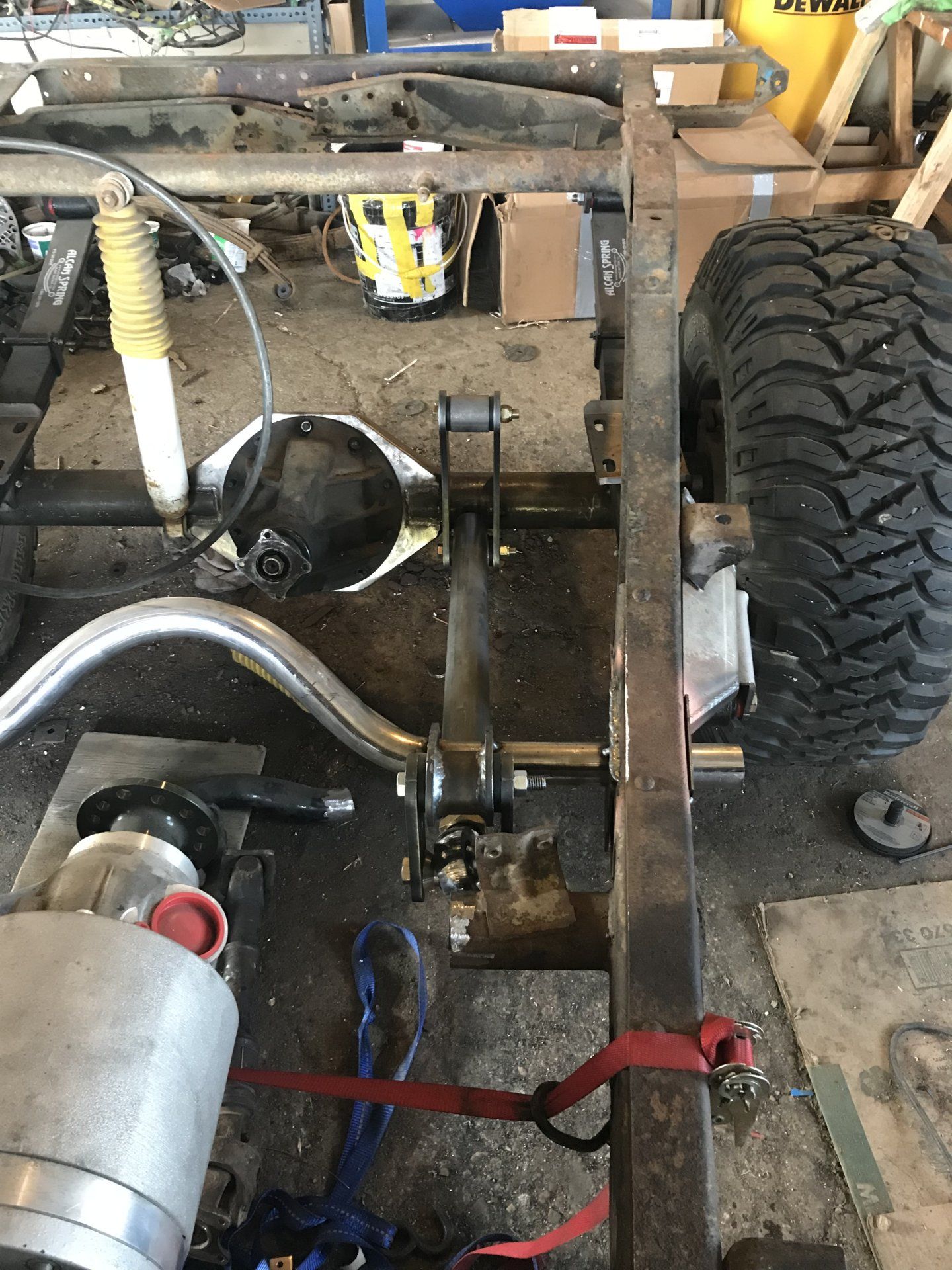

here's a little more look at my cross
member. any suggestions please let me know soon as i'm almost ready to weld it to the frame!!

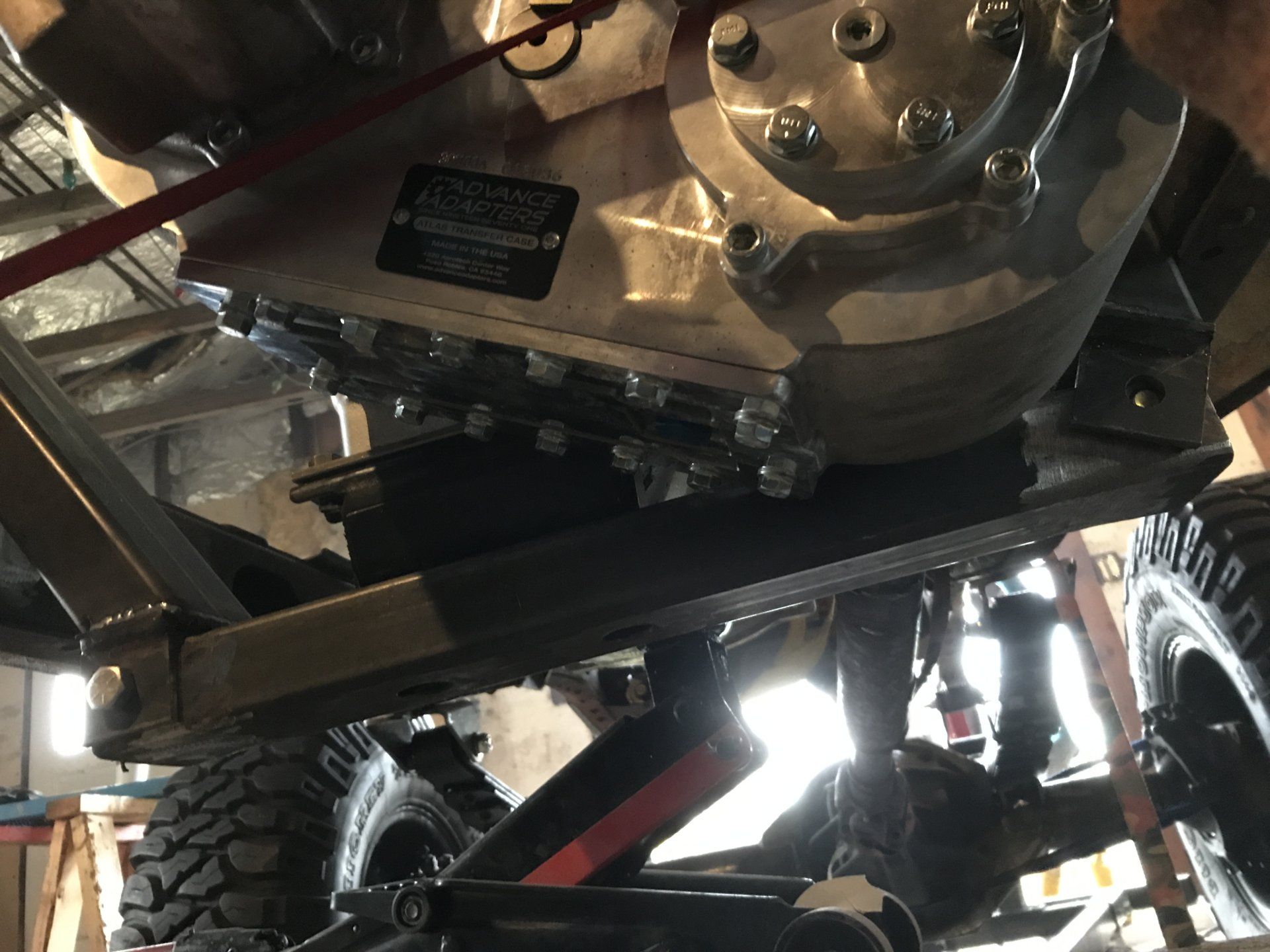

Where did you get the Nv4500 mount? Would you happen to have the p/n?
i’m putting a downey tank in so i can’t move my shocks behind. there just no room. i can outboard them somewhat but i’ll sacrifice some length that way.
i don’t have a part number but i got it at napa. i had a picture from the advance adapters i showed them. there’s really only one that looks like that. i had to make an adapter for it so i can bolt it to a custom made crossmember.

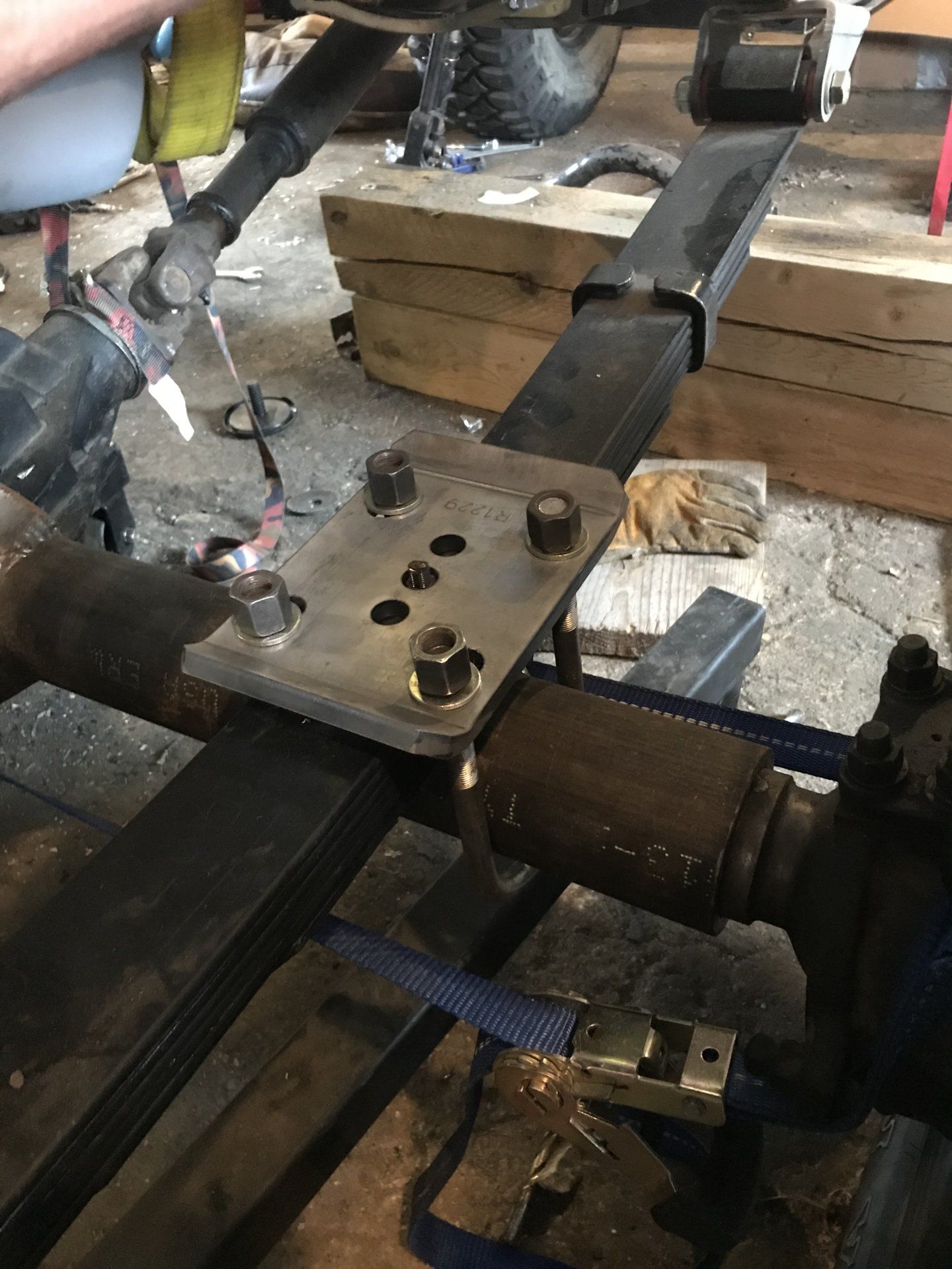

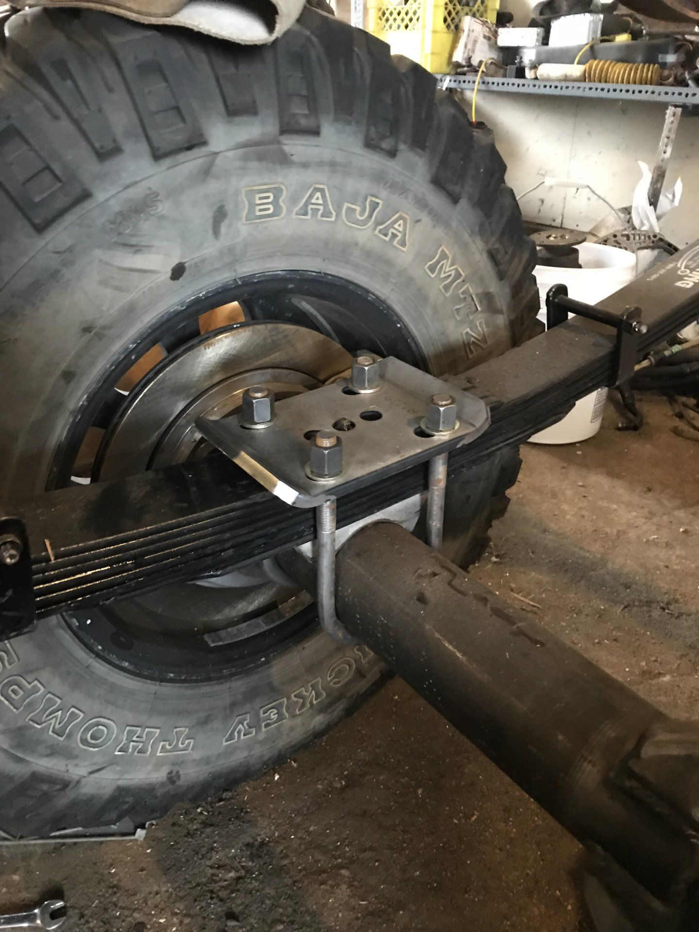

I'm considering shaving down the C shape on the perches to keep it lower. Basically almost sit the perch right on the axle. Did Ruffstuff have the U Bolts for the 3.5" Diamond?
i had to grind the spring perches myself but yes i’m trying to get them as close to the axle tube as i can. i want to leave enough clearance that the center pin on my springs isn’t sitting on the axle tube through the spring plate.

I would mount them even with the bottom of the axle and as vertical as possible. Allows for longer shocks and better use of the shock valving.
I've been wondering why Toyota mounted the rear shocks at such an angle? Reasoning? I am also planning a Downey tank and need to move shocks forward, but like you said, I understand vertical is better shock efficiency. Why did Toyota do it?

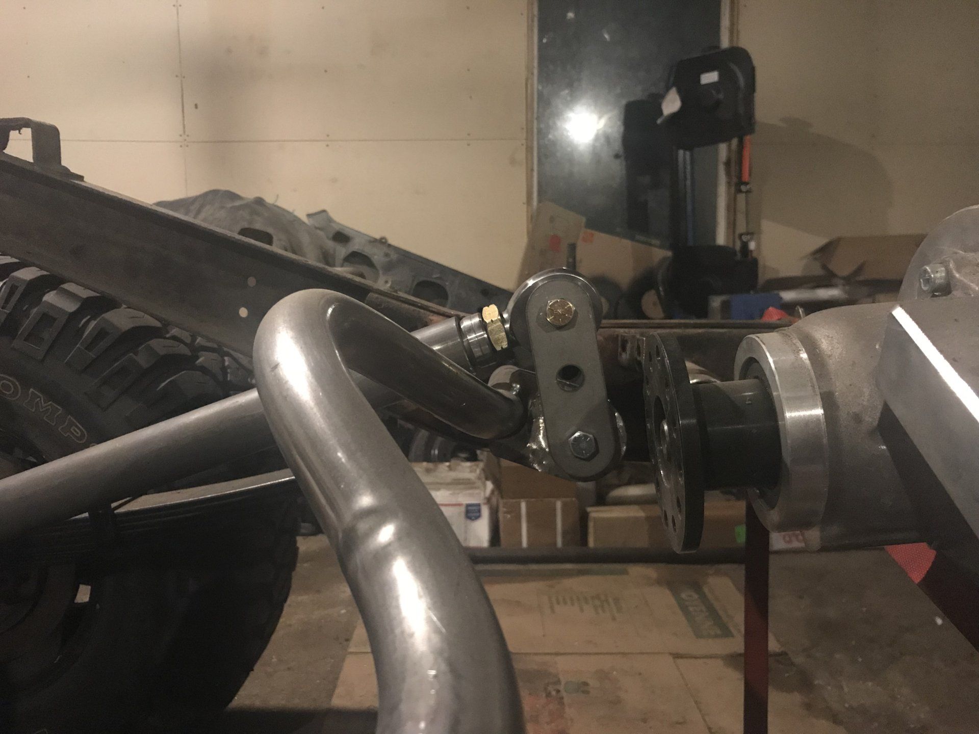

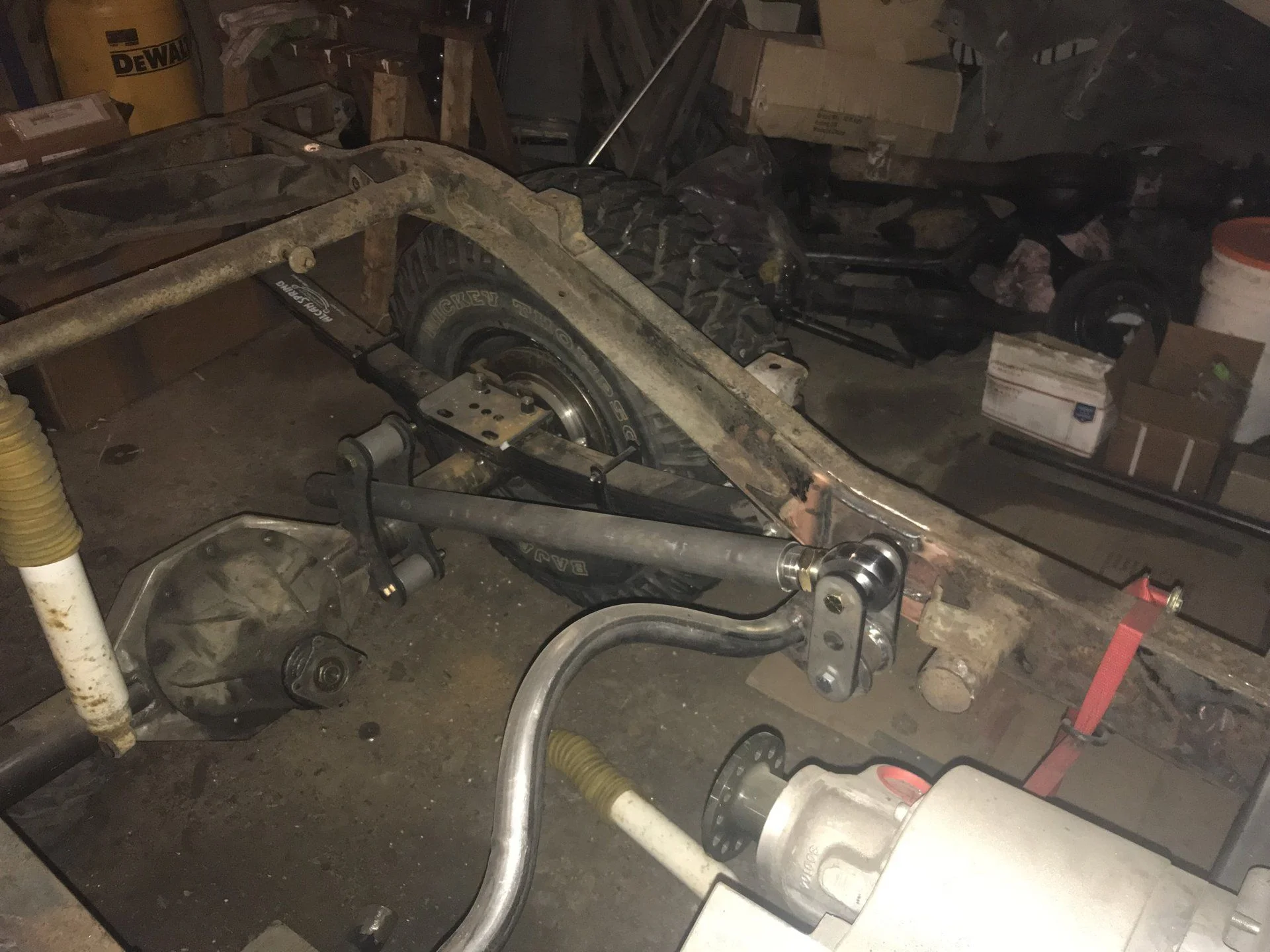

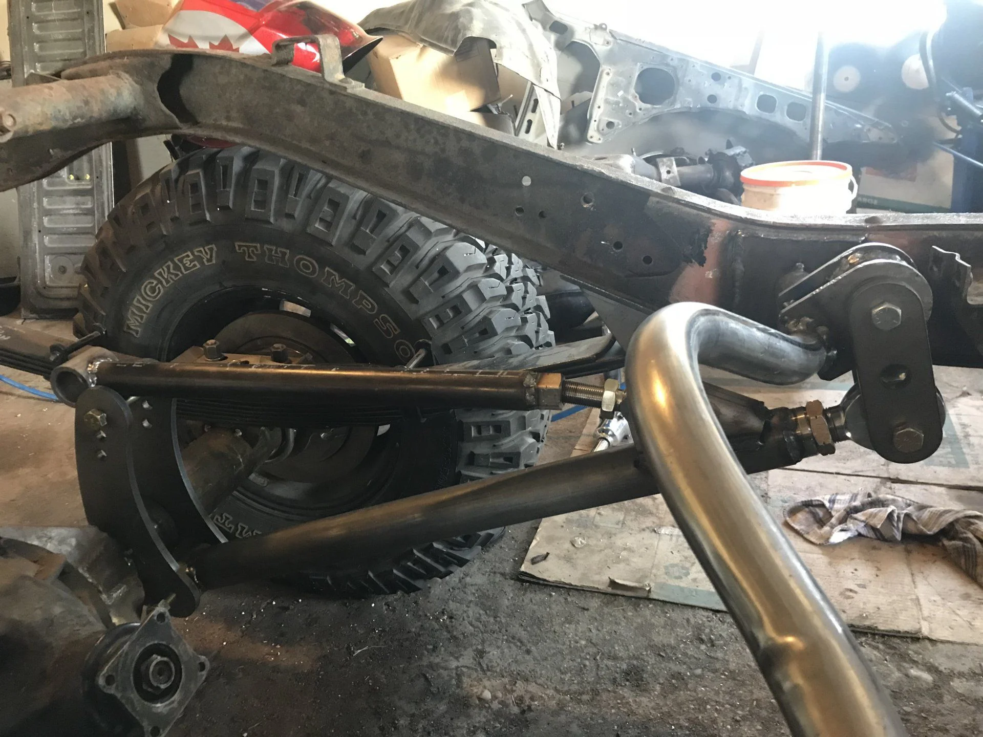

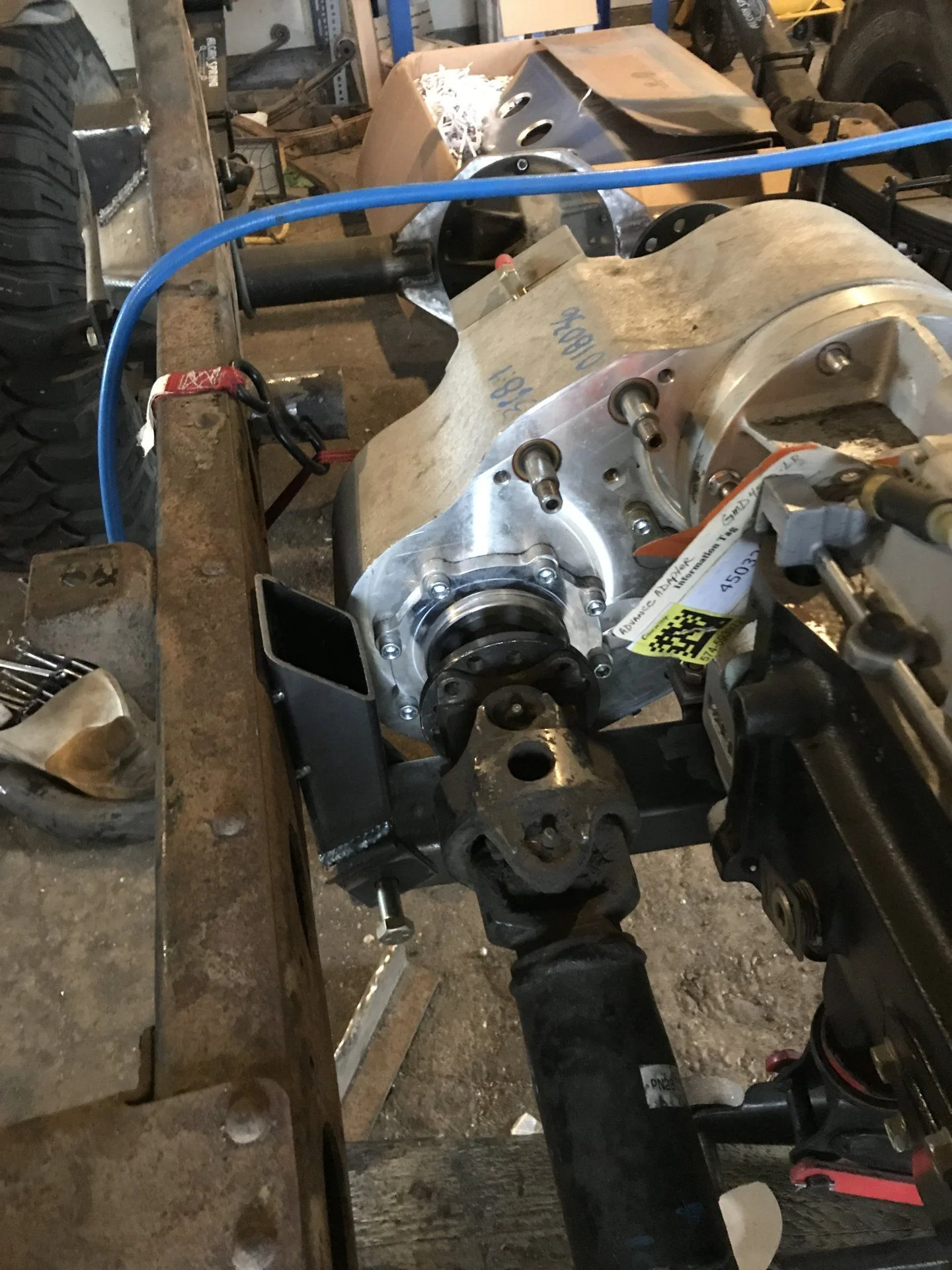

i think by flipping my front shackle on the antiwrap bar it gets the bar pretty parallel to the drive shaft. it’s maybe an inch and a half above the centre of the drive shaft at the output flange. otherwise my crossmember hits it.
i had some friends help out the body on it tonight and i have good body clearance above the shackle and the cross member. anyone have better ideas or think that’s not close enough to parallel to the drive shaft to work properly?
at present my frame is 24 inches off the ground at the bottom of the frame rail. that with 33 inch tires. i figure i’ll drop an inch when the weight of the body and everything is on it. maybe even an inch more once the springs are broken in. if it doesn’t i might take a leaf out but that’ll come with time. i want to keep it as low as i can for a spring over.

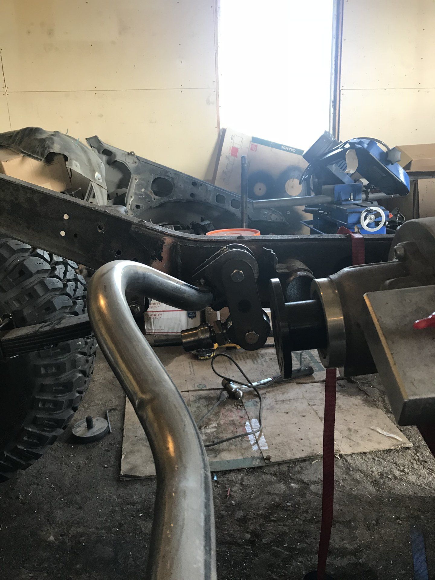

took your advice. i think the angle is actually a little closer to parallel this way too. ill have to have the shackle pointing forward a little for clearance on the cross member but that’s a compromise i’ll have to make to put it where i think it’s geometry will be best
that’s where it’s going. all cut to length and welded. it’s just cooling before i put the bushings in
now to shock mounts. how much clearance is going to be needed beside the antiwrap bar tower? this much? i might need to outboard them a little on my cross member if that’s too tight as it sits there’s about 1/2 inch clearance at my u bolt plate and 1/2 inch beside the tower

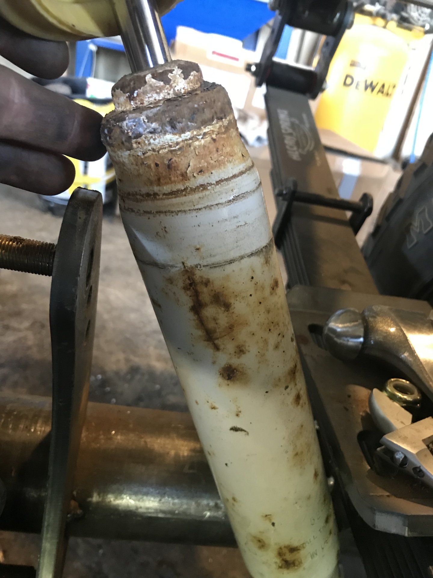

also that folks is why you should never use shock boots. they keep in water and dirt and does that to shocks!!
