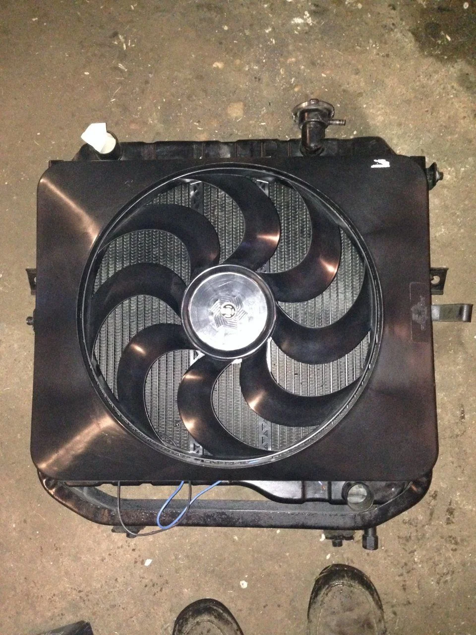

well i talked to my rad guy and he said the 4 core I have is just fine with a good fan and shroud. I got it pressure tested and cleaned up and put this on it today
is the flex a lite black magic fan. not cheap but looks like it was designed to fit the rad. it is perfect!! I figure while crawling this will cool better than a low rpm engine driven fan. comes with thermostat and mounting stuff. I'll probably put a kill switch in too some can shut it off for water crossings and then flip it back on. we'll see. at least I know where my rad and fan will sit so I can continue on now with engine placement!!
