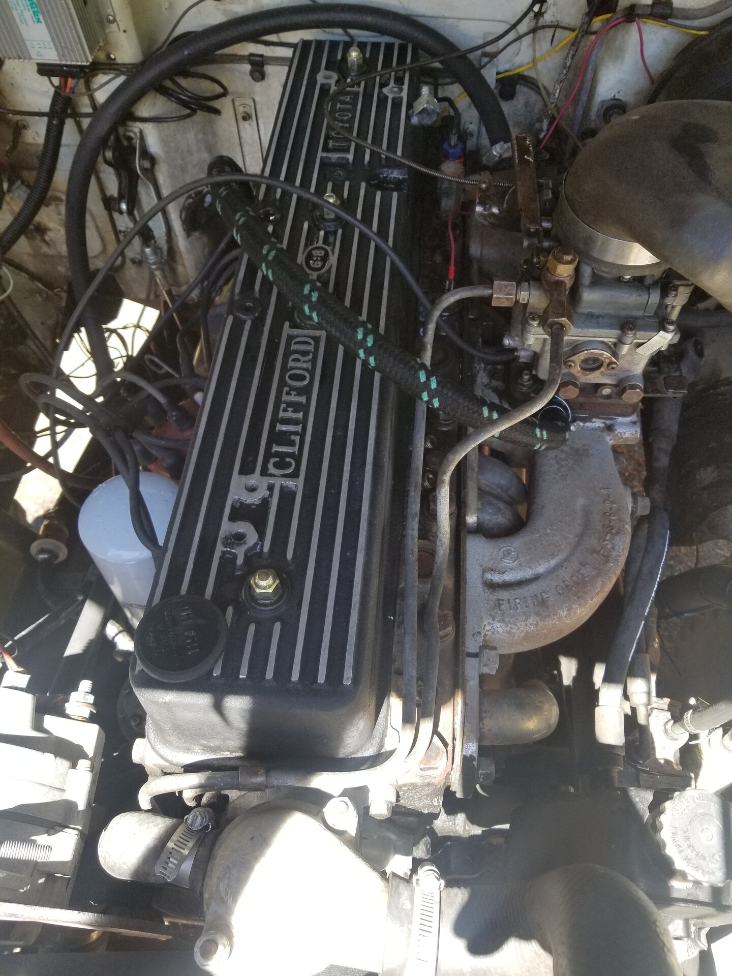

I really like that vavle cover, probably really hard to find. What does the rest of the air box look like? I have always liked the old iron pigs and 45lv's but i have never been able to get my hands on one. I do know what you mean, I have had mine since 2000 so almost 25 years and my truck has seen many changes throughout its time with me. They kinda almost become family in a way. My goal with it is to make it easier to maintain and find parts for. That is why I have made some of the modifications that I have. Though I am leaning very heavily towards the sniper injection.
