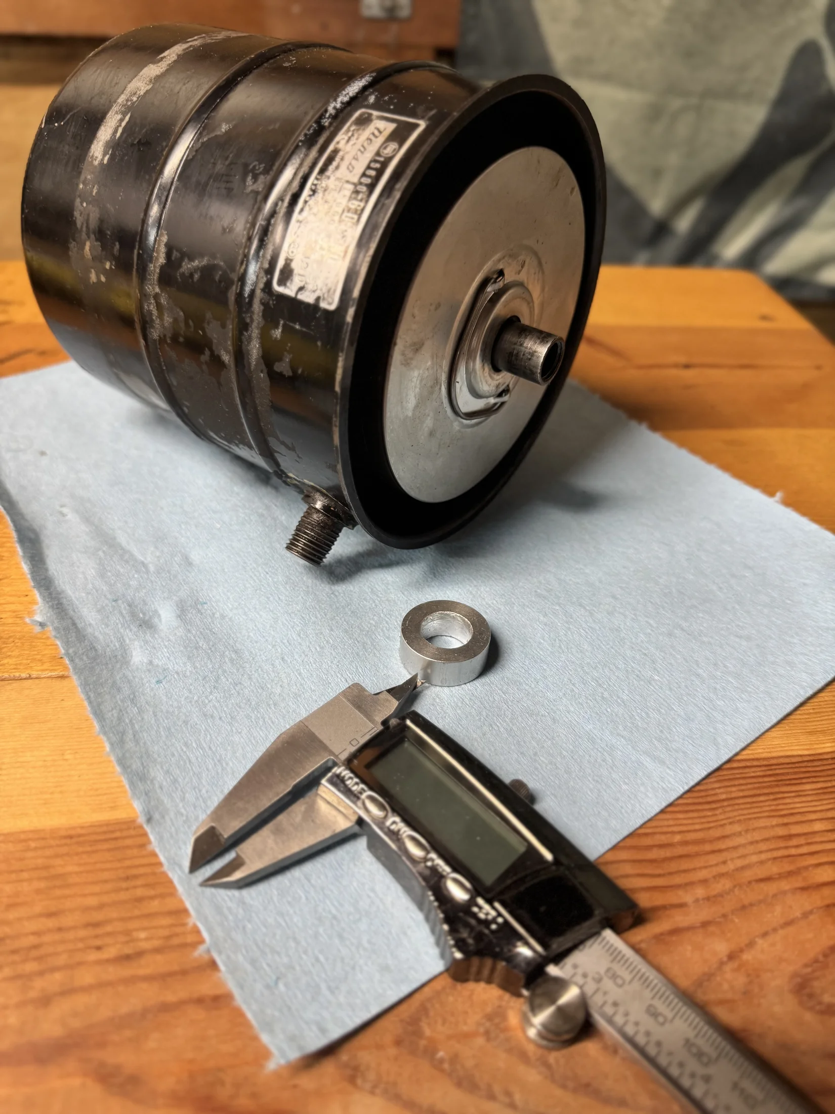

The one thing they could use are spacers to make up the height difference compared to the Toyota filters. Super easy to solve. What you need are two 1" OD, 9/16" ID, 3/8" H spacers. That's it. I was able to find aluminum spacers with a 1/2" ID for cheap and drill out the ID to 9/16. Worked perfect!

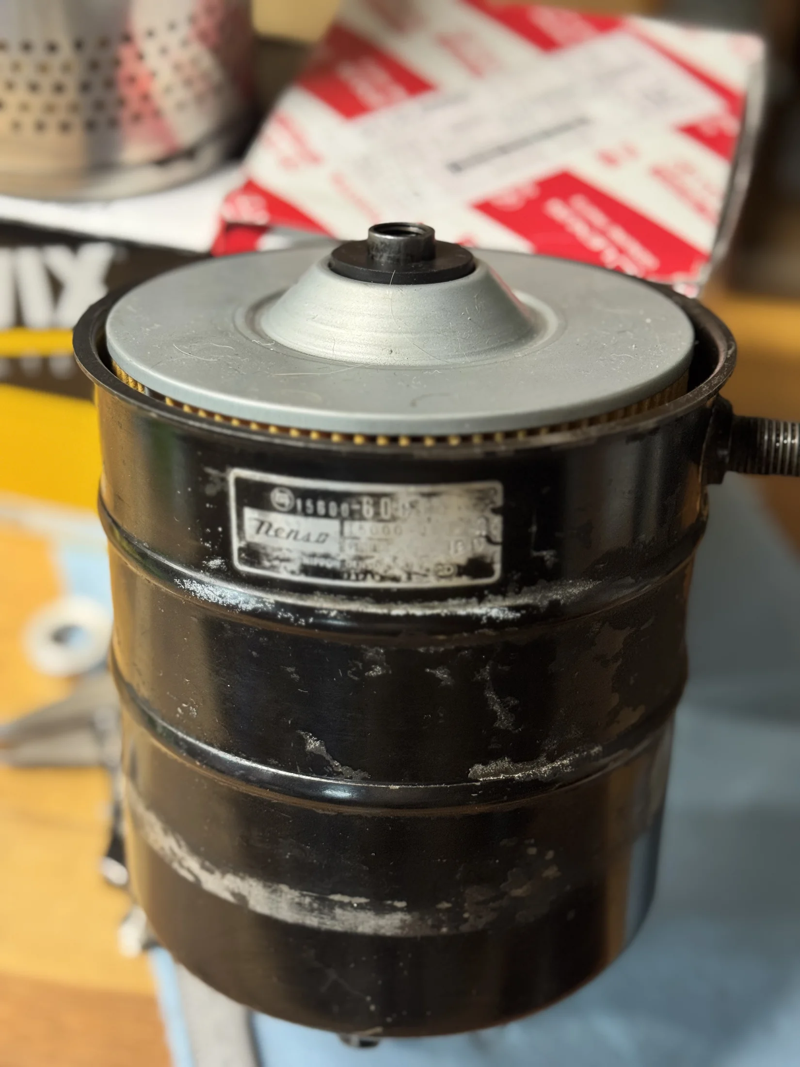

OEM filter height in housing:

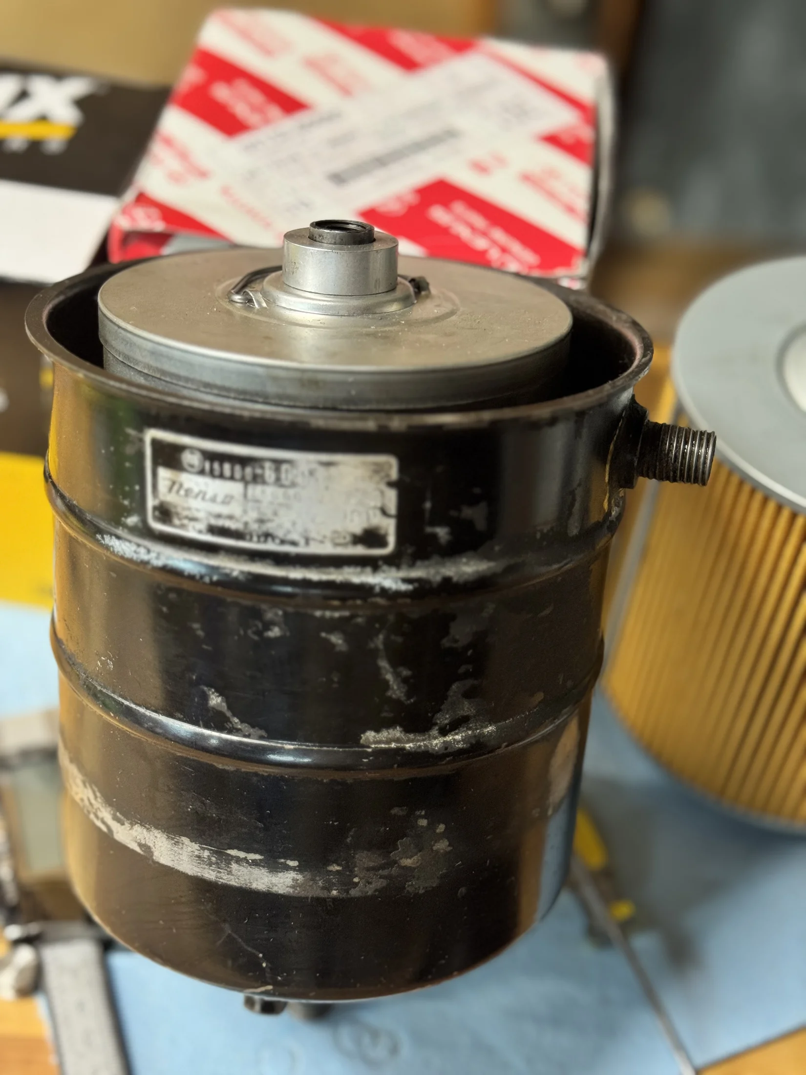

Chevy filter in housing with spacers:

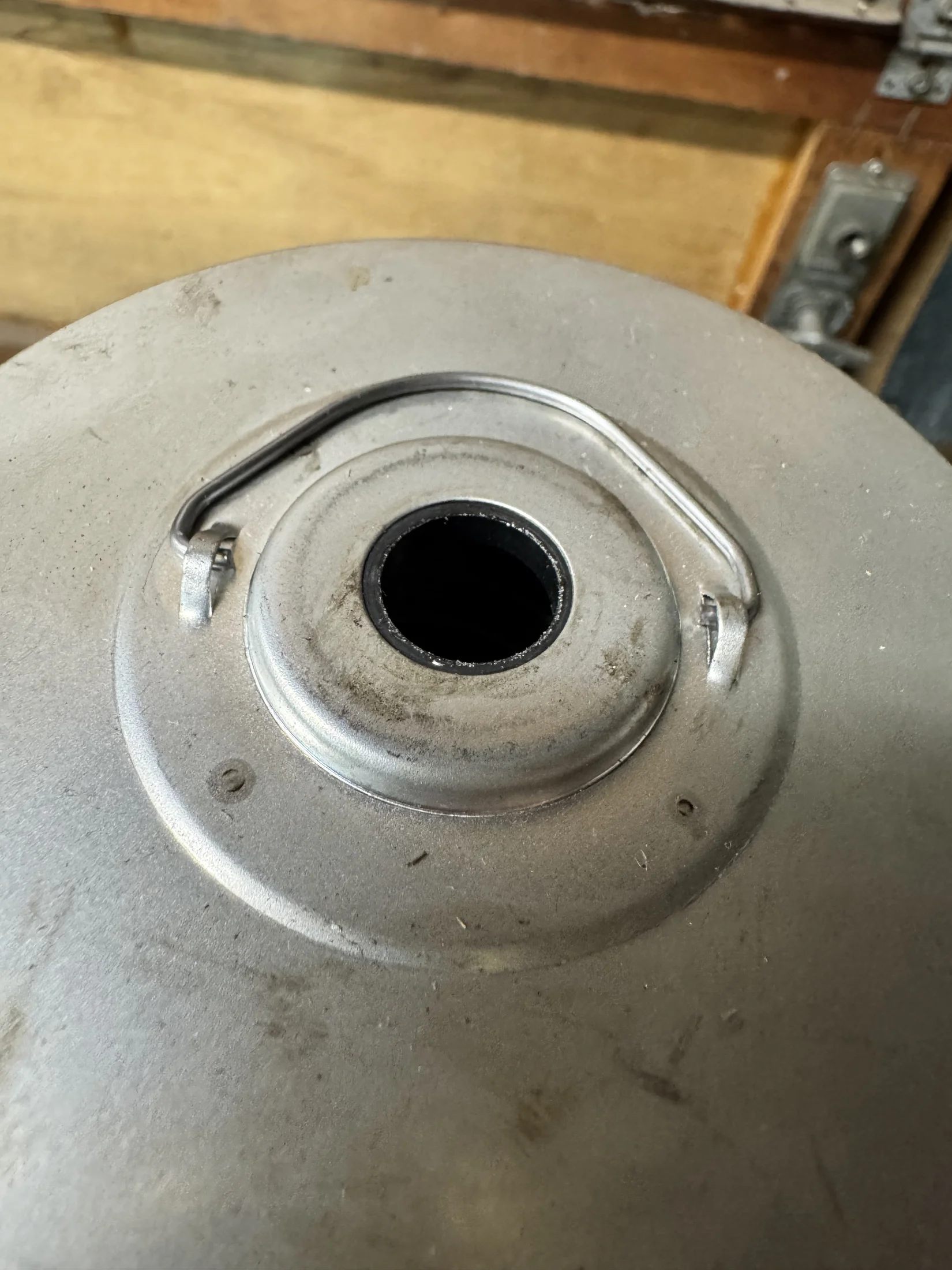

Internal rubber seal on Chevy filter:
Easy to make spacers:
