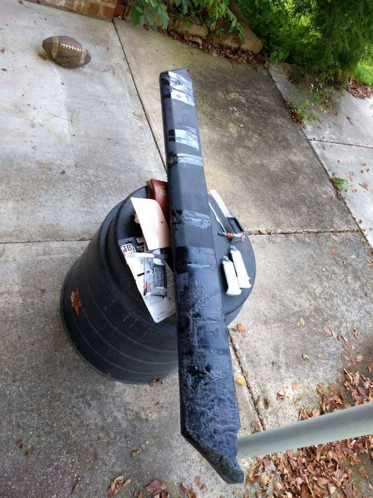

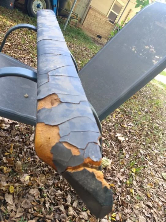

How bad is your pad? I thought mine was a lost cause. Gave it a last ditch effort with about $35 of products from Walmart. It turned out pretty good. It's amazing what you can do with a little bit of time and effort.
@vpatsears Do you have a write-up on that dash pad refurb? It looks quite nice. I'm guessing the JB Weld and some plastic acceptable paint? Did it hold up well?

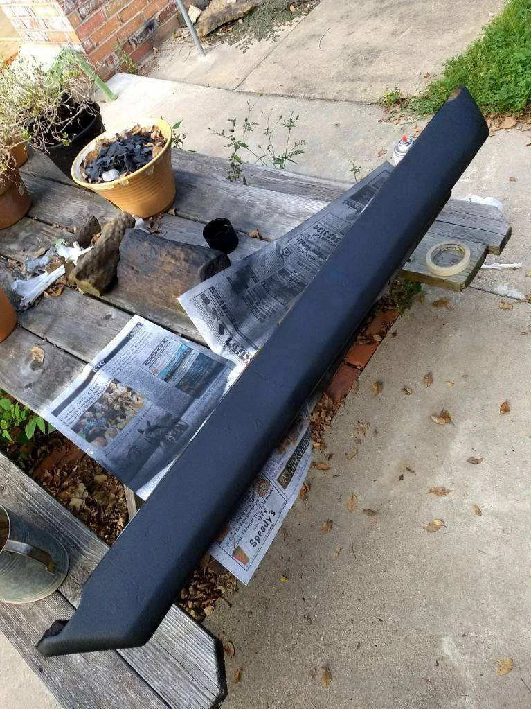

@vpatsears That looks great.

Whats that you painted with? Thoughts about it?

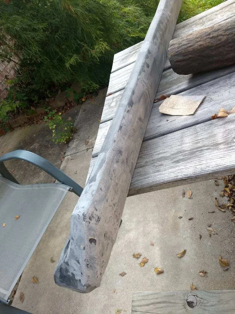

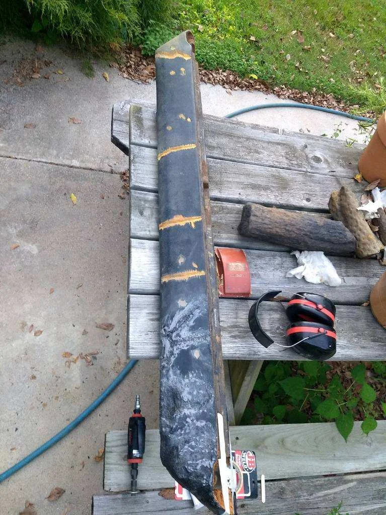

I used a JB Weld Plastic Bond product. Two part, mix it like epoxy. Used it to fill in all the bad spots. Once sanded down, sprayed it with a light coat of bed liner in a can to give it some texture.

I don't have a write up. Just a few pictures. Used JB Weld Plastic bond product. Two parts, mix it like epoxy. Fill in the bad spots, sand it smooth. Spray a bit of bed liner over the top for texture. I did it about a year ago, has held up so far. Give it a try!
