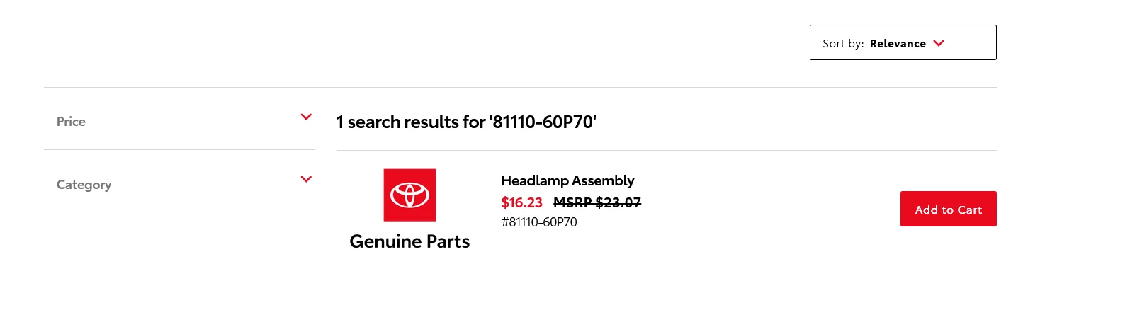

I've used Genuine Toyota Parts and Accessories: Official Online Store | Autoparts.toyota.com - https://autoparts.toyota.com/ several times over the years for other things.
They will show MSRP and a list of dealers based on zip code. Dealers will typically all show different discounts, and all offered some discount off MSRP on anything I've checked online, usually between 10% to 20%. Just walking in or calling on the phone, from my expirience with my local dealer, I think they charge OVER MSRP....
Some of the dealers will also allow local pickup for online orders. I purchased a new bumper cover for my prius last year, shipping would've been at least $100 from several sites I checked (6 foot long), was able to find a dealer 60 miles away that did local pickup and a decent discount. It can be kinda time consuming and repetitive to shift the zip code around and check dealers all over but for larger items can be worth the time (I got a radiator shipped from 2 a dealer in a different state once, best price...).
This is perfect. I just searched for a couple of part numbers and I see a few Toyota dealerships listed. They are all a little ways away from me, but it would be worth making a stop around a planned trip to get some things I need without overpaying.
