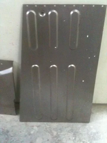

After a long conversation with the owner, decided to send the body to sand blasting and start with a clean slate. In doing so we uncovered a lot of issues that would have surfaced later. Lucky for me and my lovely 40, we now have an opportunity to cut out a lot more rust and insure this ride will be one of the best around when we are done.
Turns out (as some of you may already know) it is a common practice for lazy body men to build up and sand down filler rather than working metal back to its original shape. In addition, the filler will hide a lot of areas where rust has formed saving hours of labor and the consumer would be none the wiser.
This being said, Attached are pics of the tub after being sand blasted and the sprayed with an e-coat.
(Another thing you guys may already know) The epoxy coat is required in order to seal the metal after a fresh sandblasting. It guarentees moisture stays out of the metal while you work on it.
Next step is cuting out the rust, replacing with new steel, then pounding and filling the bent panels.
Only after this is done, should a filler primer be used.
It kills me to undo the work previously done by sandblasting, but at least I will know it was done correctly and all the rust will be gone.
