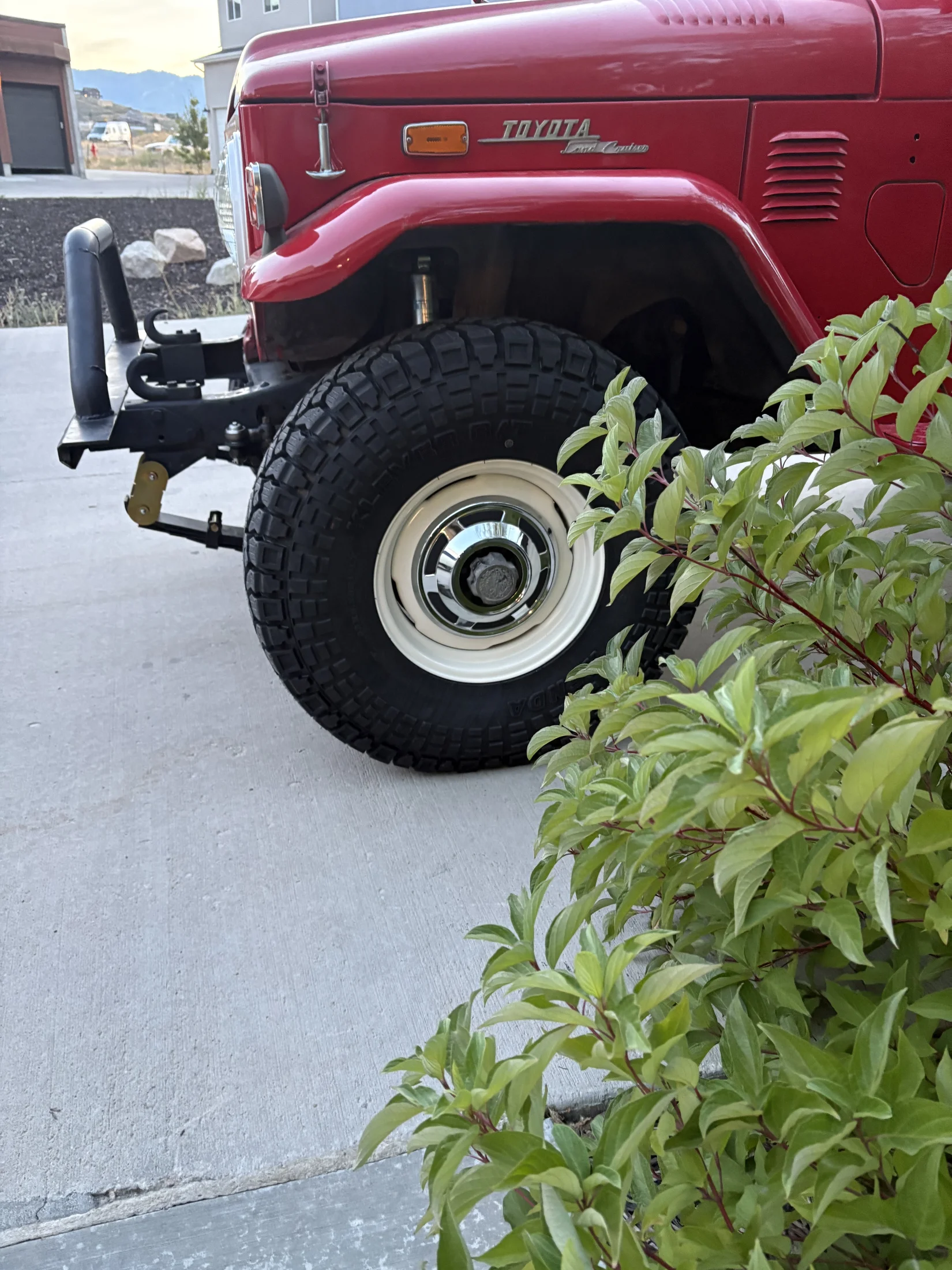

Yes, no question in that the tire is unusable.
Question was just regarding the wheel color
You took the trouble to carefully evaluate different color options for the other wheels to get the color exactly to your liking.
I'm missing something, because I don't understand why you wouldn't want the spare wheel and tire to match the other four?

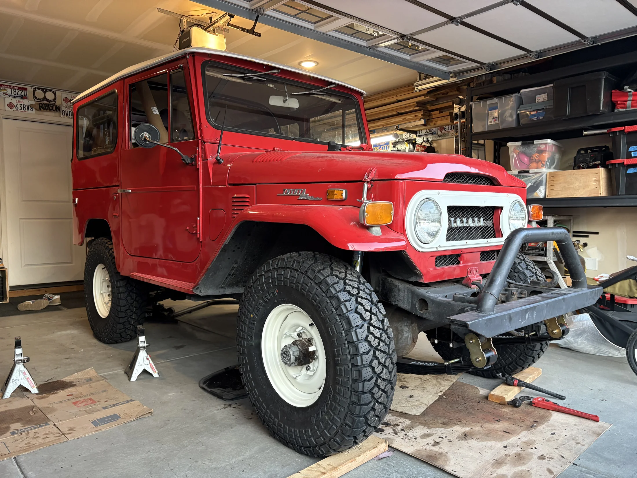

First pic of the Redline kit on. I’ll get some better photos once cleaned up. No complaints here on the redline kit…

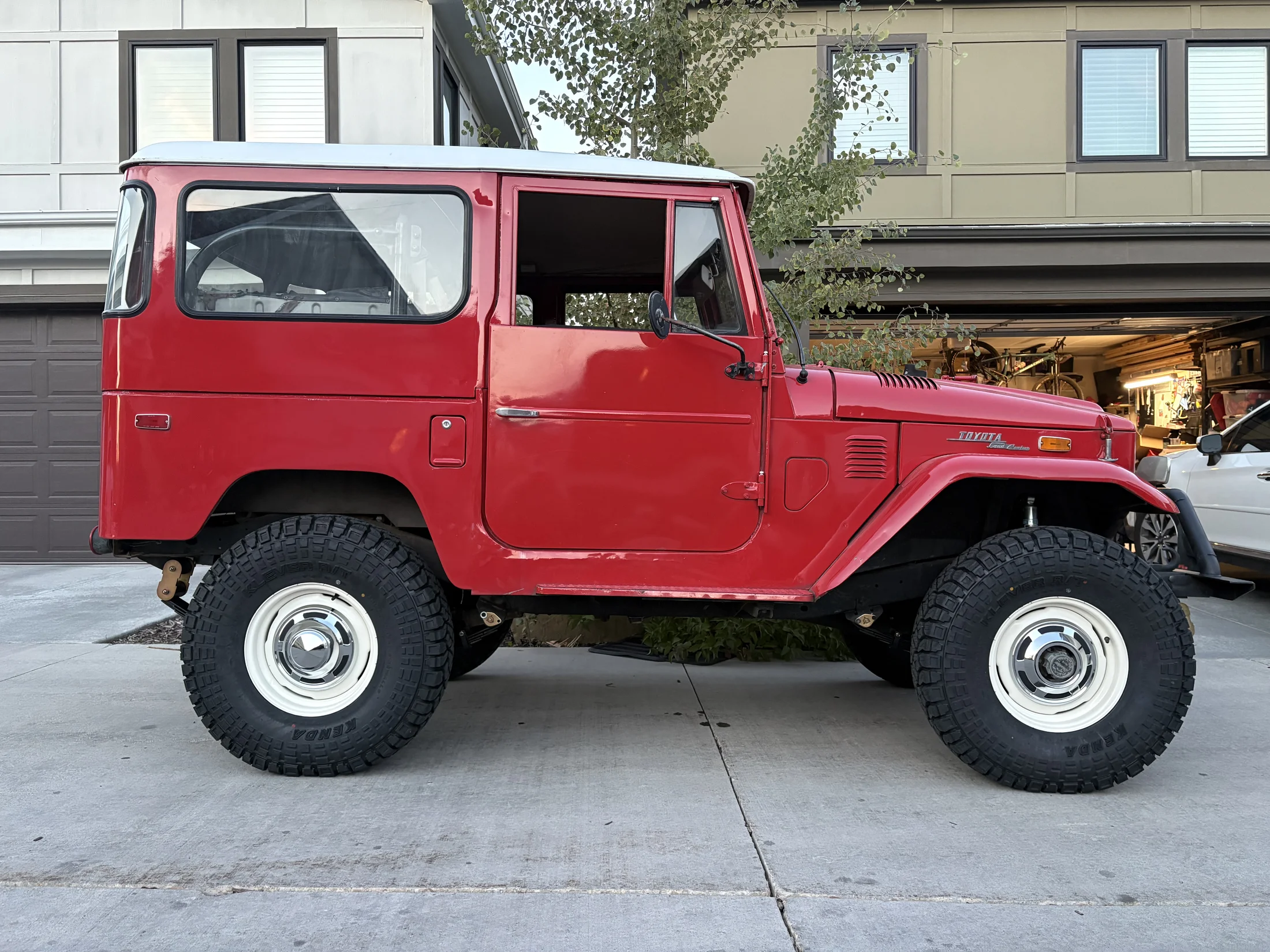

Very happy with the redline kit. Feels very cushy with those bilstein shocks. I went with the medium lite kit, springs seem just about perfect.
New 555 tie rod ends from cruiser outfitters tightened up that steering a lot.

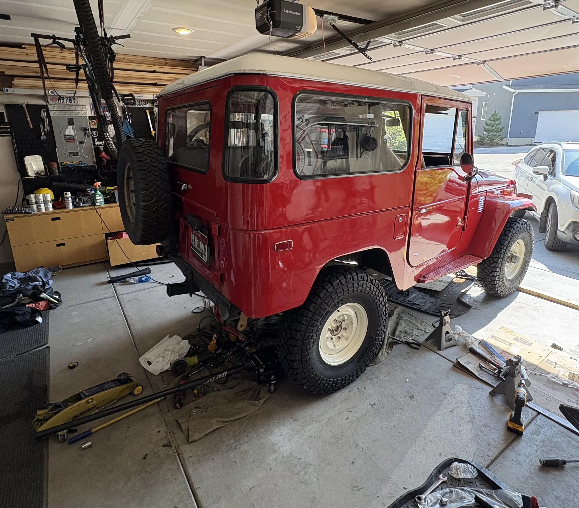

Bled brakes yesterday, snapped on the hubcaps, next up is getting the spare painted and mounted with an kenda to match and new weatherstripping all around
