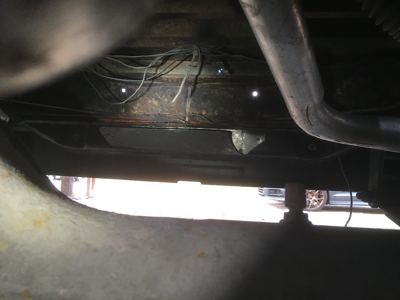

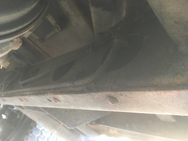

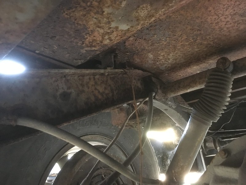

Passenger side:

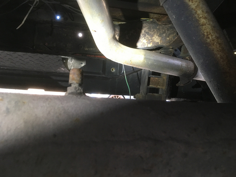

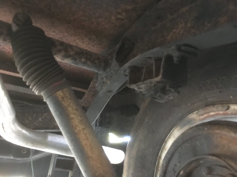

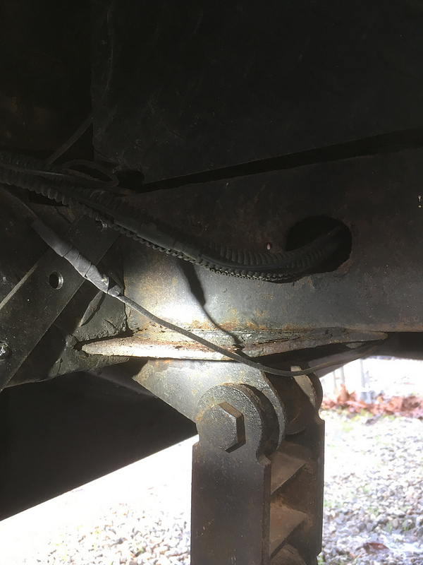

Rear Sections:

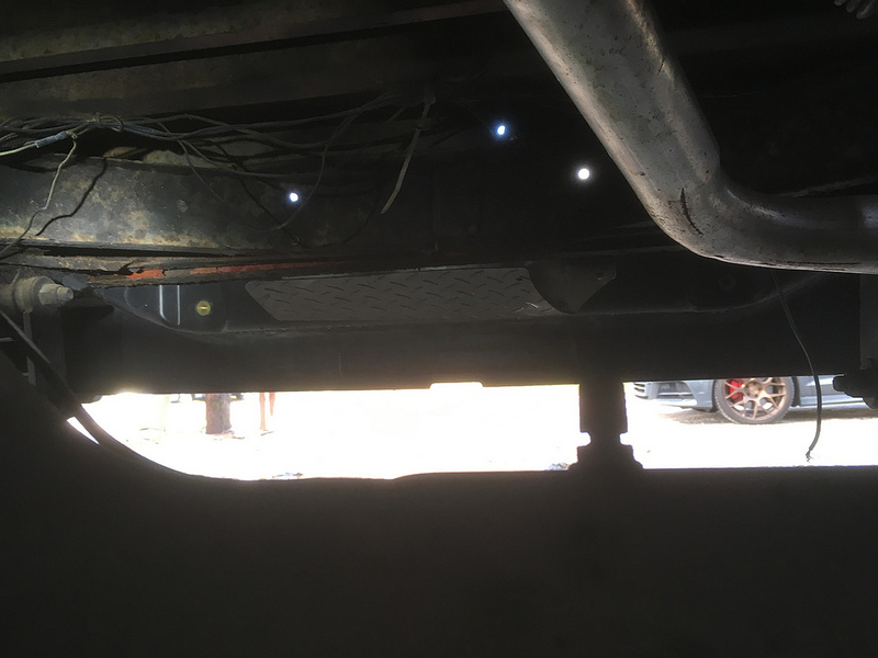

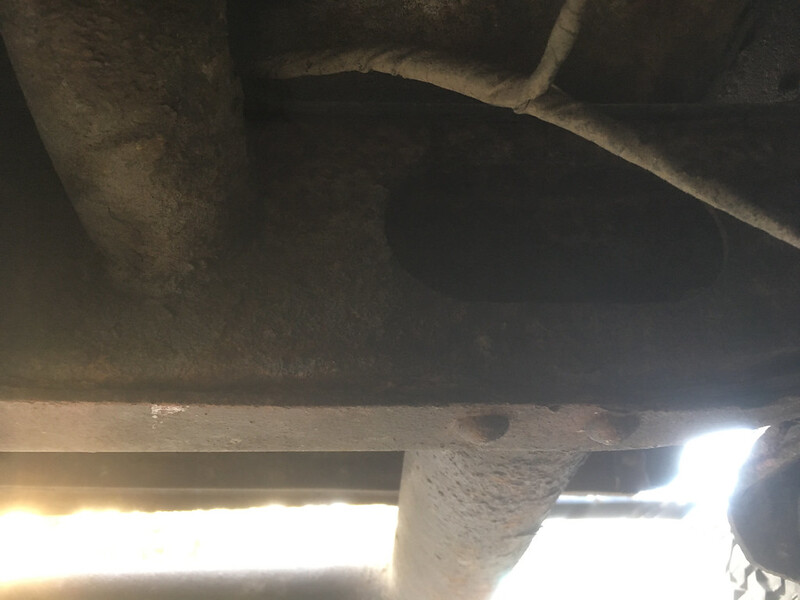

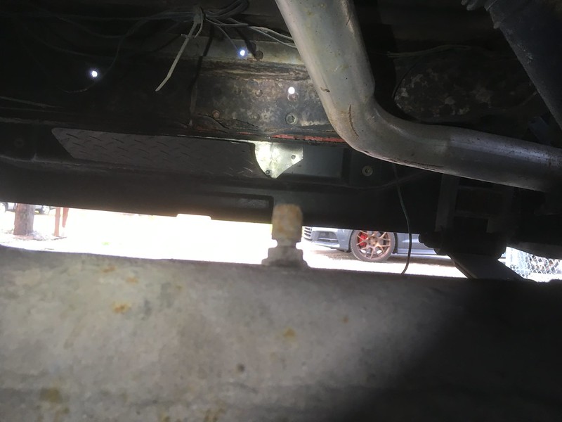

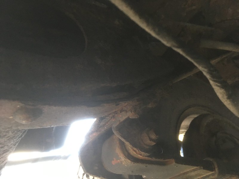

Based on chatting with @nelsonto and how he plans to use this truck - keep at his new lake house to putz around in, run short errands, etc., doing a frame swap seems like not the best use of funds. The entire truck has rust (some worse then others) but would serve the purposes above just fine with the frame patched (and the other baselining like brakes and fluids he mentioned before). This is one that doesn't necessarily need 'saving', but having it's useful life extended!
It doesnt look that bad. I will patch it but not for that amount of money.
I agree. Looks like the rear has already beed patched. I do not see any issue patching this and making it safe. I have seen a lot worse repaired.
Brakes and trans swap is pretty straight forward. My 75 daily driver back in the day stopped fine with 4 wheel drums. They just have to be adjusted properly. I have a customer with a 68 and after I adjusted them it stops straight without holding the steering wheel.
Good on you Jon for doing this. I was thinking along the same lines just based on experience.

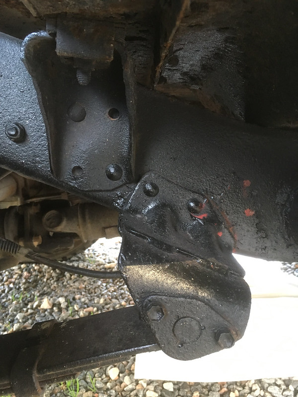

@HawkDriver has a build thread where he showed how he cut pie wedges out of some channel steel to make a box reinforcement for his frame. IMO, Something like that would be sufficient for these purposes.
IIRC, Kevin did some reinforcement on @DSRTRDR frame that cracked at this particular point. They could probably provide some input on how long the patch piece should be to handle the particular stresses of that location.
8k sounds high, but that's about the going rate for a frame swap. The shop I'm at charges 150/hr. A frame costs about 60 hrs in labor. 1000 bucks doesn't buy u much these days. All those rusted bolts are not going to exactly want to come out like butter. That cruiser is really rusty. Looks like the floor is rotted too.

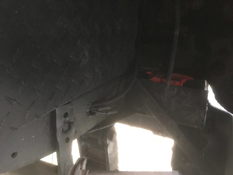

Not sure if this you tuber is on mud but I have a similar frame issue and this video gave me hope and couch confidence.... I still haven’t taken the plunge after many many months but seeing this at least shows me I can get it back on the trail/road if I could just find some diamond plate... pretty creative and pragmatic... very much in line with the get-r-dun approach I’ve been taking with my problem child
I would not put much money in that truck. Weld it up. Get it safe to drive and enjoy it.
