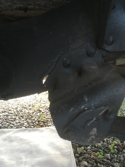

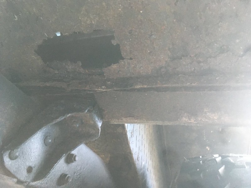

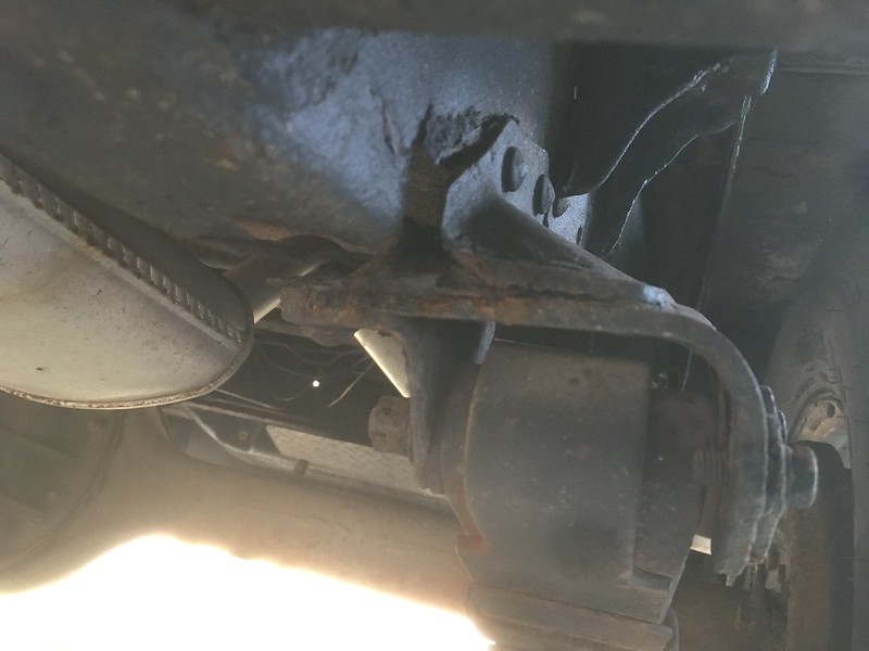

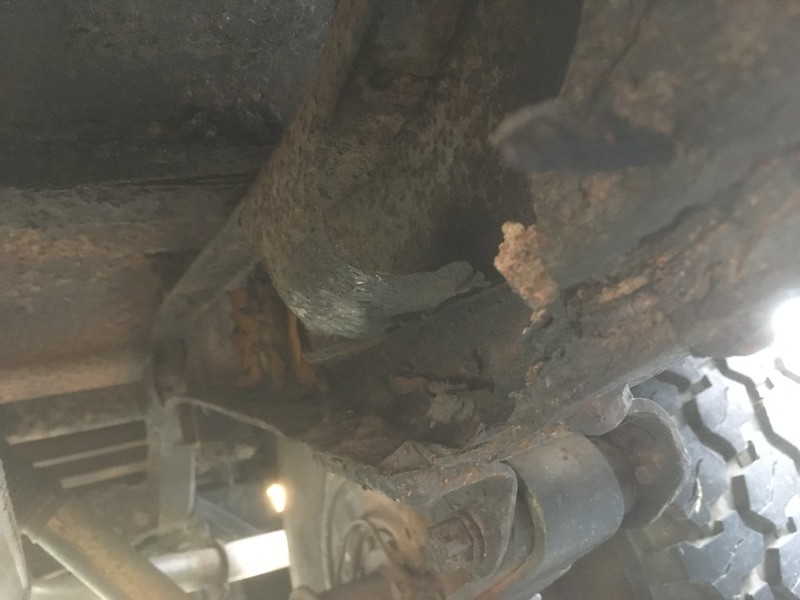

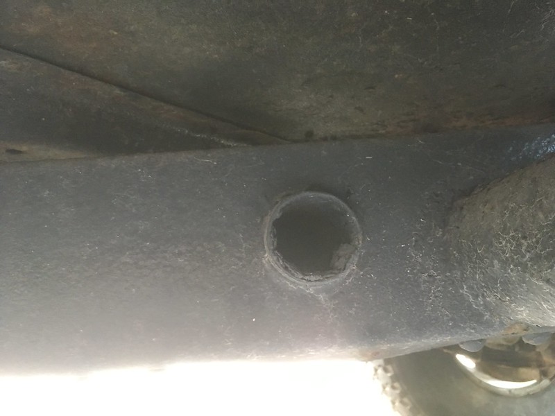

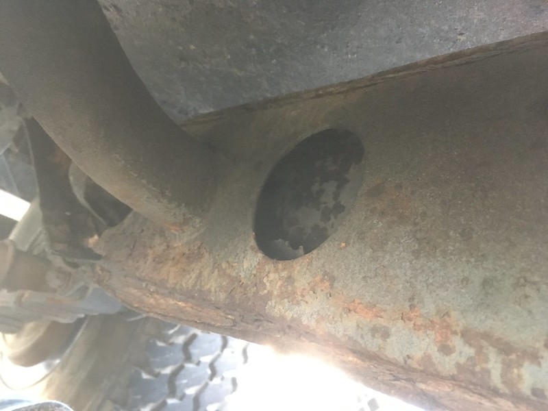

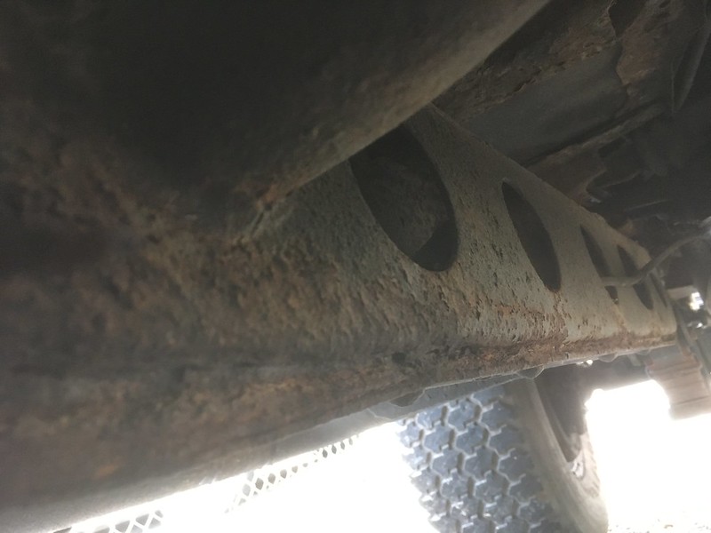

Ok...I went and crawled under this truck earlier this morning.
Yes, it has some serious rust through at the rear (front side) spring hanger but IMHO it could be patched and replacing the entire frame isn’t only option.
Yes, patching it would be obvious (couldn’t hide it) and kinda funky looking (no need to make it back to 100% stock looking) but i see no reason it couldn’t be done and be safe.
I took my dslr camera but ended up taking pics with my phone...so they’re kinda crappy. It’s been a while since I crawled around under a 40 series with no lift and stock sized tires...it’s low!
The front half of the frame seems great and the rear 1/3 is way better then I’d expect based on the major issue noted above. The drivers side is significantly worse and would require more patching. The biggest challenge (in my mind) would be getting decent welds on the patch pieces depending on how high up the frame they end up being...I’m not a pro welder so this might be a non issue. Also would need to make sure the rear perch is reattached in the same place (suspension geometry, etc.)
Pics...
Drivers side:
