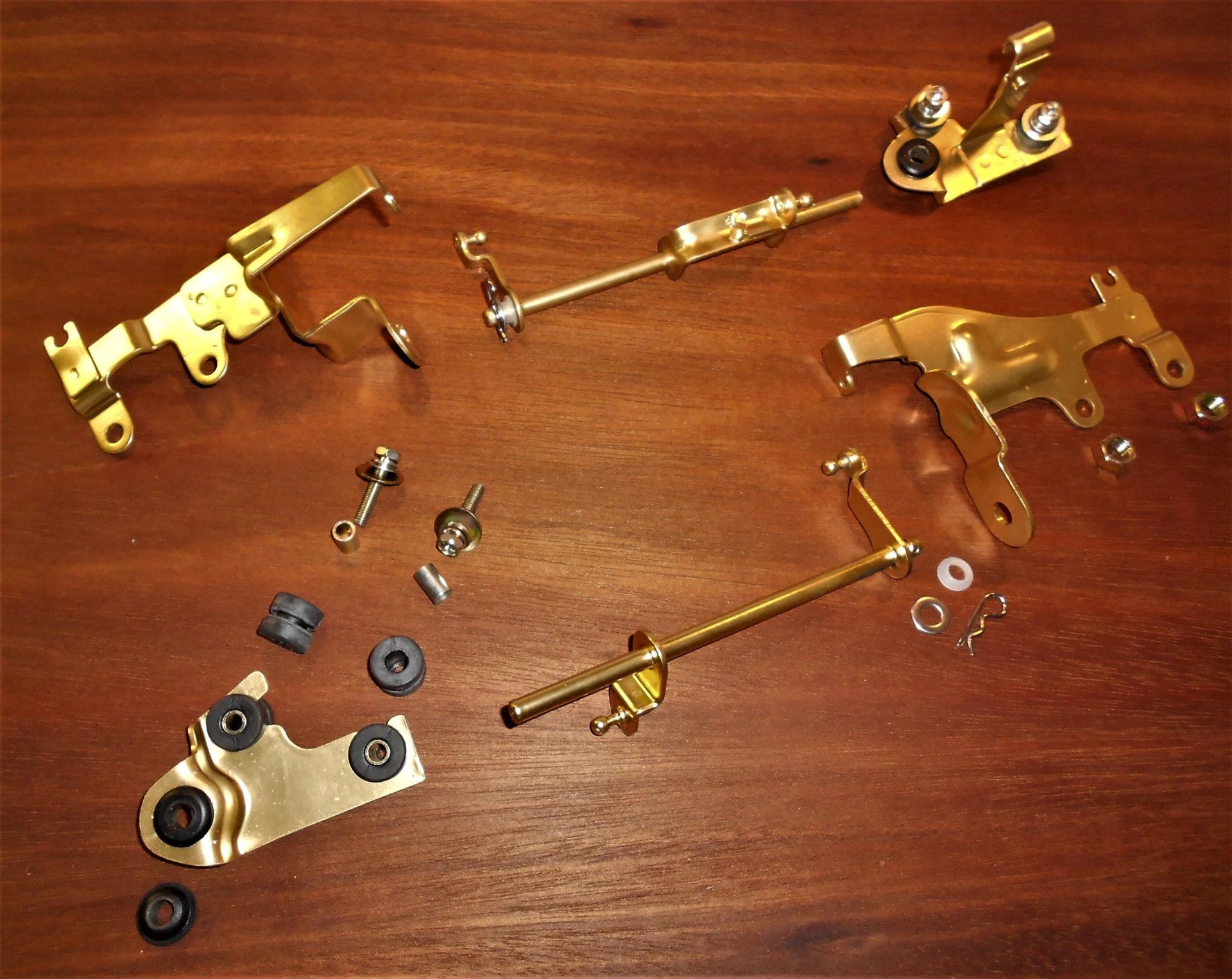

I am currently putting a 1975 2f out of a 55 into my 1971 40 and have ran into the problem of my throttle linkage. I honestly can't rap my head around how I am gonna line anything up and connect it as nothing at the moment is anywhere near lined up. Any help is appreciated!
Pick one system and use it:
1971 carb, intake & exh manifold, air cleaner, throttle cable & pedal, fuel lines...
or
1975 carb, intake & exh manifold, air cleaner, throttle linkage & pedal, fuel lines...
1975 - 8/80
Your firewall isn't going to have the right holes for the pedal mounting fasteners, the hole for the pedal to pass through or the firewall mounted bracket for the linkage.
I don't remember exactly what I did (it's been too many years ago), but I had to jury rig the hell out of it. Nothing lines up. I will pop the hood and look this weekend.
I took more of a look at it earlier today and am probably just gonna throw a different carb on it because like brian said my firewall doesn't have the holes in the correct spot. I appreciate the help!
