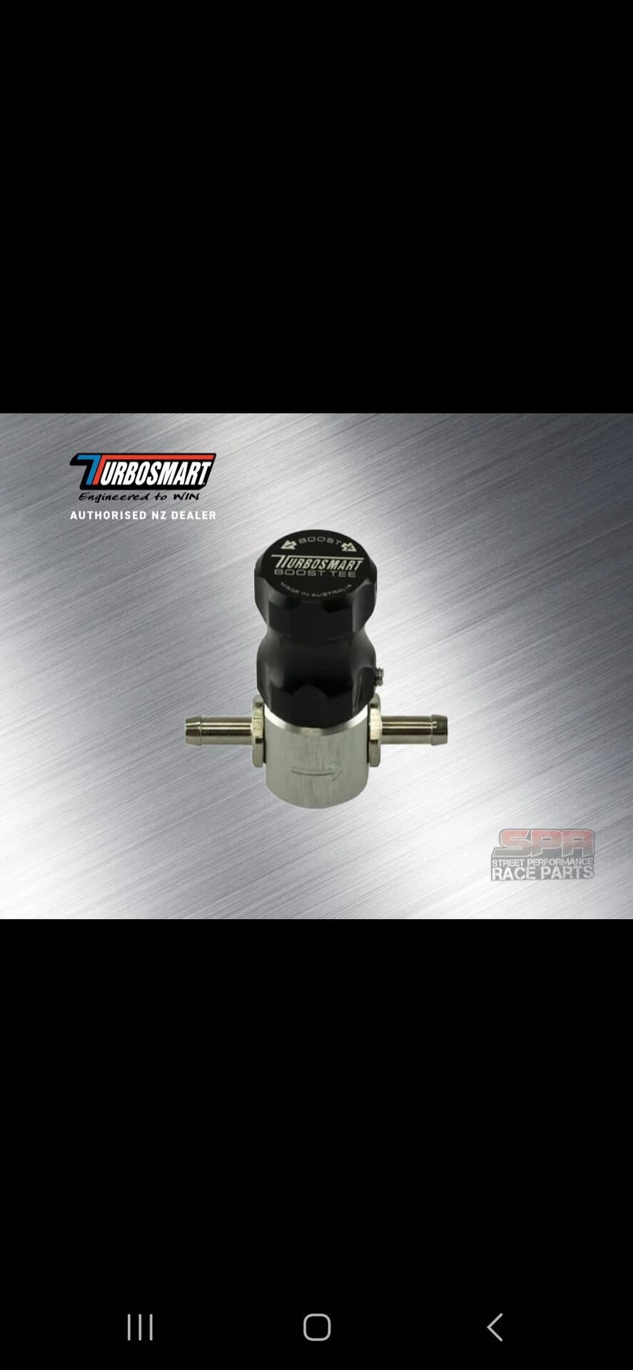

I have purchased a boost tap and am not sure where to fit it orrr if this is the right way to go to bring my EGTs down.

And post a pic of your boost tap, or tell us what it is.
Generally a boost tap will just need to be on the boost line that goes from the turbo housing to the waste gate.

Boost tap is one of the turbosmart ones as the photo shows
Just wanting to know whats the highest psi i can go and if i run extra vacum lines if this would effect the time it take for the reading to get to the wastegate (sorry dumb question)

A longer line so you can mount the boost tee won't make any difference.
At 13psi, stock turbo is pretty close to its limit. You could push it to 15psi IF you know its got no play in the shaft bearings.
Beyond 15psi, it's gonna heat the air too much and you won't gain much.
