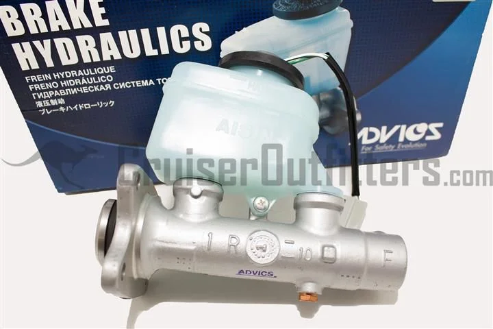

The T100 MC has a two hole mounting flange to fit a Bosch hydro booster?

I don’t think the T-100 MC is an option for me since I have a GM hydrobooster installed.
