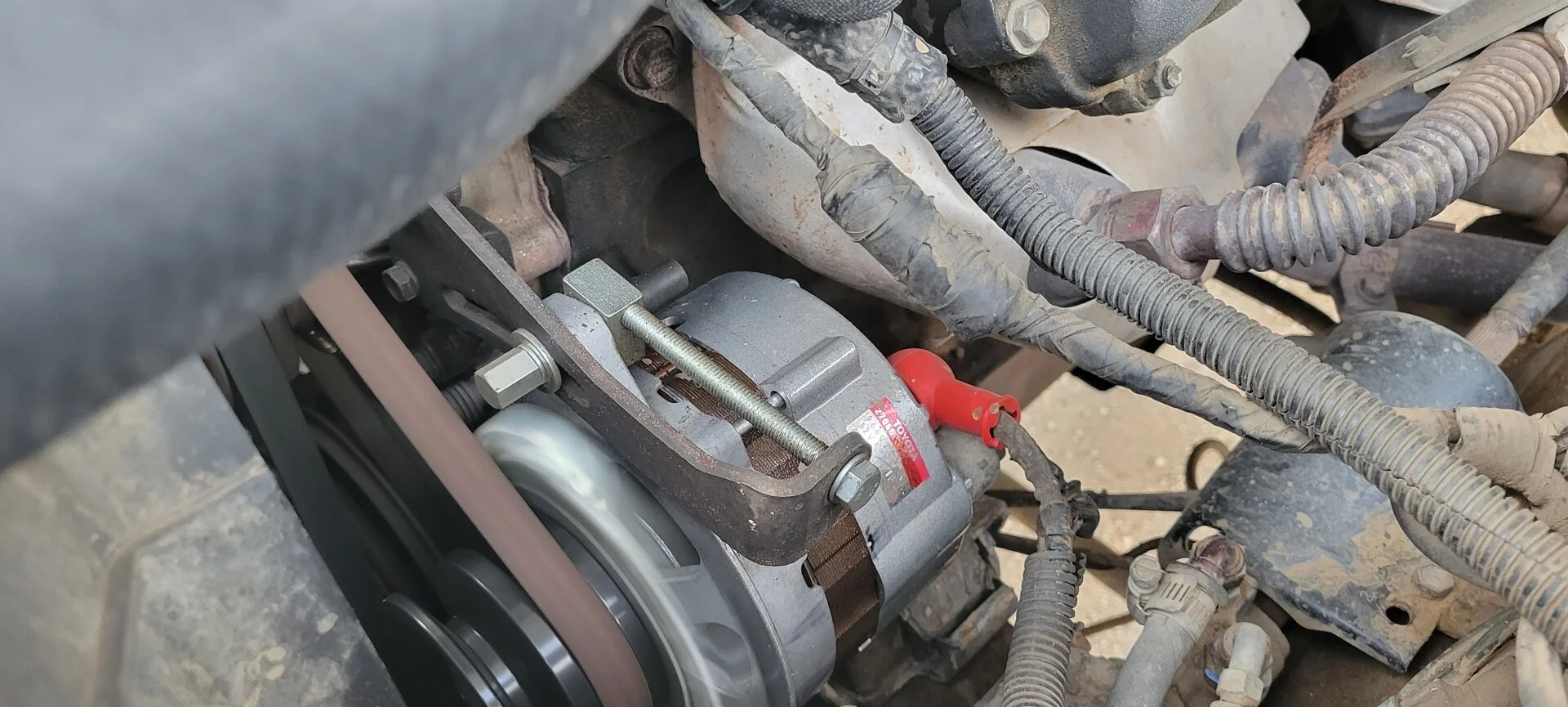

Here is a pic of the 90amp alternator installed. =)
Marco Lau, I was wondering what voltage you're alternator is outputting at idle in gear. I just installed the same unit from VintageTeqParts and it seems to be under performing at idle with any kind of additional load. i.e. headlights, heater on low, brake pressed, turn signal
Thank you
Thank you
Mine idles around 13.6-13.8 in gear with headlight and a 12v fridge running. It bumps up to around 14.1-14.2 above 2k rpm.
Thank you. What does your LC idle at in park and in gear. I feel like I'm idling a little low. (about 630-640 in park and about 600 in gear) Above 2000 rpm I get 14.0-14.1v which seems about right. Warmed up and in gear at a stop light with headlights, brakes on, turn signal on, and heater fan on one It can go as low as 12.3v. What do you guys think? Battery tests good,
It idles @ around 650 rpm in gear and a bit more in N and P. If you are getting 14 v above 2000 rpm, i wouldnt worry about it. Your idle might be a bit low, might be some vacuum leak?
Yeah. I’ll go over vacuum this weekend. Gotta get those rpm’s up a bit. Seems like 50 rpm’s can make a huge difference with the alternator.
Looked at it today. Can’t seem to find any vacuum leaks. Still having the issue. If I raise the rpm a bit by hand (around 650 in gear), alternator charges how I think it should. Hopefully I’ll be able to mess with it more this weekend.
What is your timing? You can advance it a bit to raise the rpm
I believe around 7 degrees (within factory spec). Maybe I'll bump it up a tiny bit. Do you have any issues with CA smog having it above factory specs? I may not get to it this weekend but I will continue to give updates. thank you
You can just loosen the bolt on the distributor and rotate it CC. to advance timing a bit. You will notice the RPM will increase a bit as well. This is how to adjust timing on the 3FE and no problem with SMOG that i am aware of. Also the golden screw on the intake manifold can be adjusted slightly, check the screw setting. It should be 1/4 to 1/8th turn from fully close.
Do i need to jumper the diagnostic box before or just go ahead and advance while its running and fully warm (without jumpering) ?
You don't need to jump the diagnostic box. Just advance while the motor is running and you can feel the RPM increase. Mark the location of the bolt hole in relations to the slot for reference before making the adjustment. you only need to advance timing slightly to get the RPM up.

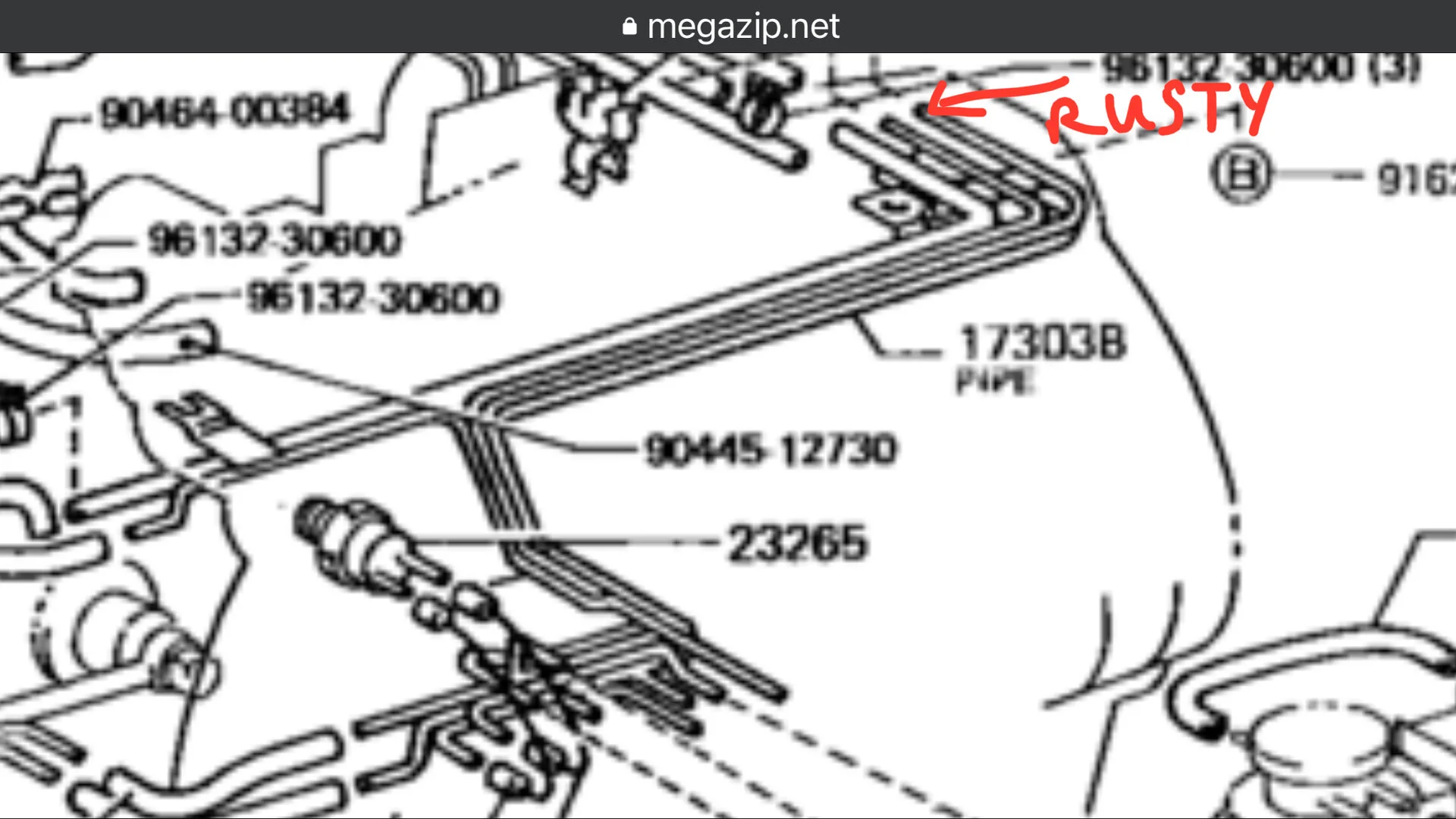

Oh I forgot to mention take a hand pump vacuum gauge to the metal vacuum lines under the throttle body and air intake. Chances are they're clogged from rust. Diaconnect the hoses and apply vac to one side of the tube, if vac does NOT rise then the metal tube is clear. I’ve already had two of mine get rusty and clog up over time.
