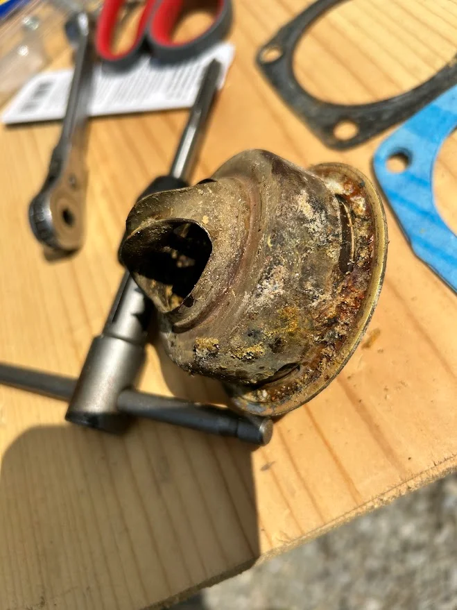

After chuch, I decided to drain the coolant, remove the thermostat and do a flush or two on the cooling system.
You know what they say about a 30 minute job? All is well until you break off a bolt. Also I found a mess. Spent all afternoon cleaning a flushing. I started with a CLR, ran the engine for 15 minutes. Drained, flushed. Then 3 more flush cycles using mixture of TIDE / Borax. I added a 50/50 mix of green anti freeze.

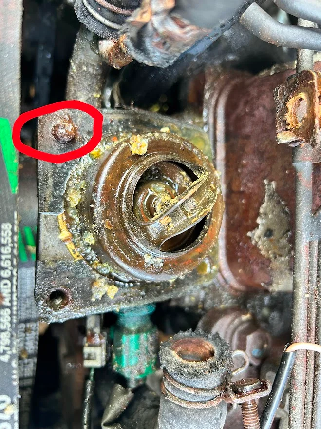

The broken bolt. I attempted to weld a nut on the "nub" 4 times, no go. Had to go to NAPA to get a Tap. Drilled it out, picked out the pieces of the bolt, then re-tapped the hole. Turned out good. Had to use a hardware store bolt for now. I'll order 4 new bolts for long term. It's all got to come out anyway when the head comes off.

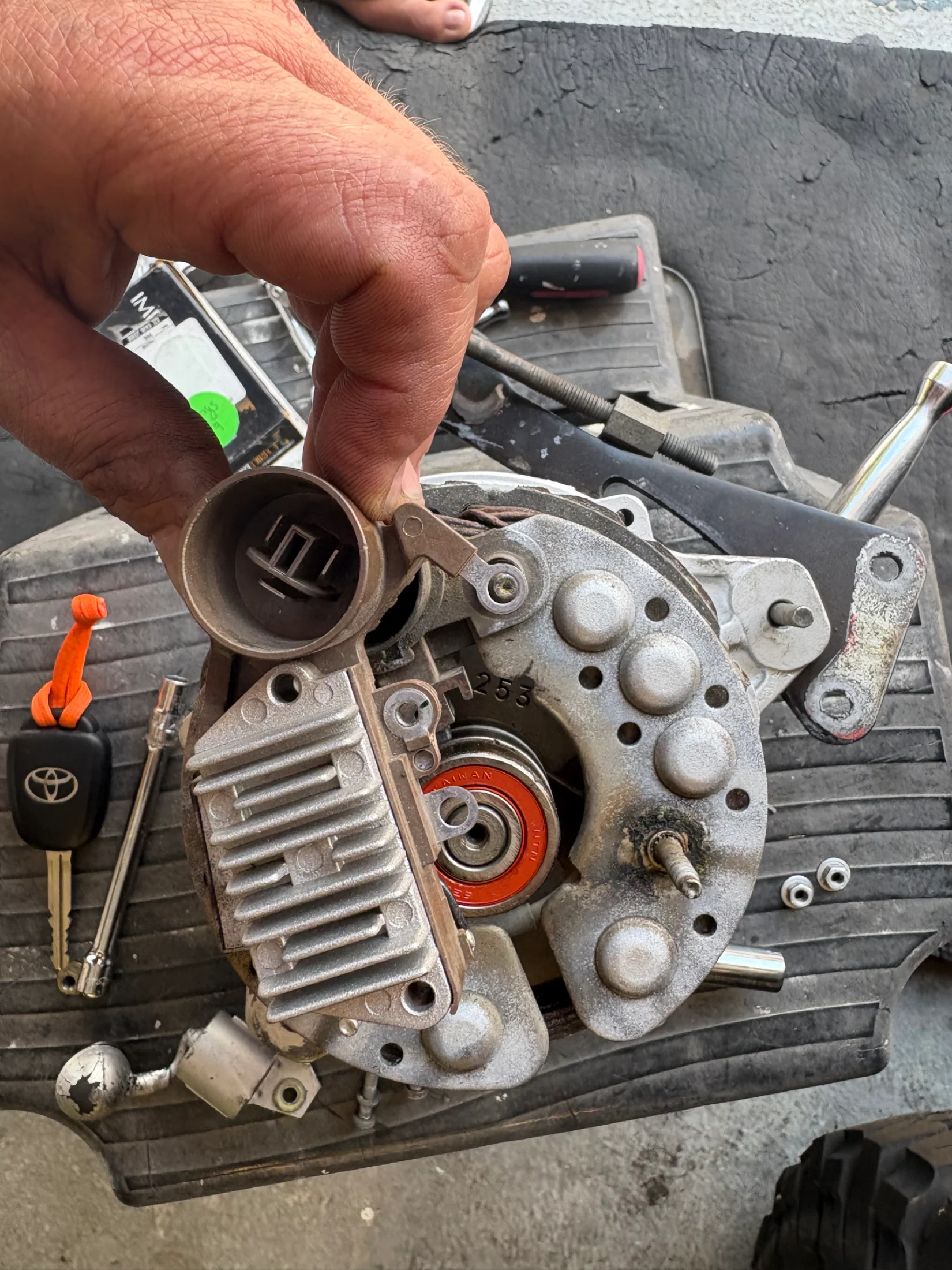

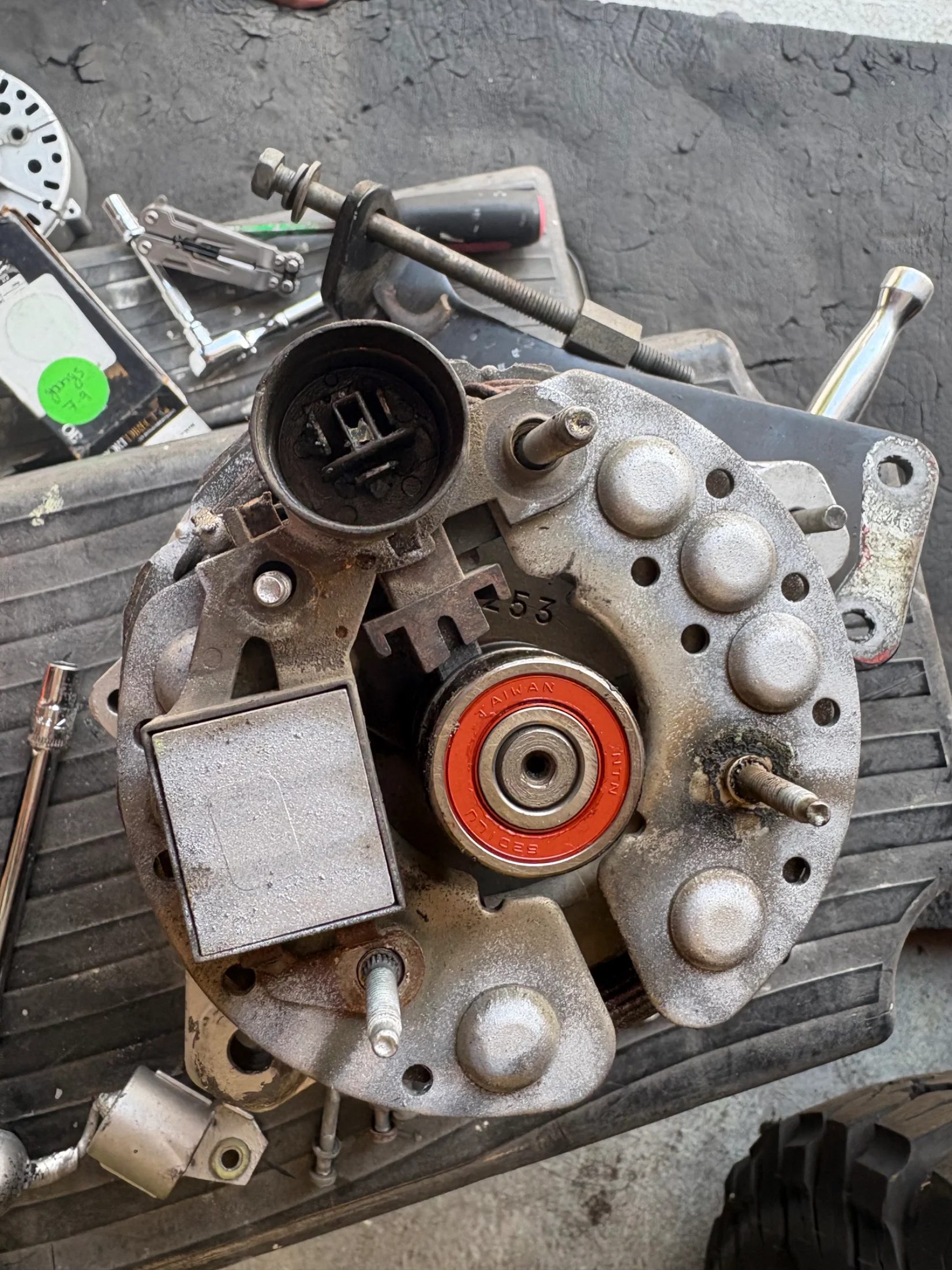

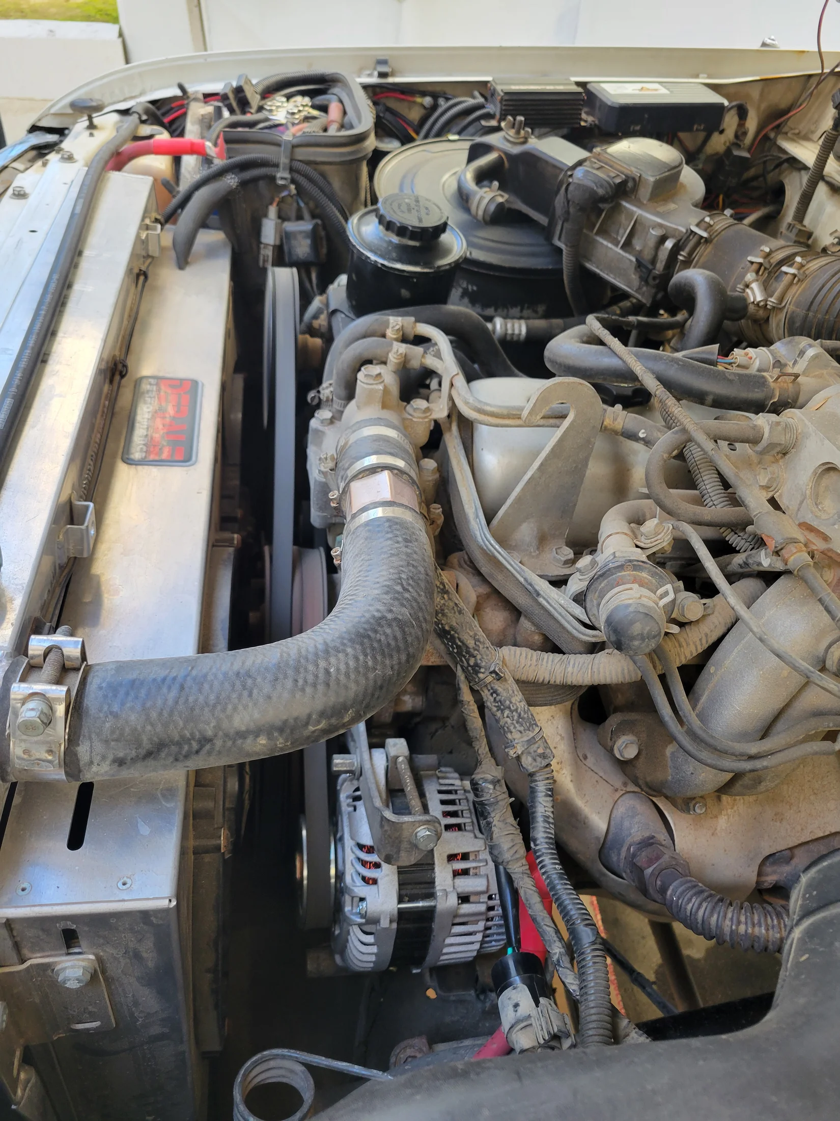

Also, went to put in a new voltage regulator in my alternator this weekend. It’s a Denso, external fan 80amp. I picked up an 80amp regulator, but it didn’t fit, none of the posts holes line up. I looked up a picture, and it appears it’s a 90amp regulator currently installed.
what was wrong with the regulator before? How was a bad regulator affect your voltage reading? etc?

Hey man, I was getting a bunch of dash lights, and my battery voltage gage was spiking. I ended up just getting a new Ultama alternator, sorry to the Toyota purists. I couldn’t find a Denso unit. I’ll try and install it this weekend.
A buddy of mine (ASE mechanic) suggested that it was probably the voltage regulator.
Either way, I’m hoping this new alternator solves my issues.
I am running a 150 amp Nissan alternator in the 3F-E, and it is awesome.
Nice! How much fabrication did you have to do in order to get that to work?

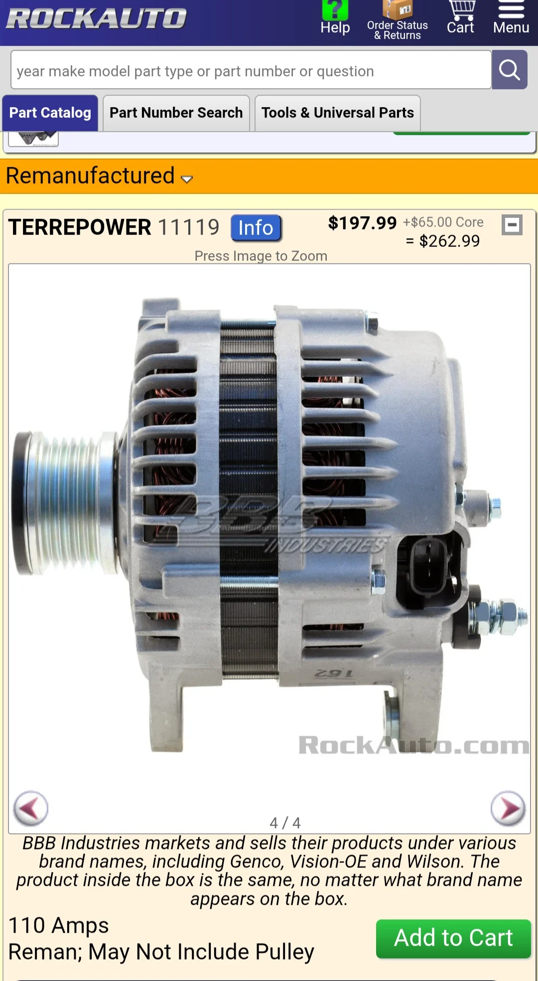

Curious of this too, I looked at the Nissan higher amp alternators and found stateside its easy to get 110-130 amp one that fit mid 00s 4cyl frontiers with the same mounting as the 150amp diesel aussie one that's been listed in links.
Looks like a pulley swap and harness plug but can't tell how the lower mount works with the 80amp fj80 bracket. I looked at 1GR alternators because toyota (and I have a spare) but the lower mounting ears are too close together.
2013 frontier 4cyl shown.
You will need to upgrade your big 3 wires, a pulley to accept the belt, aftermarket fuse block, brackets, adaptor plug, etc. If you reuse your factory bracket, some shimming will be required to get the unit to align, etc. Honestly, if you are keeping the factory fan clutch, there is no reasons for this upgrade. I am running a fan controller and elec. fans setup to justify such demand.

I had a bunch of cluster lights illuminated. Also my clusters battery voltage was spiking. Just got done with the new alternator. No more dash lights.

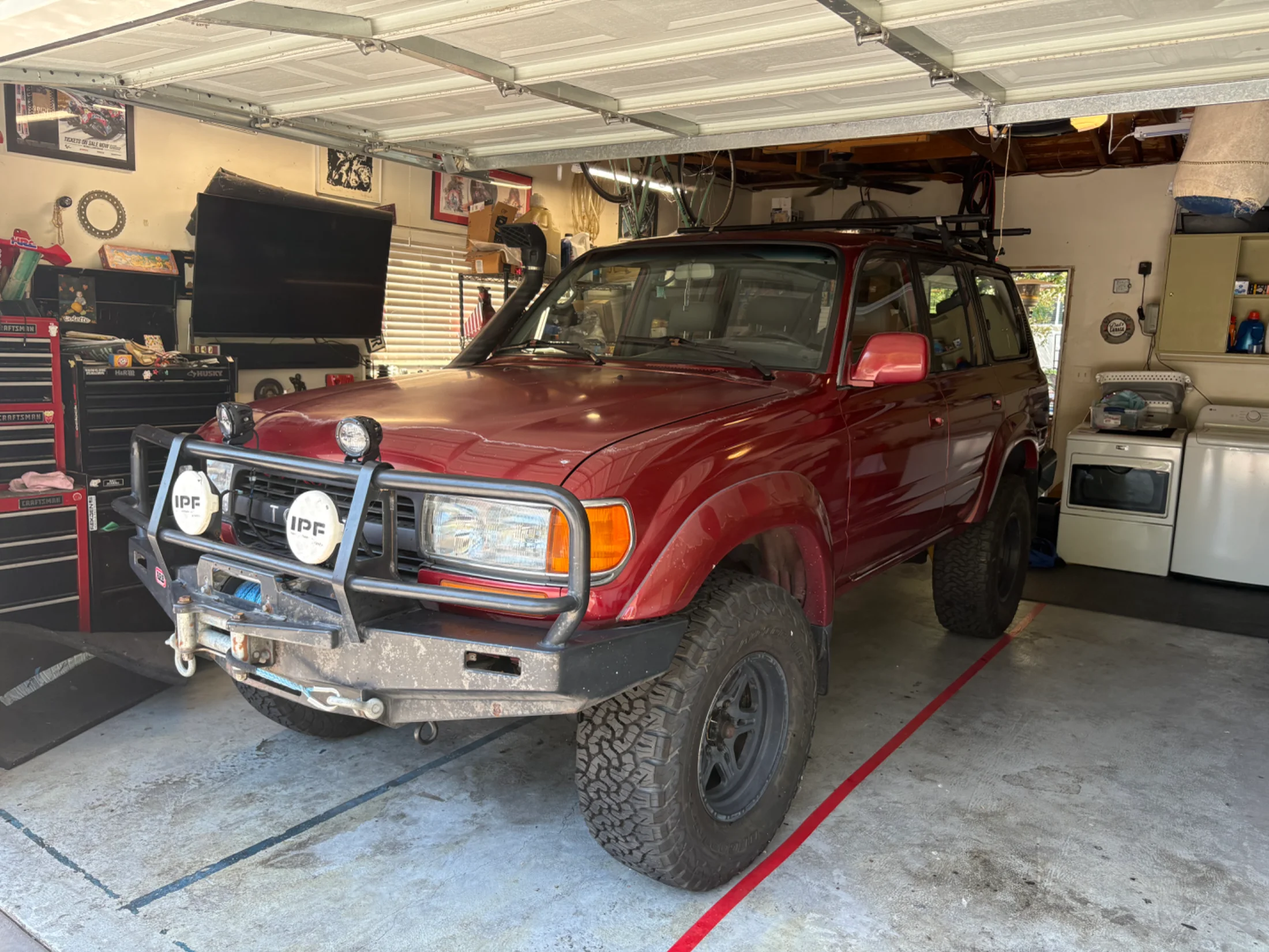

Hi All
I have a '92 with a 3fe, 230k miles.
Mods: Desmogged
35" tires
Rear locker
3" OME lift
Got her set up for camping for two, aluminum roof rack, sleeping in the back - need some good mattress recs for the back area.
Located on the Big Island, if there's anyone on here located on island HMU!
Not unhappy with the power that she has, all the 3fe hate seems misguided and snobby.

You hate the power the might 3FE makes? I'm running 33's and would like to run 35's, but that's like adding 400lbs more for the engine to move. Love the color combo I have the grey and blue color combo on my 91.
