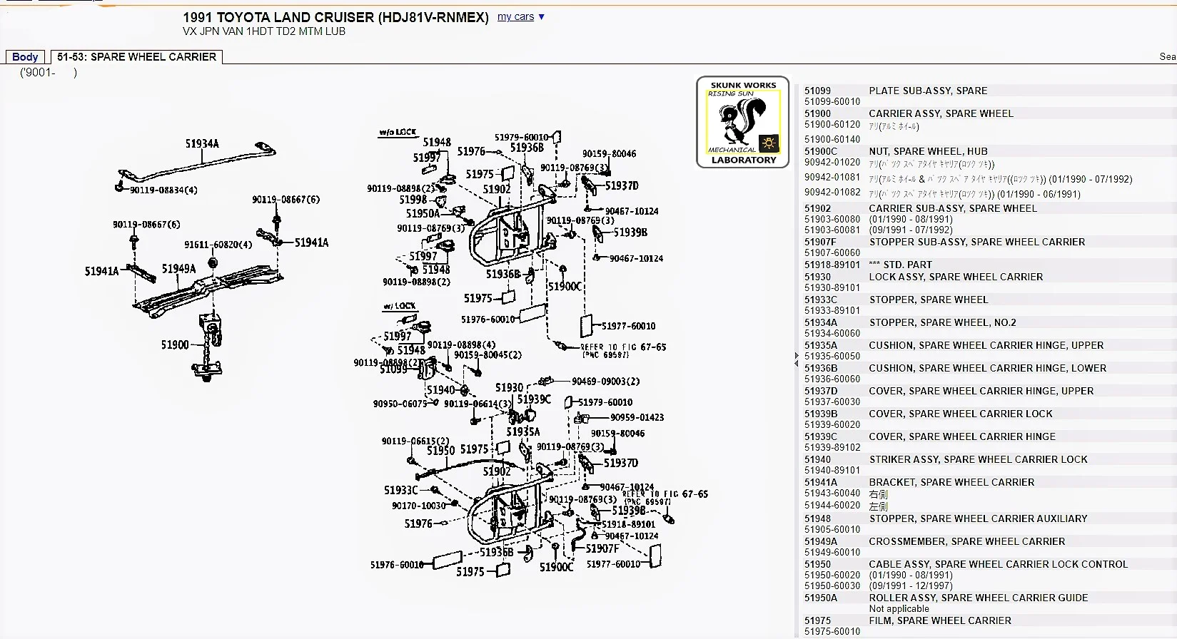

1 looked up a japan market VX Turbo MTM 1991 HDJ81V-RNMEX and this might help answer your question ?
Right on. Thanks Matt. I was hoping for some weird one off. The pictures in your previous post don't show the swing out. Check for a PM frome as well, please.

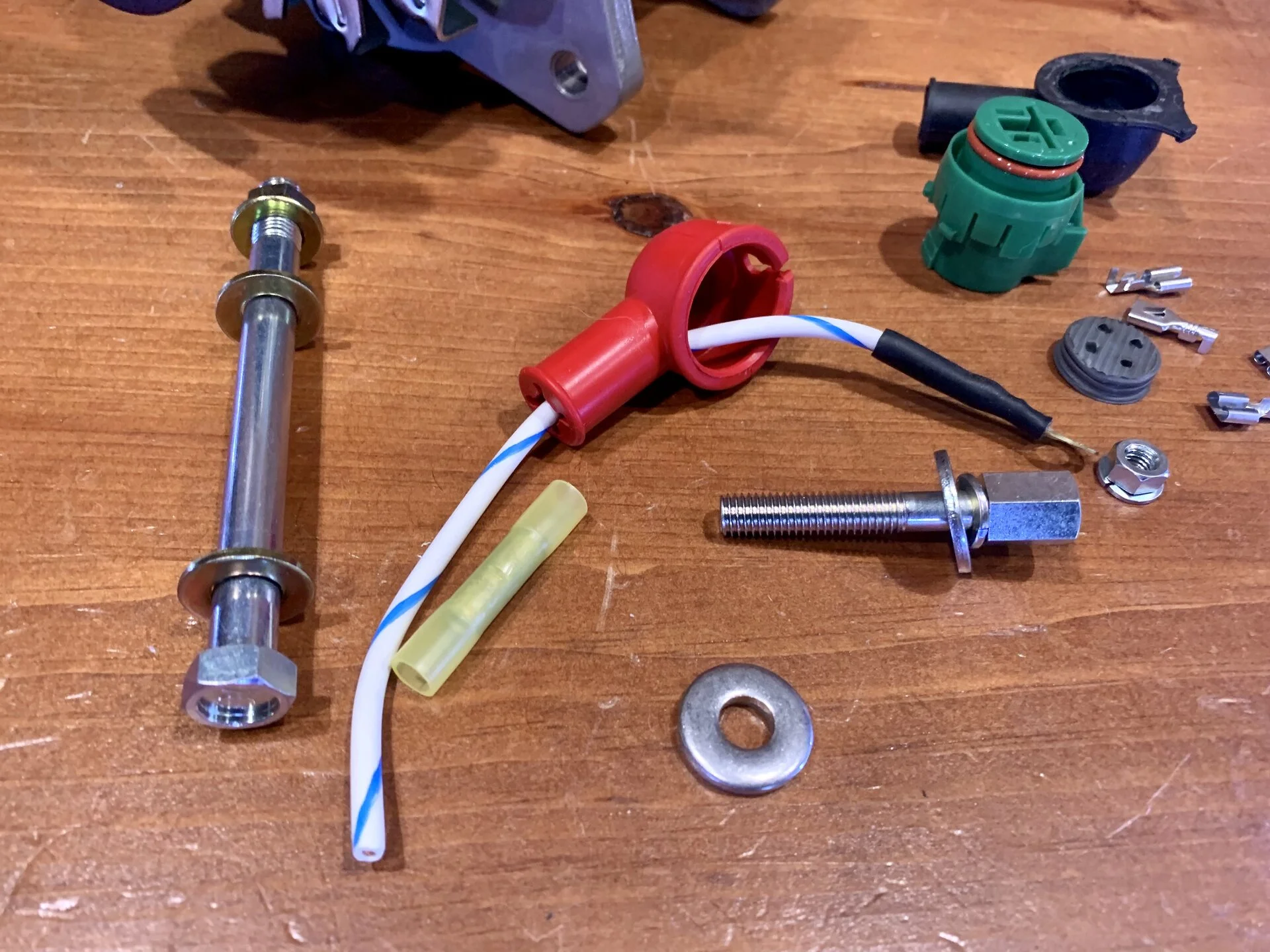

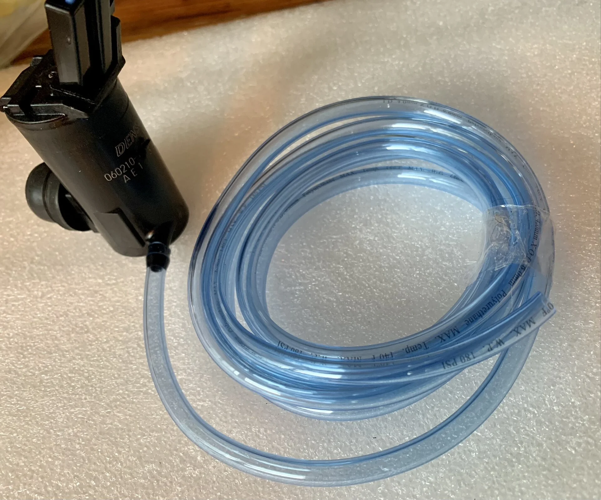

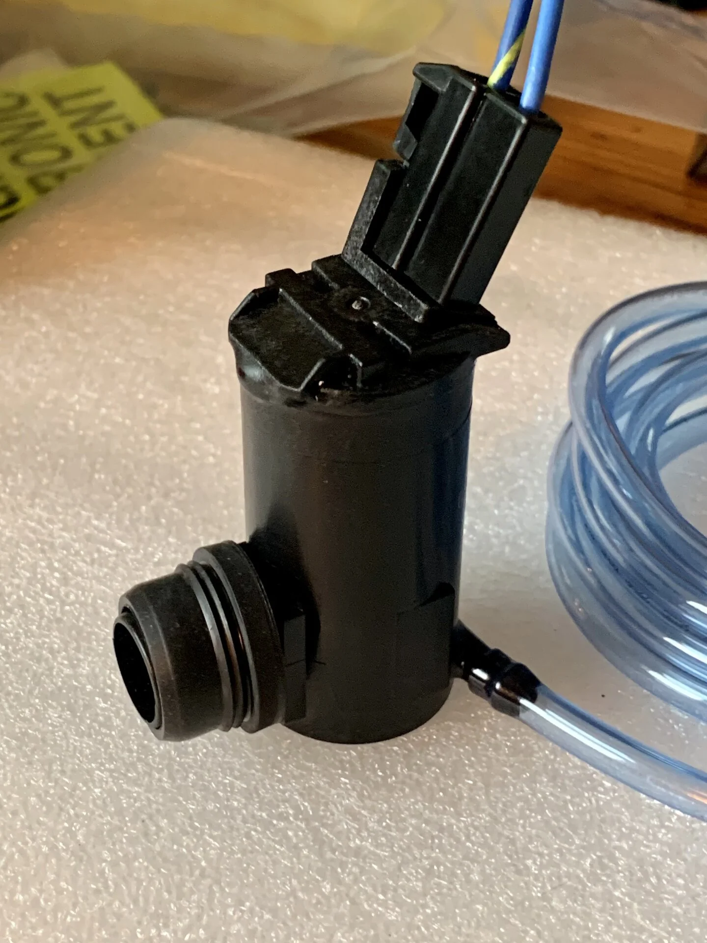

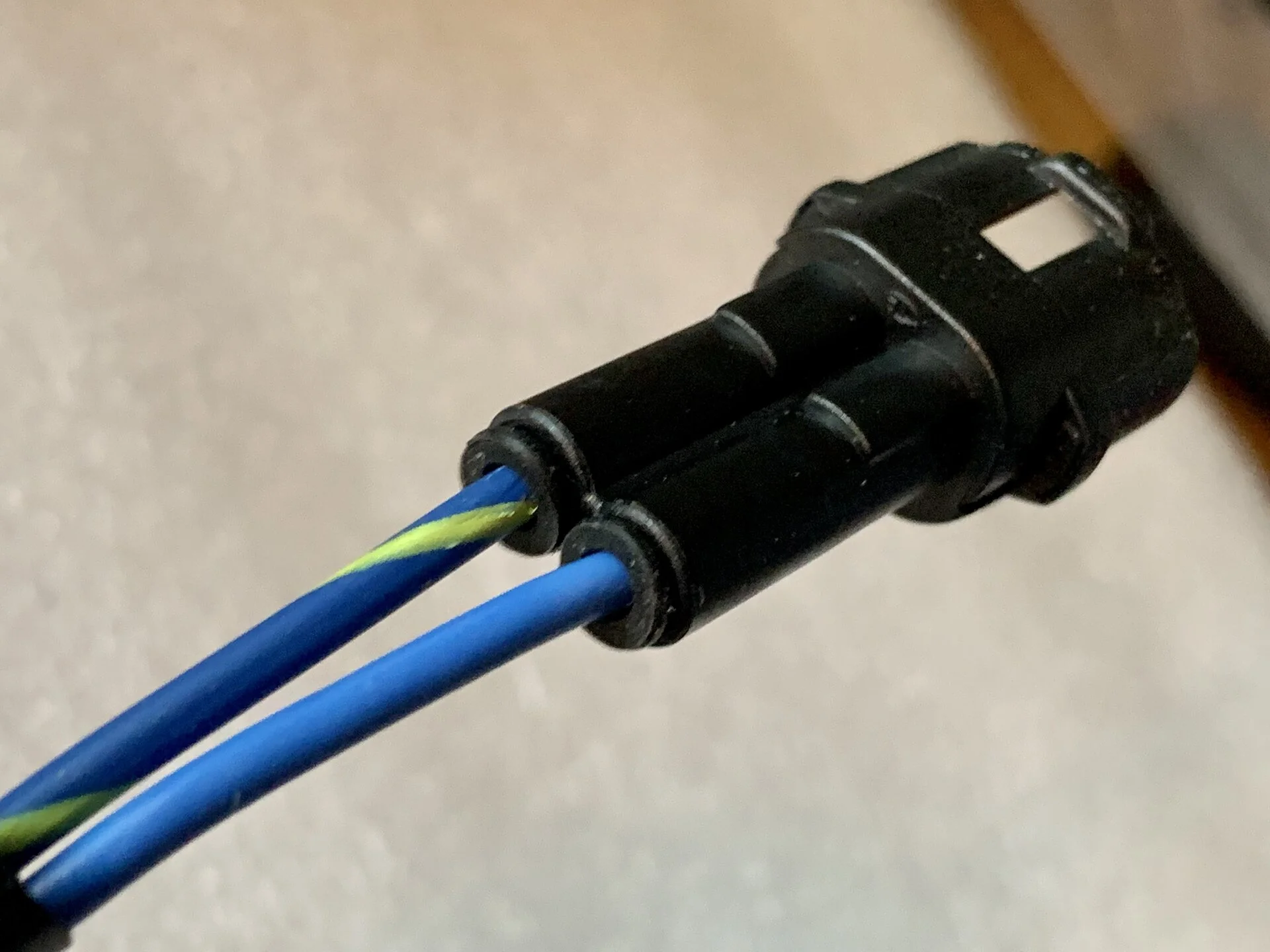

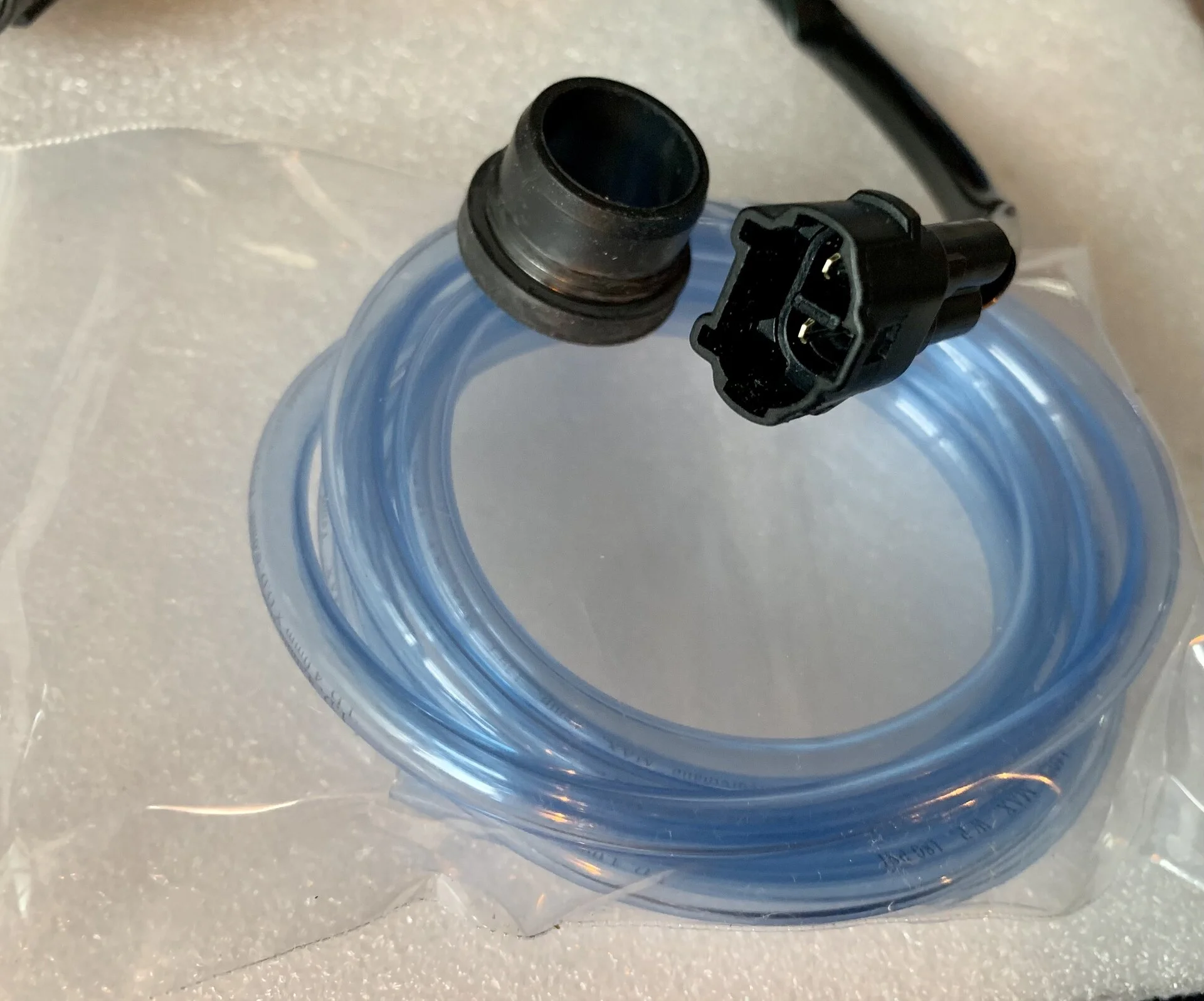

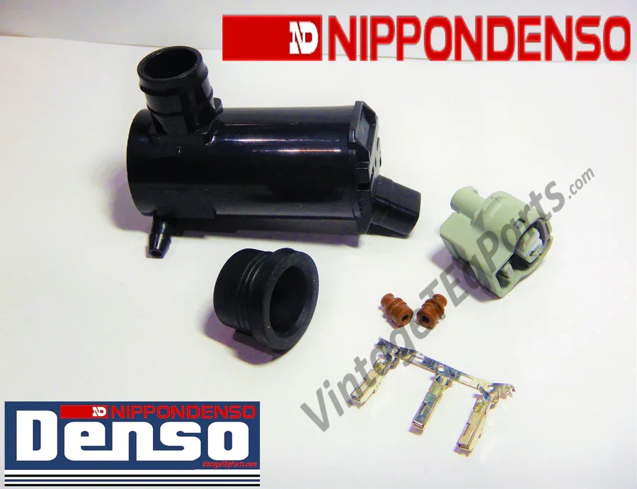

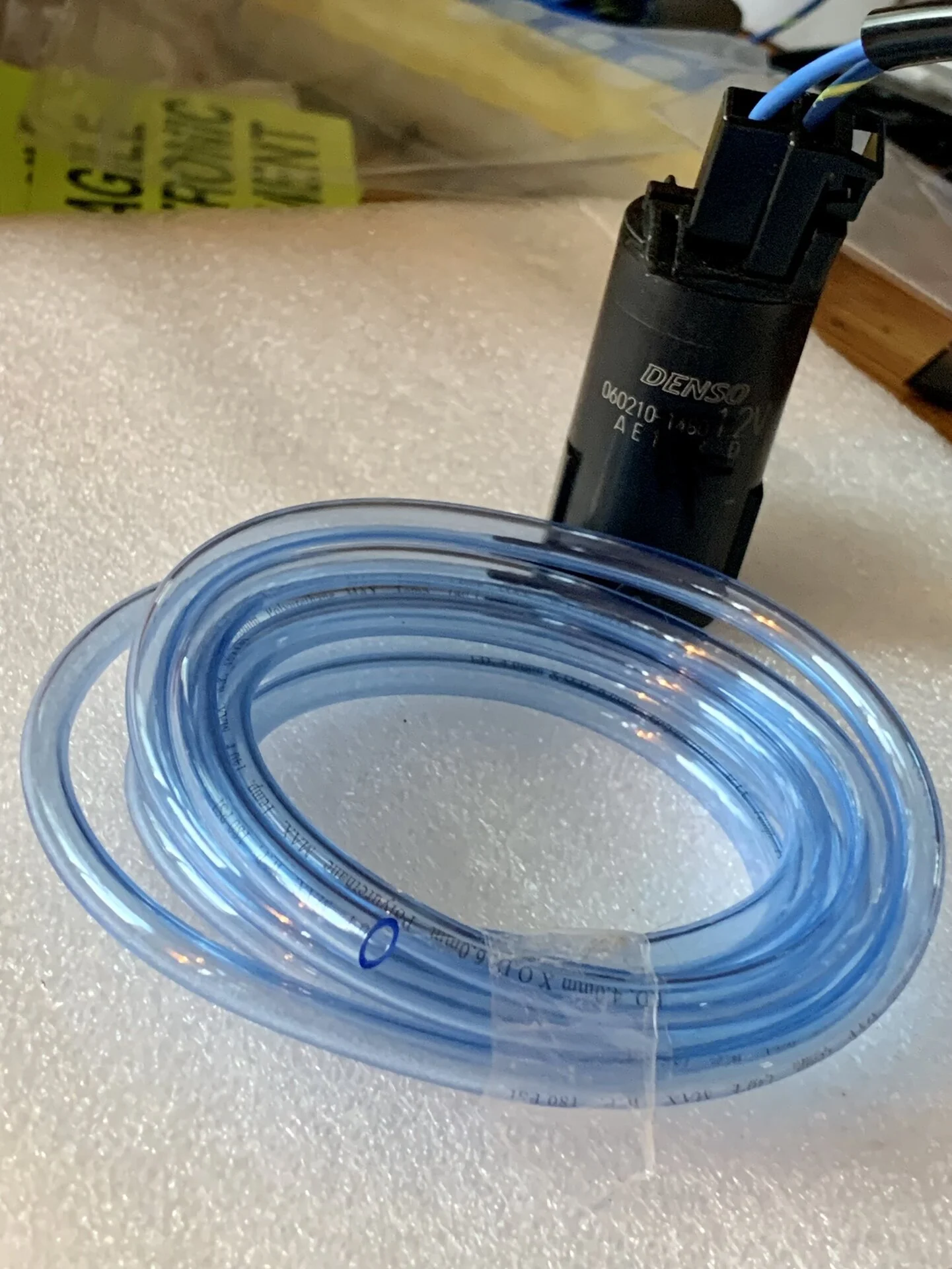

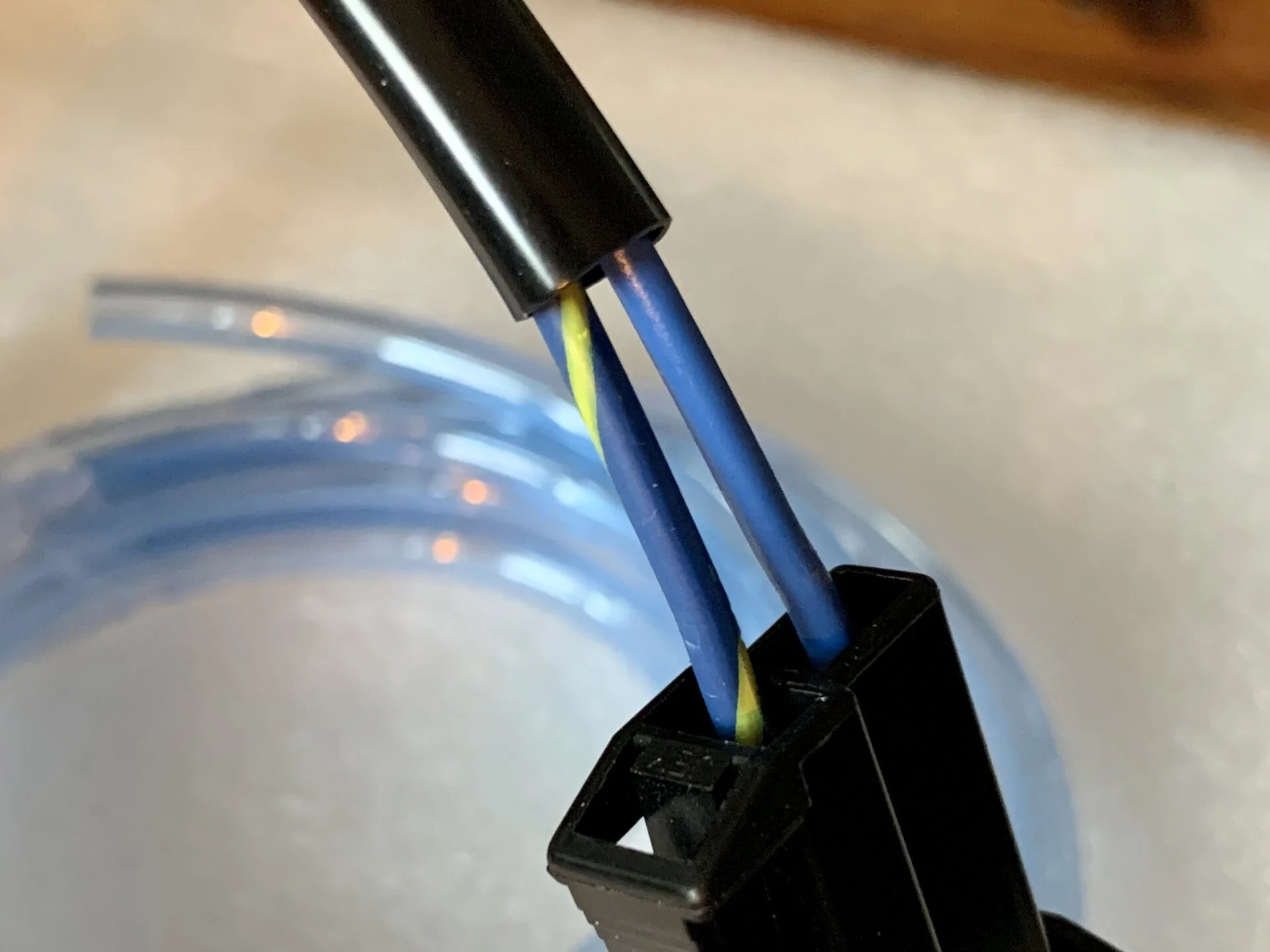

85340-60040 Rear Washer Pump assy. 91-92 FJ80 3FE Lives Once Again. …
Not much longer now ….

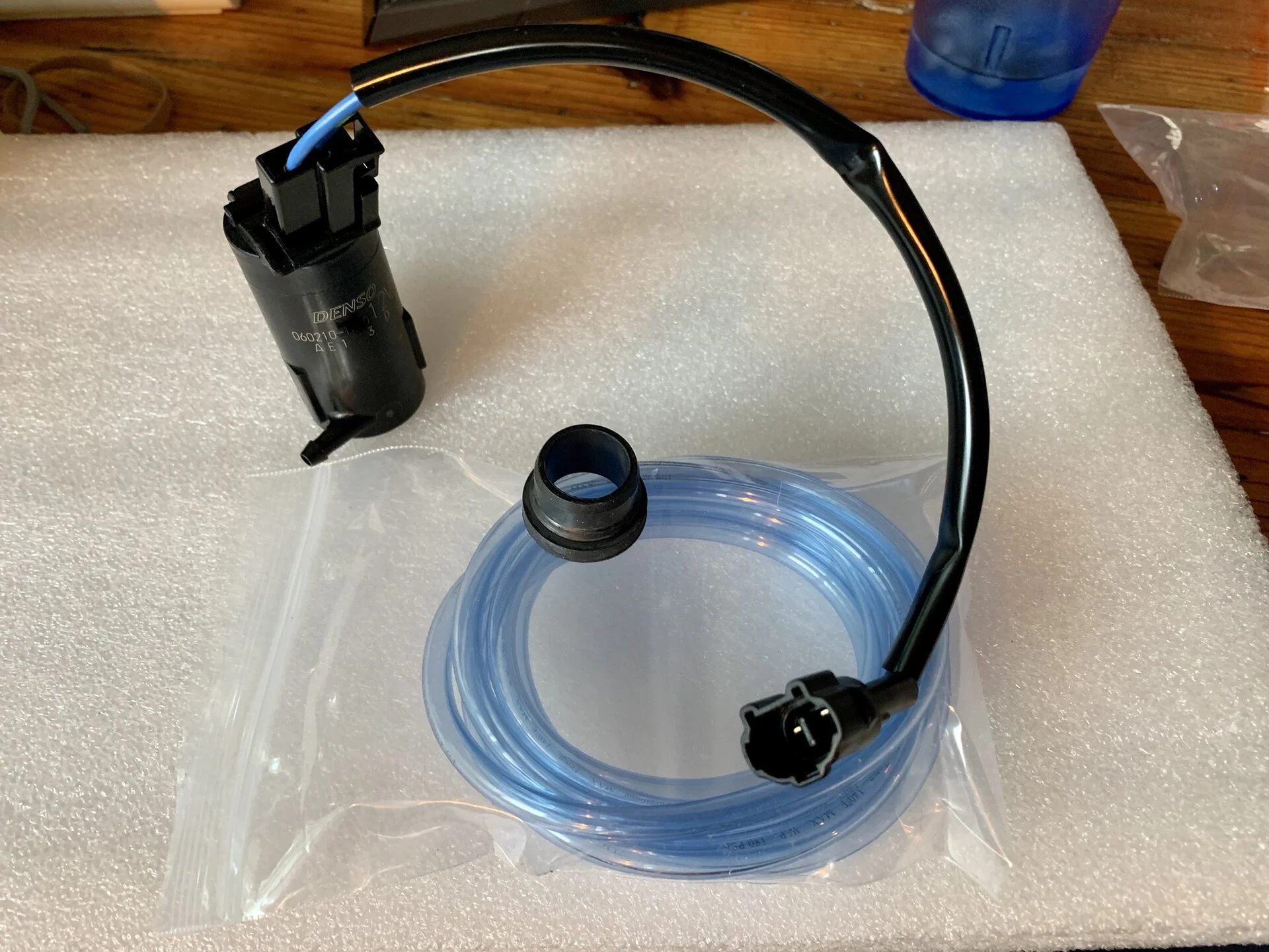

This is a FJ80 3FE specific only set up …
Im running 2 OEM NipponDenso pumps that have a higher PSI and volume spec. then the original factory installed ones
I’m including a refresh / repair OEM grey female connector w / extra terminals too ,
The rear washer pump is of course plug and play
I did make the pigtail about 2-3” inches longer for a ease of swap out and a forgiveness factor too

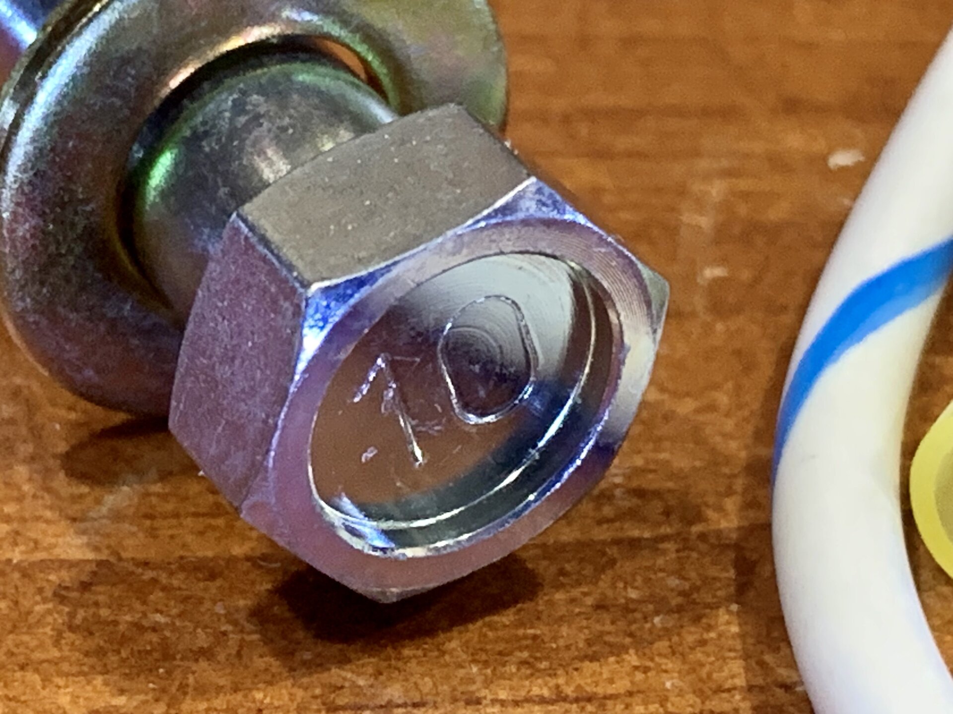

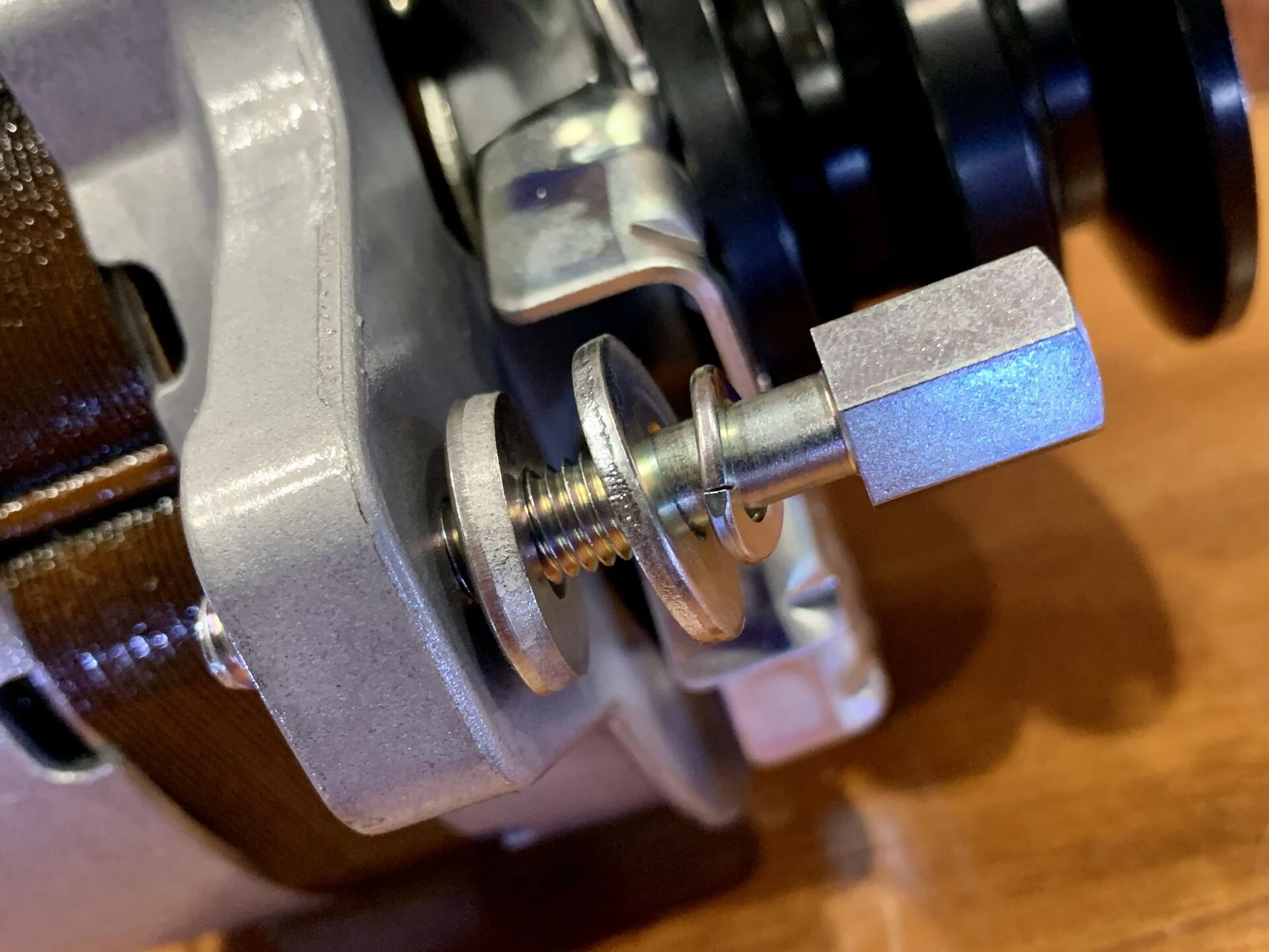

Silver Violet Plated #8 mark heads highest salt spray rating SEMS double. washers mounting bolts too..
I decided in addition to our SNOW VERSION decal , a retro bow to a 3FE equipped FJ62 washer bottle decal adorns the top of the tank to remind all there is a 3FE history topic here too 😎

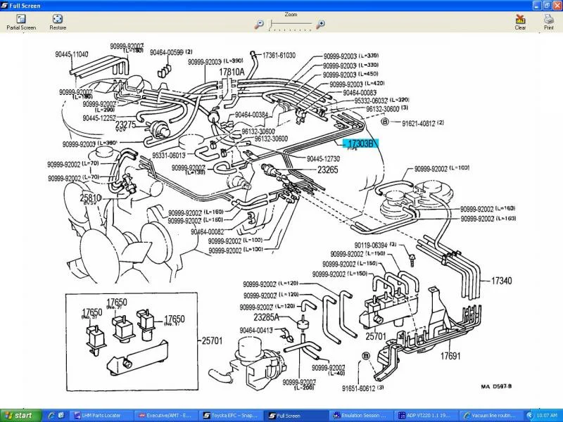

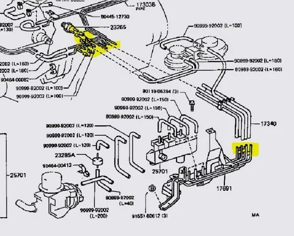

Do one at a time and spray throttle body cleaner into the two vacuum ports on top of the throttle body. Go to your stealership and order lines there, its not too much and will last for 20 years. 3.5 and 5.5 again dont buy anything but toyota for this one.
WOW! Thanks for the help, I had the engine de-smogged last year. I have an odd low idle problem every now and then, someone recommend chaining all the hoses. worth a shot! Thanks again!
Low rpm or osillating idle is a clogged vacuum input on the two hard lines on top of the throttle body. Grab a needle clammped in a pair of needle nose pliers to reach it, remove the intake hose and poke out the carbon on the inside top of the throttle body, then spray out with MAF cleaner.

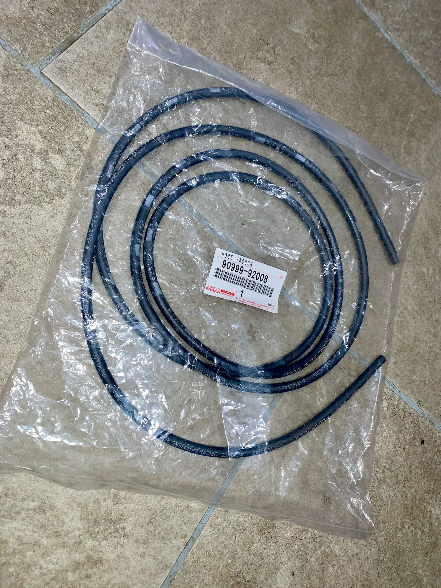

Has anyone ever replaced all the vacuum lines on their 3FE? Are all the line 3.5 and 7.0 inside diameter?

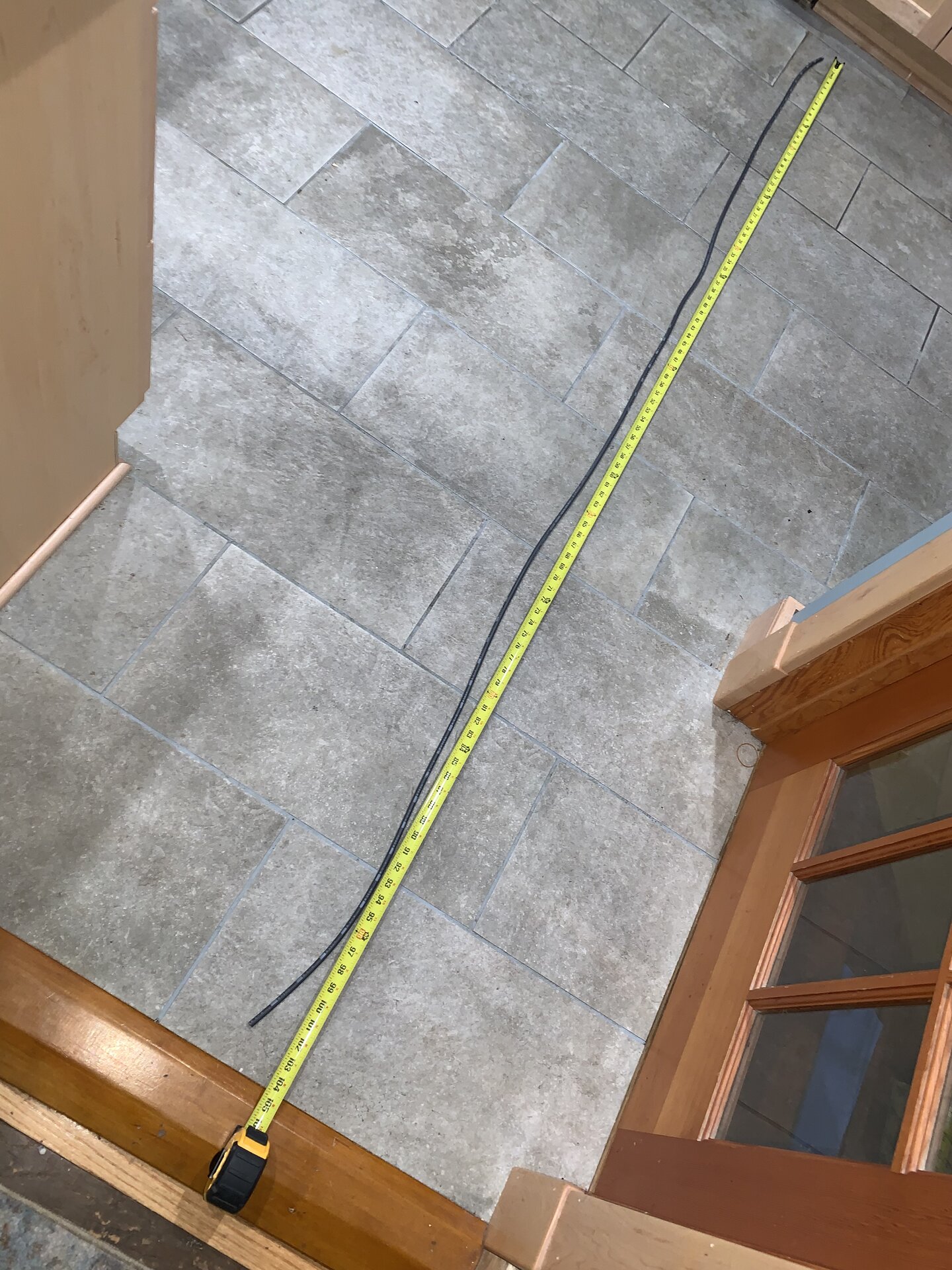

This is what you need and the best bang for your buck too , at over 8’ feet long there is a ZERO waist or drops that you trim off each smaller section if you were to piece meal it together that way .
and yes , only do one single line at one single time end to end …
If you don’t you will know why you didn’t in the first place fast 💨
