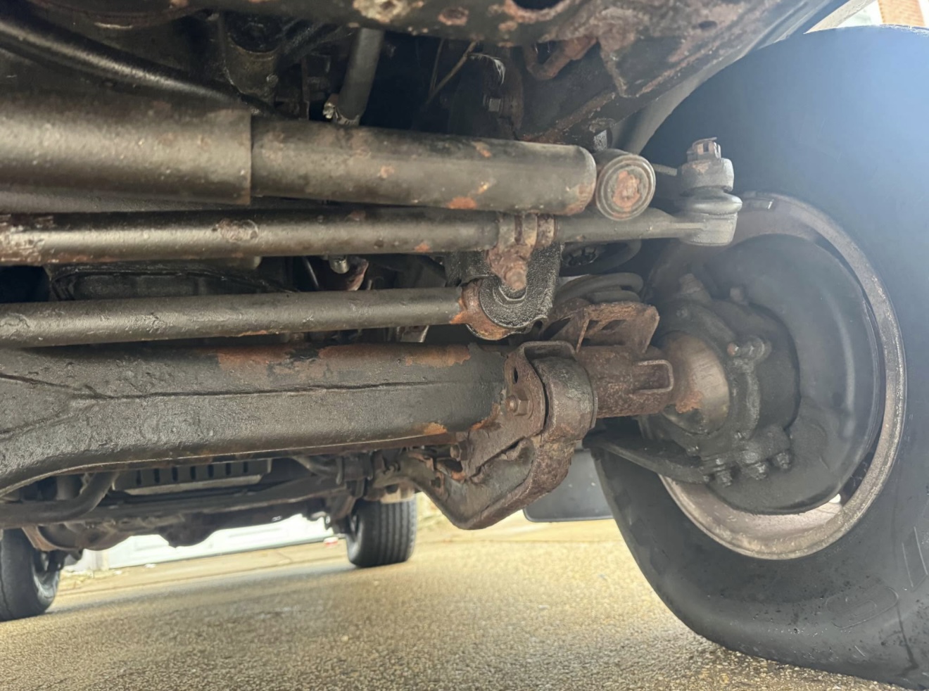

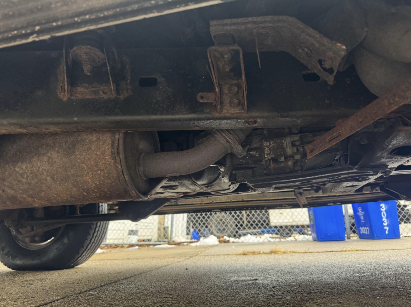

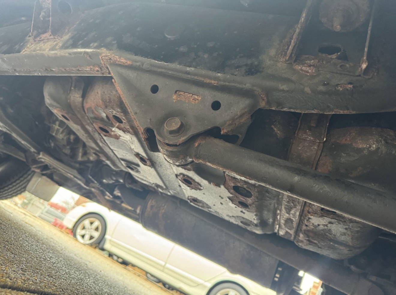

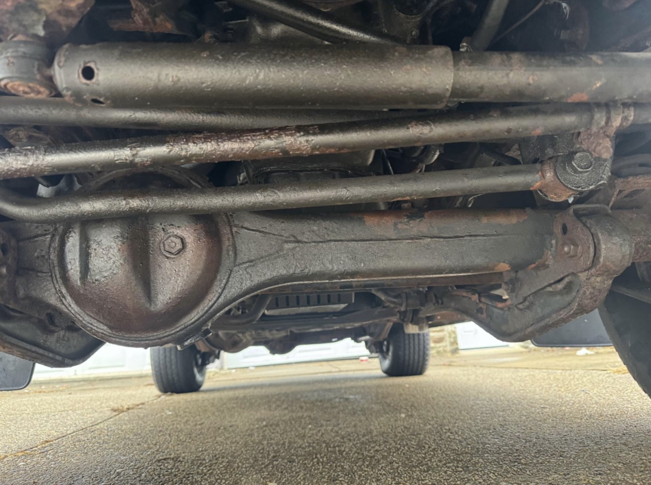

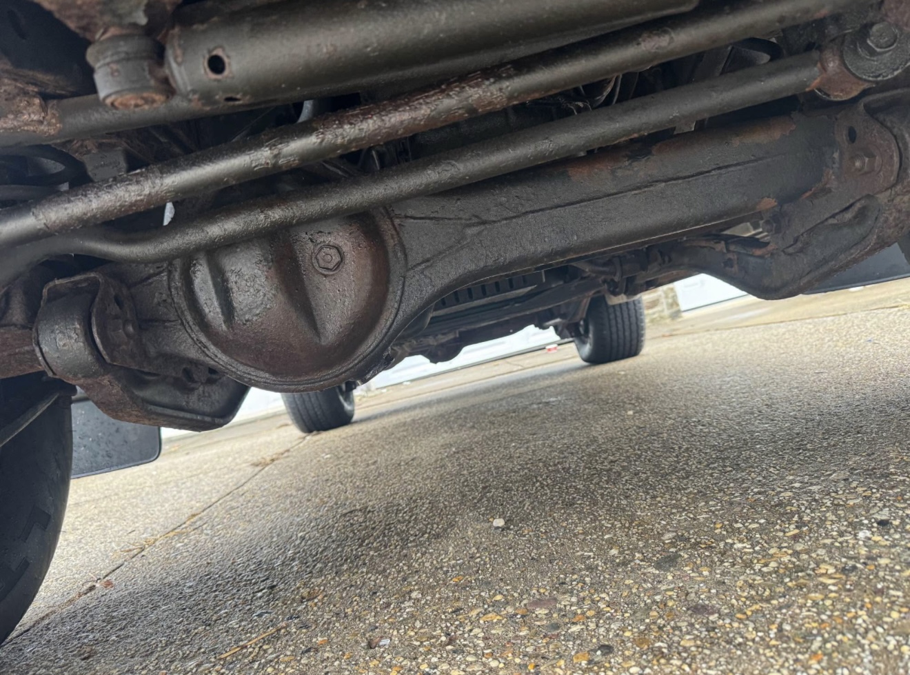

I found a LC near me that needs little work and I wanted to know how bad the rust is! It needs a power steering pump, ac compressor and an exhaust system. Is it worth $4.5?
It’s triple locked with 180k miles
Crusty. Move on.

Well...
A couple of thoughts...
First, mileage is irrelevant. All rubber (hoses, seals, Bushings, etc.) are old and on their way out.
Second, and most important, you need to honestly come up with what your use case is, i.e. what do you need/want. And, how much is it worth to you?
I know it's a long (and getting longer) wait to find a rust free vehicle, but it's SO worth it. If it was me...
Maybe if I found a non-locked rust free vehicle, I might get this one for parts. Especially if I could get it a bit cheaper.
That said my use case is to have a new (old) dependable beast which means I'd be spending at least 10 grand on a complete engine rebuild as well as new: alternator, PS pump, starter, brakes, Bushings, etc. Doing it all DIY. That 10 grand doesn't last long.
End result is IMO, better than a new bronco, or heaven forbid, a 250prado.
Happy trails
IMHO, you need to take photos of where rust is a known problem. I mean, you took multiple pictures of the front axle, and none of the rear.
Most of the 80 series rust occurs towards the back of the vehicle...
Last few rear frame crossmembers, especially the one inside the rear bumper.
Spare tire area.
Front and back of the rear axle
Lower sheet metal panels behind and in front of the rear wheels where the seat belt anchors.
Floor sheet metal to the left of the driver's brake pedal. It is under the foot rest but pull up the carpet to check.
Rocker panels.
Upper rear hatch
Rear Window frames.
In the end, you want a good frame, good sheet metal and two good axles.
What model/year is that 80 Series?
How is the interior?
How is the paint (fading, peeling, any paint "bubbles")
Any hints that the head gasket has issues? (overheating, funky radiator fluid, has the owner used any head gasket or block sealer?)
A couple of tires appear underinflated, says something about the maintenance (or lack thereof).
We need a lot more photos to give a better opinion.
Been discussed so many times, best route might be to ask the seller if you can have it inspected but take it first to body shop, preferably one with a lift,
and ask them to check it for rust but ask for an actual estimate for rust repairs and ask if it will pass a State Inspection.
Then take it to a mechanic who can take his time and ask him to put it up on a lift, ask him to look for rust and mechanical issues including tests of the cooling system/head gasket. Will cost some money but you'll have something to go on.
You cannot assume the AC system is just a compressor issue, very likely it's more than that ie: $1500+ for repairs.
Otherwise we're all just guessing.
The main thing to consider, you and the vehicle are in Pennsylvania, one of the worst areas in the US for rust IMO. So either deal with what's available locally
or find one in a dry/salt free state, then fly out, drive it back, but have the vehicle professionally rust proofed inside and out before the first winter in PA.
If you have to ask, you already know the answer. So sad that this example could have been avoided with a simple application of fluid film/woolwax etc…

I'm in Kentucky, similar vehicles down here. The pic's you shared wouldn't scare me too much. You need to think about the areas pointed out on some of these reply posts. Also check the body behind the rear axles up behind the where the spare tire would be. Think about the brake lines, fuel lines ect..... My 92 is similar, I plan on many hours of rust removal, removing parts to clean and replacing those fuel and brake lines. Replacing brake hardware ect....
I paid 3k for mine. 156k miles, bad radiator, questionable head gasket. I'm looking forward to getting to work restoring it. I'm going into retirement next year, so I'll have time to dedicate to it. Eventually it will be my daily driver for local activities such as runs to the hardware store and local fishing hole.
