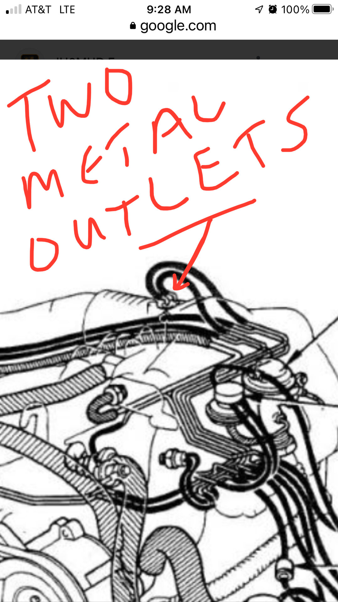

Are the two vents on top of ur throttle body ckear? Check with a vac pump, if not spray cleaner thru them after u poke out the crud from the inside with a needle held by needle nose vise grips.

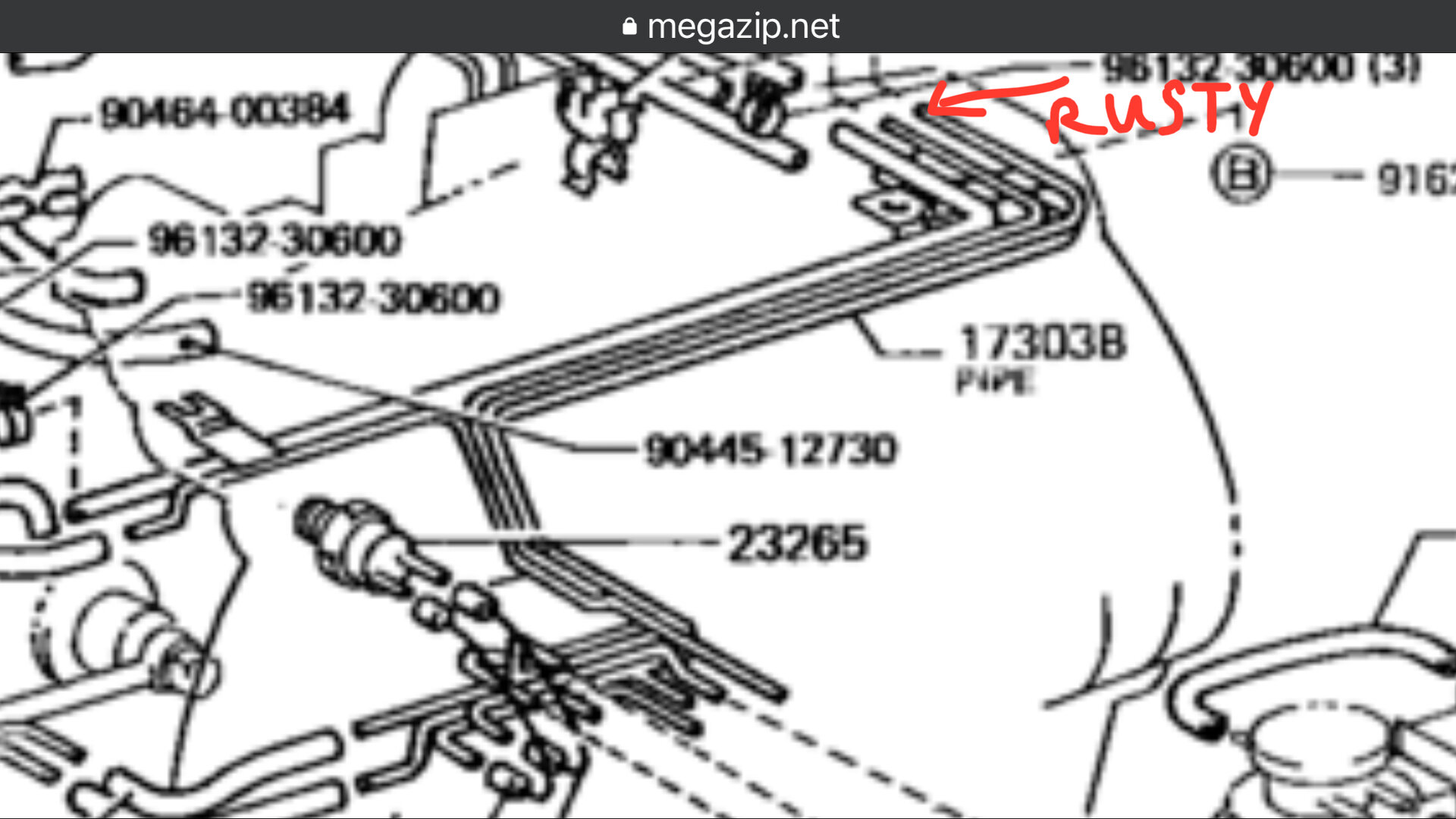

And check the metal lines under the intake to make sure theyre clear of rust / restrictions
