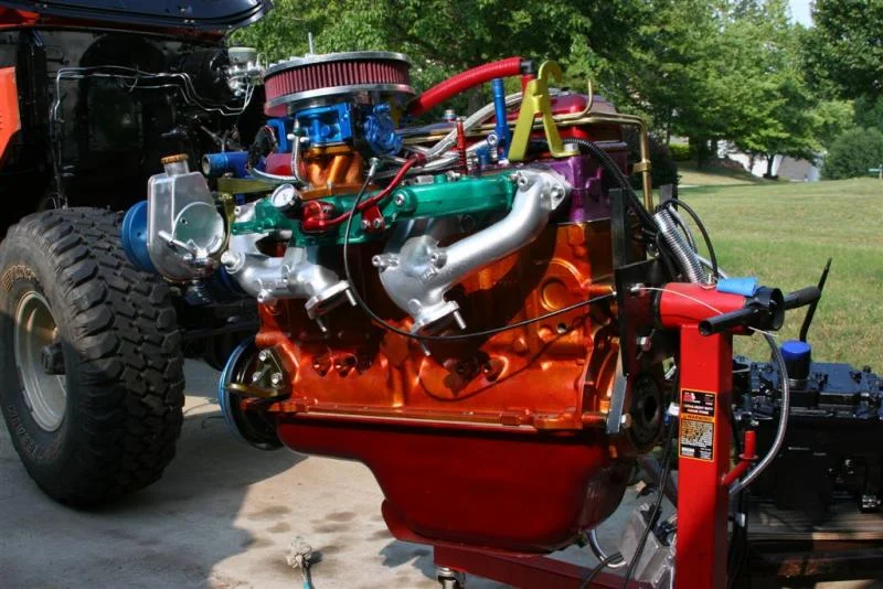

seen about 4 posts stating it is do-able, even refrence to a Toyota Trails article on the mod, can anyone confirm that even with some grinding the 3FE exhausts will mate to a 2F head with a 2F intake and carb? Thank you
Yes. Big Gay has a set on it. You have to remove a small amount of the manifold where they touch but nothing that causes a problem.
:bounce::bounce::bounce:I knnnnew it! I just wasn't willing to strip em off the wifes 62 to see:hillbilly: set will be on its way;) thank you

Less warpage, better flow.
Less warpage, better flow...

the modified FJ62 exhaust manifolds go onto the 2F today, along with the modified 2F intake. all three pieces have been MILLED- not sanded, for flatness and the mounting ear thicknesses are within about 5 thousandths of each other.
I have some pics posted in the 60 series section here>>> https://forum.ih8mud.com/60-series-wagons/748108-3fe-xaust-mans-2f-head-carbd-intake.html.
I crossposted because of the tech wall betwixt the 40/55 crew and them youngsters in the 60 series section- ...
