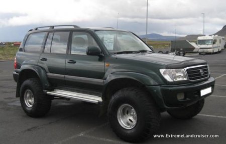

For the most part it is a pretty unrealistic endeavor. But, not impossible. You will need to either do a SAS, have a custom lift designed like those that Extreme Landcruiser does. http://extremelandcruiser.com/store/index.php?main_page=index&manufacturers_id=18 (another bag of worms in itself) or something like a 100 series body on an 80 series frame....

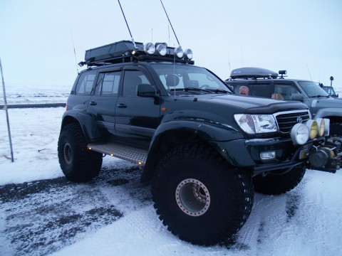

Just looking at the clearance with 35's and trying to get an additional 1" clearance (2" diameter) on the front, I would think one would need to cut/reshape the firewall/footwell back a little, lose or relocate the washer bottle & 2" body lift.
The rears should fit 37's fairly easily. I don't believe there are rear drop-in aftermarket 5.29 gears. You'd have to do the hybrid 80/100 rear diff to fit 80 series, 5.29 gears. But I believe the front 5.29 is available.

I've spoken to Alan Podvin and his view was running 37s presents no major issues in terms of reliability. A 4 inch body lift is required but if your not into fabricating your own, there are some pretty comprehensive kits available from Japan that address issues such as the transfer leaver, steering column, bracing, bumper and radiator brackets etc.... Arctic Trucks also use a 4" lift together with their wide arches to accommodate up to 44" tyres. A 4" body lift will also clear 37s with stock suspension, albeit with a little body modification as per 35s and some Timbren bump stops, or you can add in a small suspension lift as well.
