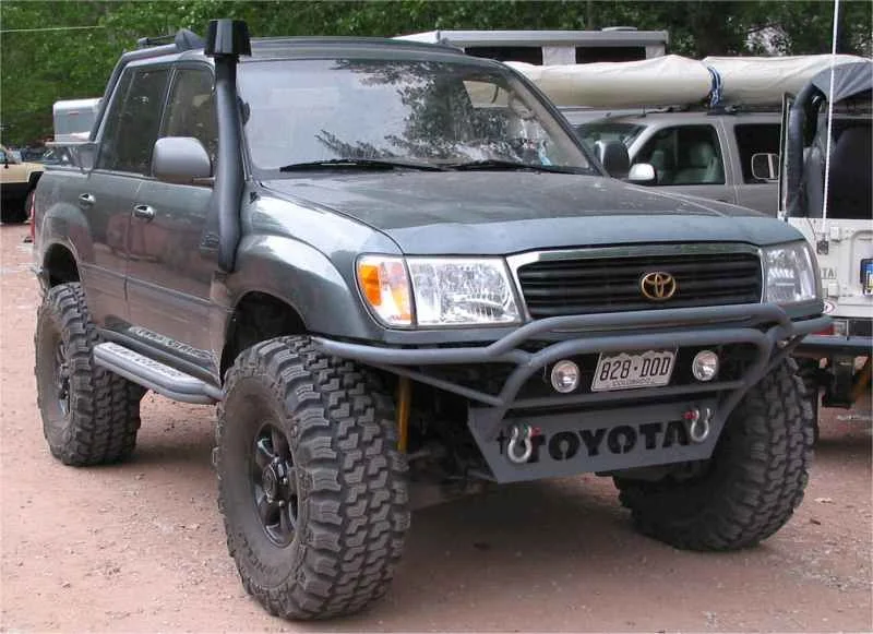

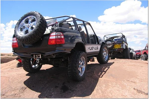

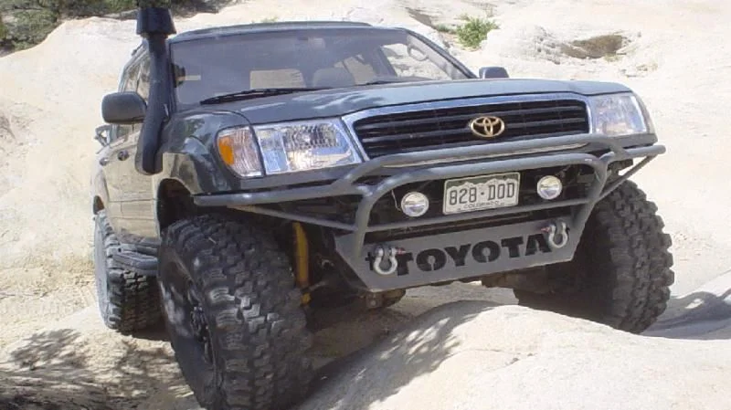

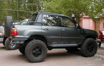

The pictures below show what is possible with firewall modification. If you have never attempted this before be careful to remove everything in the kick panels from the inside before you start cutting...
No one here has attempted much more than a small firewall trim. I think more trimming gets you to the 37" land.
Looks like some slider modification is in order also, but bolt on kits can just move them back slightly. If you have a weld on kit you'd have to trim the end as shown in the picture.
I bet @40Habits has some insights

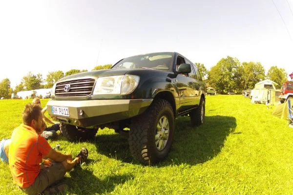

There are a bunch 37s pictured here:
There's a few pictures about that show it can be done. What would be nice though is some more detail on how it was achieved - is it body lift, suspension lift, body trimming, or a combination? There is no doubt more than one route and it would be nice to get some detail on the pros and cons of each.

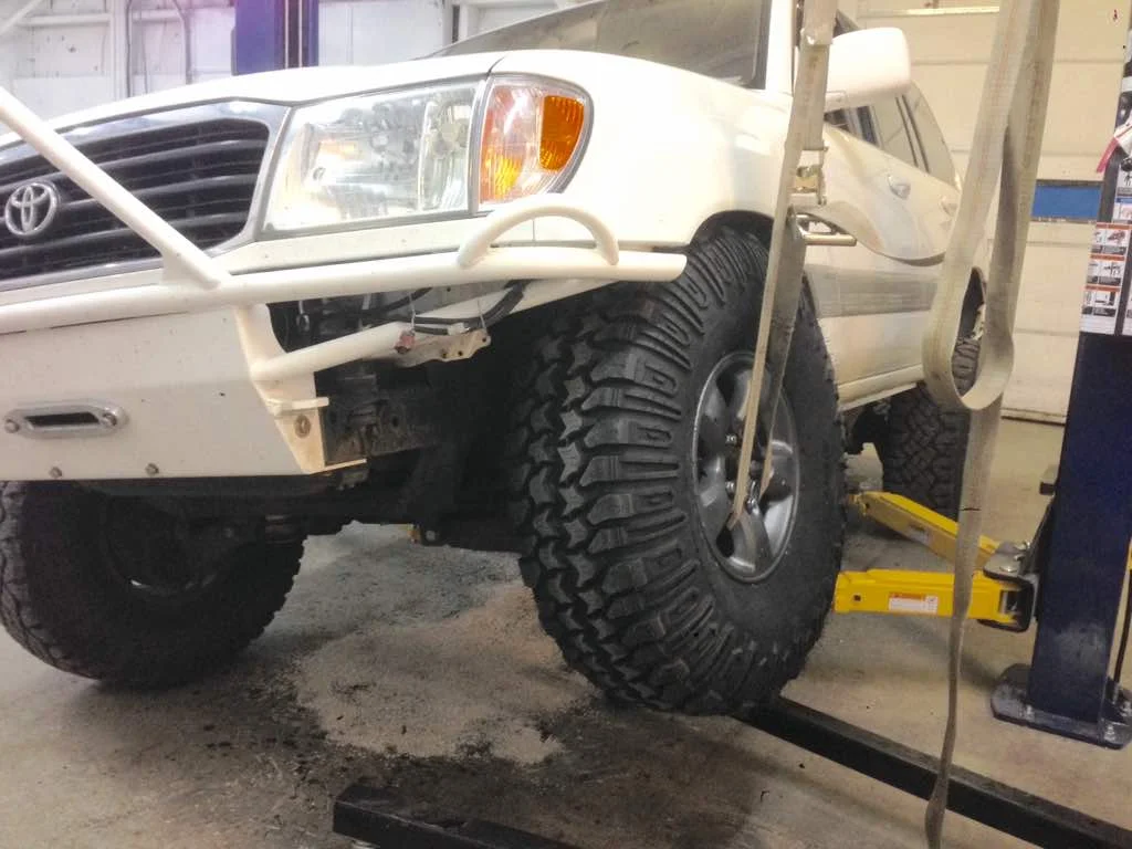

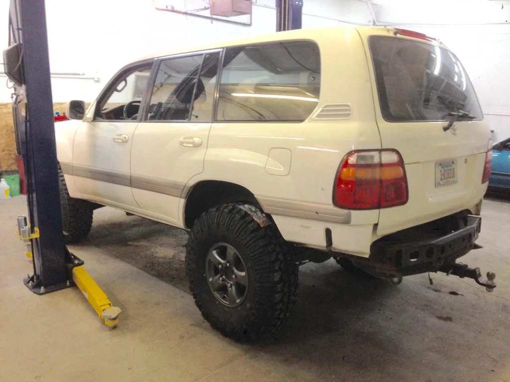

And when tucking the rear tire the fuel filler tube looked like it may come too close for comfort but it could be addressed.
This is with a 1" BL, 3/4" wheel spacer in front and 3/8" wheel spacer in back but it will still take quite a bit of trimming up front which I may be willing to do eventually, but not now. It's my daily driver. I also really like this specific 37" tire (Truxxs) because of a more rounded carcass which helps tuck a little more.

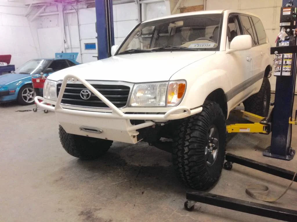

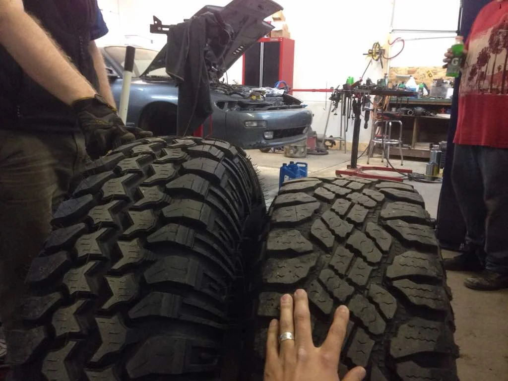

Just mounted the one on my spare wheel to test fit. Still running my 315 Duratracs. Here is a picture of the difference.

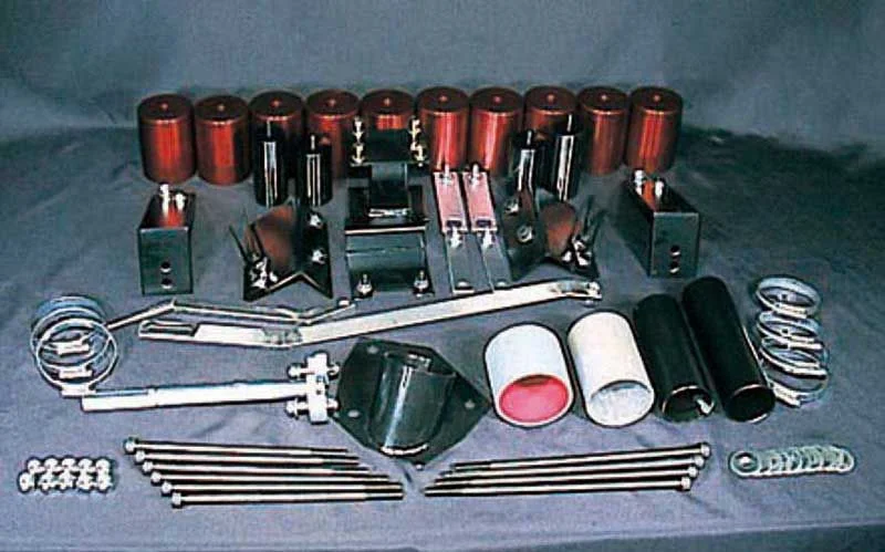

I've been looking at a kit from Japan similar to what was originally mentioned by Hoser in this post How's your 100 Series Body Lift? This is a comprehensive kit to lift the body by 4 inches and includes radiator drop brackets, extended brake hoses, bumper relocation brackets, adapters for the steering column and transmission etc... In short, it is everything required to lift the body 4 inches.
