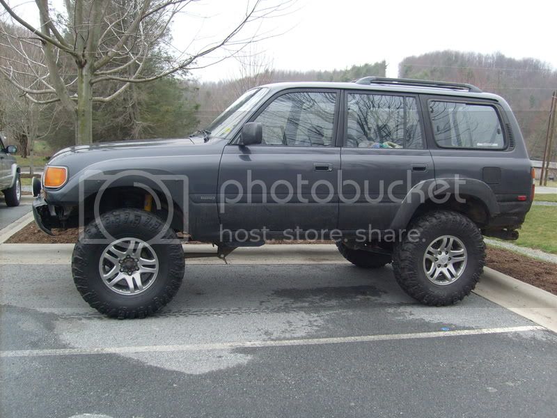

Well, I got my rig up on the forklift today to take some measurements. I will be fabricating a new panhard mount. This should dramatically reduce the side to side shift that my wheels/tires have during articulation. If anyone is interested, I may be able to have the bracket (semi) mass produced. For my rig however, it may be a two or three piece process (free prototype). Here is a pic of my axle at it's most stuffed position with 35's. I will use this as a reference rather than assuming that I will always run 37's once I make the move. The only area that looks like it may be a little close is the rear most section of the LSPV arm bracket, which I think can be dealt with:D.
