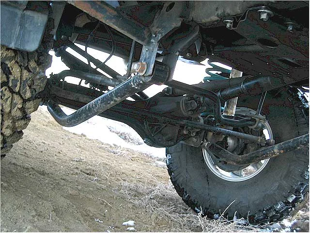

Stock arms in the stock mount locations wont work for lower links if you also want droop/flex, the tie rod is in the wrong spot. With the radius arms the axle changes angle/caster with travel, so the arm to tie rod clearance stays relatively constant. When 3 linked the axle angle/caster stays relatively constant as the arms swing, so much more arm/link clearance is needed, the stock arms don't have nearly enough clearance. I looked at this when the 3 bushing arms were made, it would have been much easier just to cut stockers than make arms. Not as simple as it looks at first glance!:hillbilly:

then flip the arms and make a axle bracket for on top the tie rod clearance.
if you point the pinion right at the tcase you dont think you could leave the arms going below the tierod?

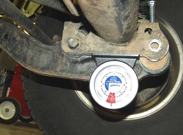

There isn't much caster correction room on the stock arms even with the stock setup. This pic is mine when it was being measured for the arm design. This is about as close as I would put it and would probably touch when fully flexed, needs more to lineup with the transfer and get to "stock caster".
The next pix are Ben/Brad's old truck, gives an idea of the clearance needed. Also note, the frame side is lowered. Cut some bushing holders to use stock bushings and weld them to bent tube?:hillbilly:
