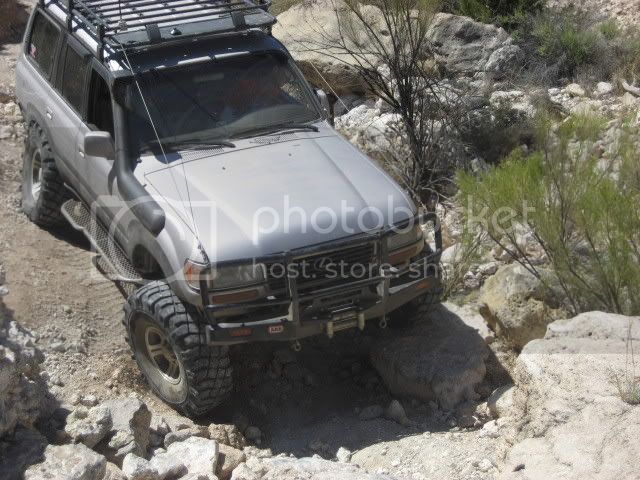

Well, I've been running my 35" Toyo's for almost a year and a half now. In that time I've read alot and wheeled alot and now I'm at yet another crossroad. Do I move up to 37's?
The consensus seems to be that making the move will increase my off road performance level. It will also bring my highway RPM's down thus (possibly) reducing the slight vibrations that I currently have above 55MPH.
Now for the downsides and my reservations:
1. I rub my 35's all the time. I think I have about 2 1/2" of bumpstop spacers and I still rub:crybaby::D on the outer edges of the metal of the wheelwells.
How much more spacing to the bumpstops will be
necessary and how much travel/articulation will I lose?
2. My steering is pretty unhappy right now too:crybaby:
I have mounted an aux tranny cooler and plan on
plumbing it to the steering before it gets too hot
and hopefully mounting a fan to it as well. The ATF
doesn't last long currently before it burns/breaks down.
I change my fluid every few runs. Maybe hydro assist
is the answer?
This is not my DD by the traditional definition. I drive it a few miles a day to work and back. My number one priority is it's off road performance and remote camping access ability.
I have wheeled Moab and many local trails and have yet to see, first hand, any rig with 37's do anything better than I could with my 35's but but rarely wheel with rigs as capable or more so than mine so my experience is pretty limited. Generally, I have the most capable rig and therefore don't get the opportunity to try out the really tuff spots. There are times when I have not been able to overcome an obstacle and think to myself "if I only had 37's":D
Another concern is that I have been so happy and impressed with my Toyo's that I would really like to run them in a 37 as well. The concern comes in the fact that they only make a 37 in a 13.5" tire. Will that thing even fit? like I said earlier, I currently rub the left outer wheelwell lip consatantly. I also rub the inner body on the right leading me to believe that 12.5" is the max width possible?.
I'd love to hear from those of you that have run both. I've read from some that 37's are a big improvement over 35's and some have said they wish they'd stuck with the 35's. I will be running the Rubicon this summer if that helps to solidify what my priorities are:D
EDIT: Heres a pic for your viewing enjoyment:):

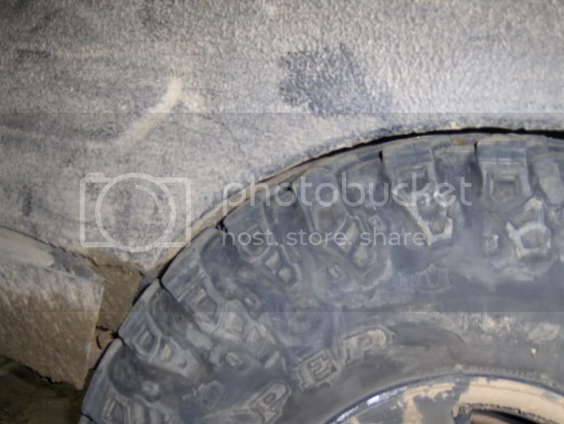

I am running 37x12.5 Irok radials on 10" wide 15" rims on a Slee 6" lift and this is what it looked like with no bump stop spacers in the back, putting the 2" bump stop spacers in almost fixed the rubbing. I am going to try some 8" wheels this year to see if I can stay at 2" bs spacers and not have issues when the tyres are packed with mud.
If you can get the Toyo's on some 8-9" rims you might be able to get away with them? I have only seen the 37x13.5x18" mounted on a 18x8" rim and they did not seem any wider than the Irok's I have on mine.

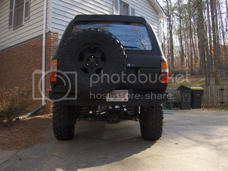

The pic below are my trxus (35.0") fully stuffed with a 2" rear bumpstop drop. I have a 3" lift and have never rubbed on anything, and I have room to spare (and yes, Interco runs big). If I had another inch of bumpstop drop, shock (and therefore supsension) travel spaced down another inch, with another inch of lift, 37's would be a no brainer and I would have retained my preferred 50/50 travel setup. I'm not sure I couldn't run a smallish 37" MTR without any additional modification. A 36" would clearly fit with no mods.
Staying with the ~10" travel shock would keep you from starting to deal with coil travel issues (dropping the coil off the tower), and the 80's front isn't flexy enough to need to let the rear go wild with a 12" shock.

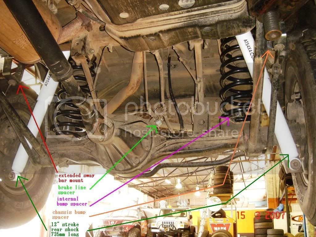

I also have 1 5/8" bump stop spacers fitted front and rear, but running 12" stroke shocks front and rear as well, 29" rears and 27.5" fronts.

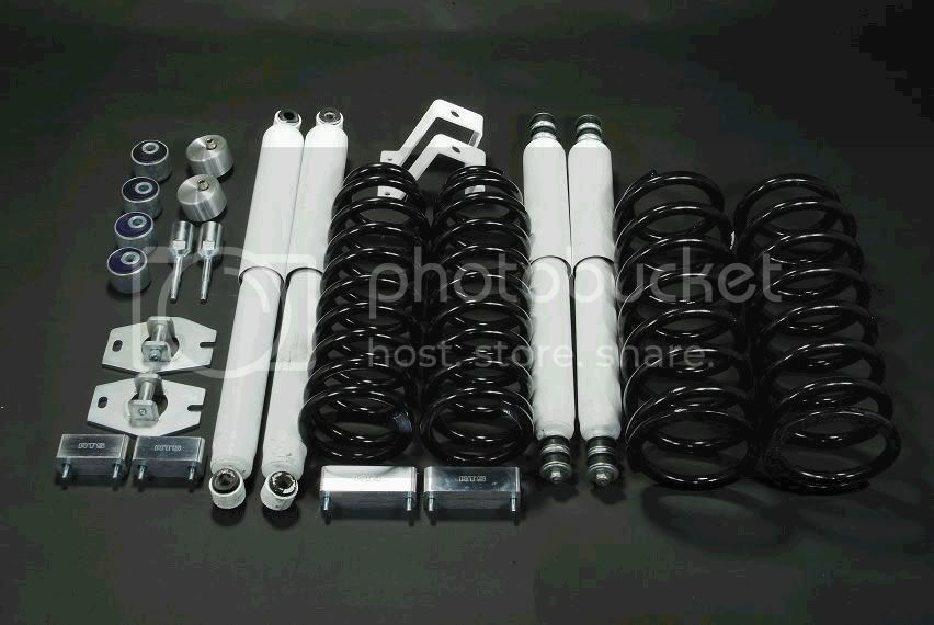

here is a pic showing some of the parts when developing the spacer/sway bar link kit early days
And this pic details the sway bar spacers, and brackets, round internal bump spacers which bolt onto the diff housing, and the chassis bump spacers we use for bigger tyres, with the longer shocks.
I am detailing the mods in my "PROJECT ROOBY" thread in the 80 section.
