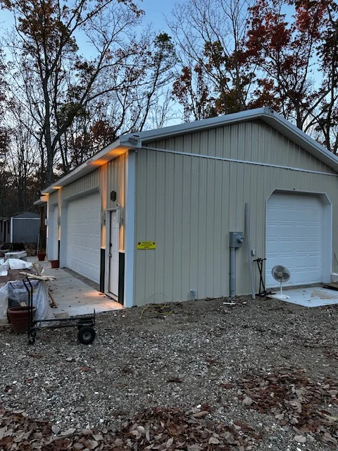

Rather than continuing to add your HVAC questions to Jon's thread, I thought I would post something here but I don't know the dimensions of your shop. It looks about like 20x30 (enclosed) but I didn't see you mention the size in the first few posts. Give us the size and wall height and that might help us with your questions a bit better.
Thank you @WarDamnEagle it is 24x42 with a 16’ ceiling at the peak and 11’ high at the front and rear sides and fully spray foam insulated. The front has a 10’ wide door and an 18’ wide door….one side has a 10’ wide door

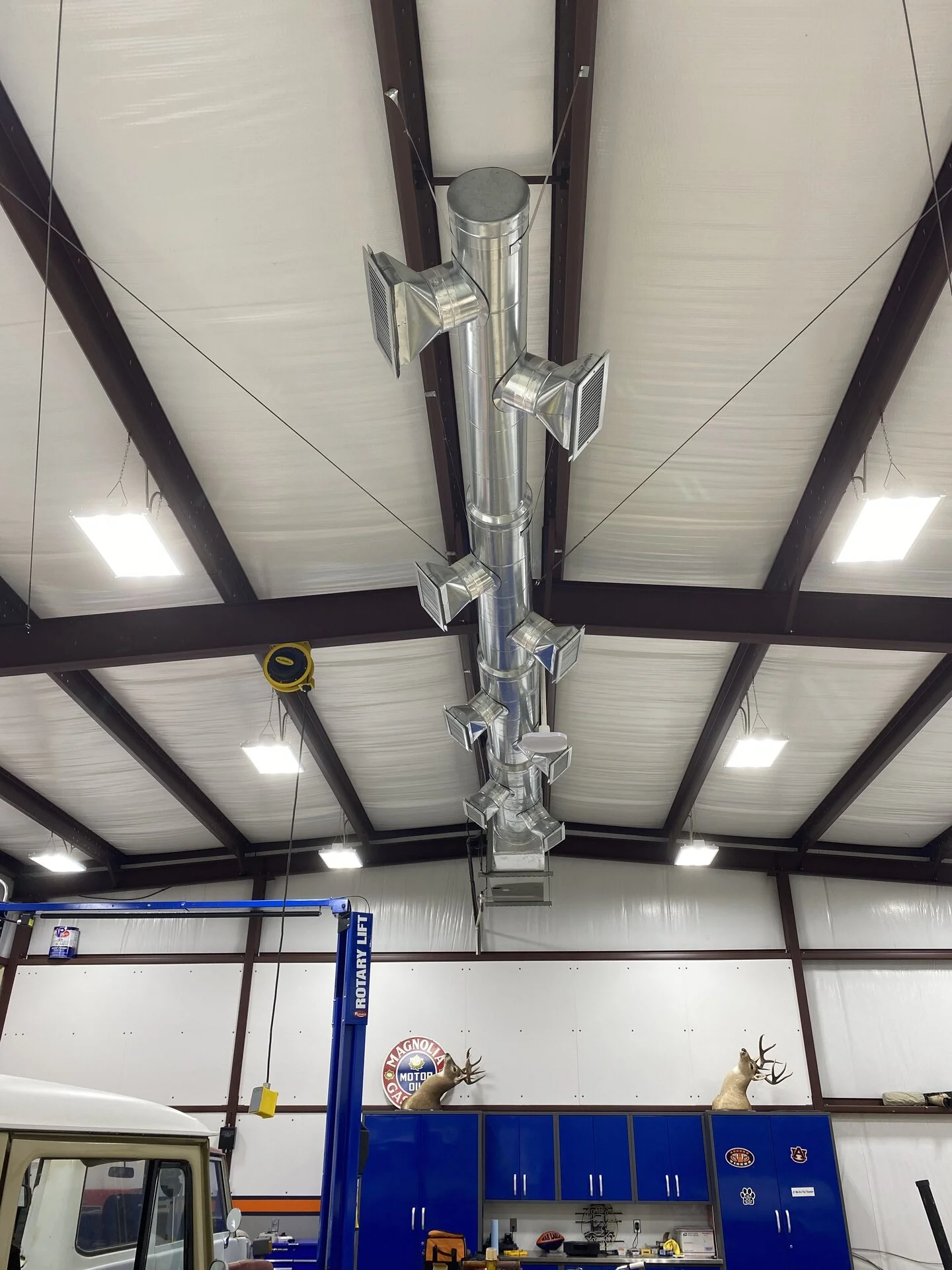

I am not an HVAC expert but I would think a 3 or 4 ton heat pump would be fine in that shop. You could put the compressor unit outside by the power feed and suspend the air handler just inside, under the peak and run a central plenum. Just a thought.
Here's a photo of my indoor plenum and air handler. The outside part looks just like an AC unit sitting on a pad.
