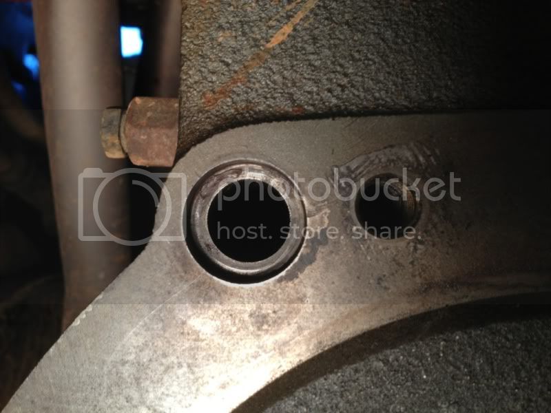

I need some advice/ info on my welch plug.
I got the plug from Toyota. Part #90330-24013
The plug that was in there was pounded in too much so it was leaking. I removed it and tried my hand at inserting a new one. Used a wheel stud about 2/3 the diameter of the plug so that is where the marks on it came from. Ideally the plug would flatten out and I would be convinced it is good, but it is still ever so slightly domed.
Does anyone have experience installing these that could write about the process and give some feedback on my pictures?
Plug removed:
Installed:
Thanks guys! Hope you had a Merry Christmas :)

Thanks for all these tips guys. I will have the cojones to get it done right. Glad I bought two plugs :)
But you did say "Welch plug"...synonymous with freeze-plug
This is incorrect in 2 ways.
First, a Welch plug is a very specific type of convex round plug w/ a sharp edge. It is installed in a hole w/ a stepped bore. The plug has to be beaten flat once installed to expand it for the proper seal/press fit.
Second, 'freeze plug' is hillbilly slang for a core plug. Core plugs are used to plug core out holes in complex castings (engine blocks, heads, manifolds...) that are used to clean out the casting core material (usu. sand). Core holes are usually finished to a smooth bore and sealed w/a press fit cup plug. Vintage engines may use a welch plug for this purpose, but manufacturers got away from them ASAP, because of the more expensive machining and installation cost. Aviation and racing engines may use threaded core plugs.
The proper sealant for either a welch or cup plug is Permatex #1, hard setting. Silicon RTV sealers are actually slippery which is good for gasket expansion, but bad for mechanically retaining a plug.
A cruiser tip for the rear oil & cam plugs: If there is a concern that the plugs might leak or pop loose in use, fill the outside of the plug w/ JB weld, put a piece of clear packing tape over the plugs, then immediately bolt on the BH. After goop has hardened, remove BH, peel off tape, proceed w/ engine assembly as normal. Solid goop will insure that internal oil pressure cannot blow plug out to back of bore and really gush oil.
That's all I got.

Wow. That's a lot. Thanks to Jim and all other contributors. That JB weld tip is a good one!
Just did the JB Weld trick with Permatex #1 on the new plug. Waiting for it to dry. This should be a lot better now :D Thanks Jim!
Just to let y'all know I got the beast running. bone dry!
