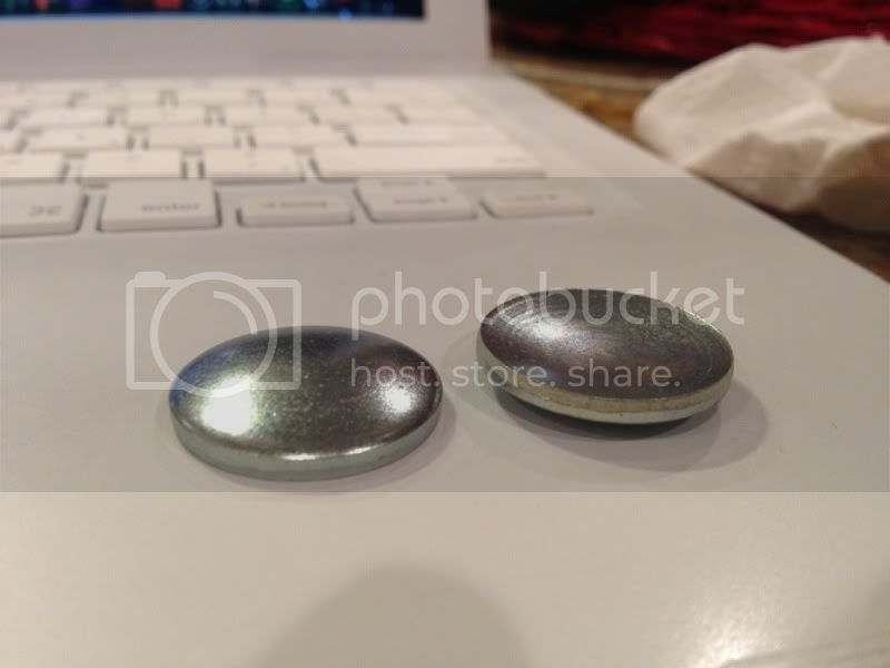

The plug that was in there was pounded in too much so it was leaking. I removed it and tried my hand at inserting a new one. Used a wheel stud about 2/3 the diameter of the plug so that is where the marks on it came from. Ideally the plug would flatten out and I would be convinced it is good, but it is still ever so slightly domed.
Does anyone have experience installing these that could write about the process and give some feedback on my pictures?

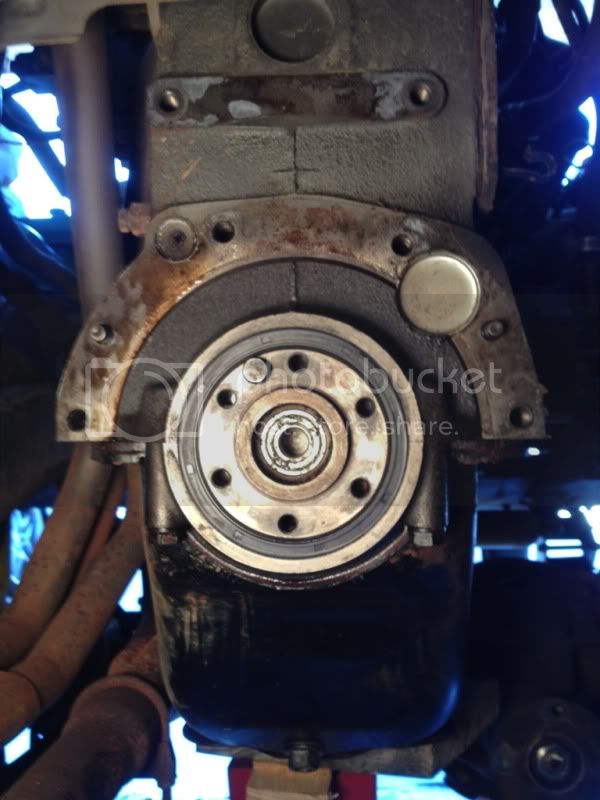

Posted after Pighead -- Is that a freeze plug or oil plug? Isn't there an oil plug there, somewhere, behind the Bellhousing?
This is part of the oil circuit.
Yes that's what I am referring to. See the third photo in this post.
The welch plug is meant to expand in the hole. If it is hammered past flat its diameter is smaller than if the disk was flat. So You want this to expand as much as possible. I just don't know if mine is tight enough. And then it needs some sort of sealing border.

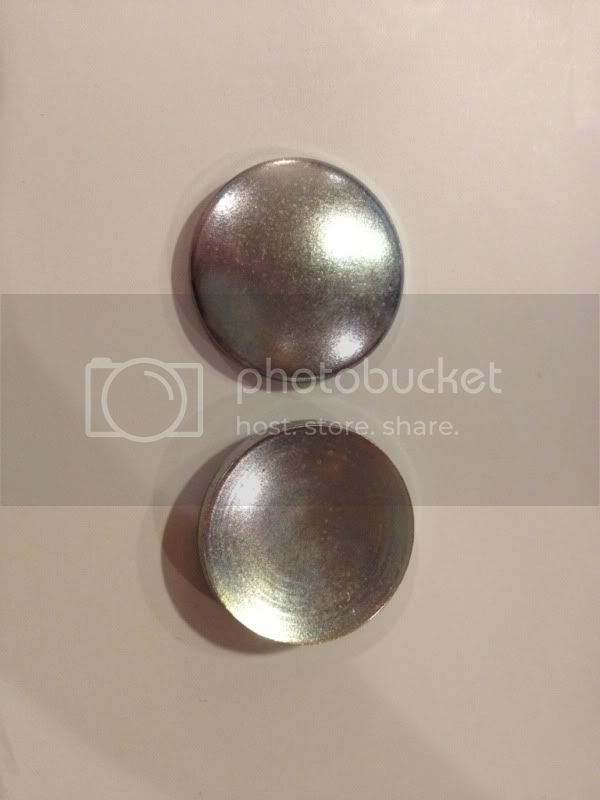

Here are some photos of the plug un-installed:
Where it is on the back of the motor. Notice all the oil:
Is that in backwards?
Nope. You put the plug in with the domed side out and then hammer in the center to expand it in the hole.
The faint ring marks you see are from a socket. I was using a bunch of things to try and get it more flat. (most effective sealing)

I put some Silicon Ultra Black on it. What I had at hand. Supposed to be the most oil resistant.
Do you guys know if it would be safe to run the motor without the flywheel and other parts? Basically like it sits in my photo of the back of the motor?

If it were me doing this, I'd find a brass or other metal dowel that was just smaller that the hole and use a fresh plug with a dollop of good sealant and wale on it, till flat. That should do it. What else could you do but put the block in a 10-top press ?
Good point about the sealant on the plug first Spike.
