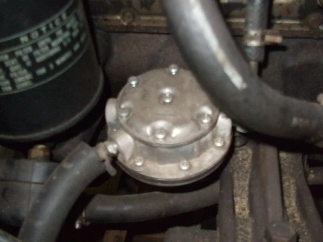

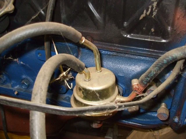

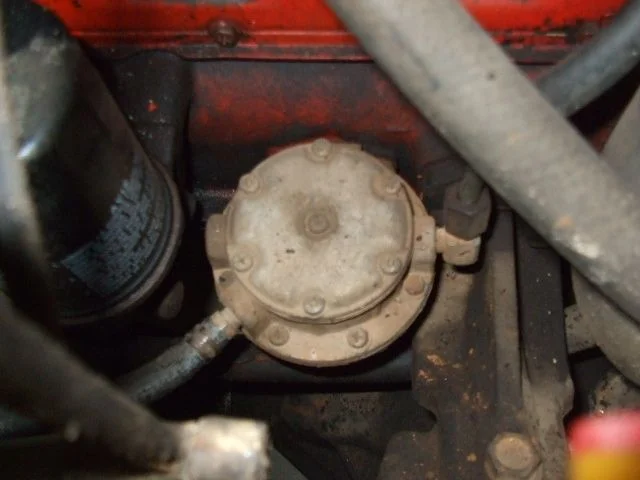

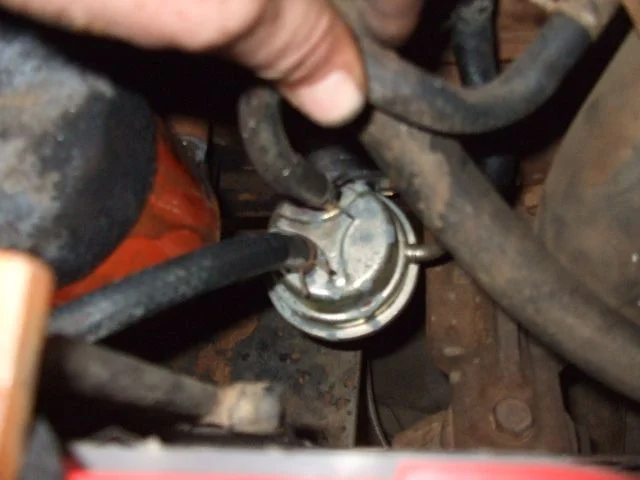

Here are a few of mine with 2F's.
Some have the "Pancake" style pump, which I'm sure you have. Some have the FJ60 vintage 2F pump with three nipples.
exactly. My fitting is in the hole closer to the engine. Mine is the pancake. I guess I was mis-informed (twice) by the dealership. Really sucks because mine is all painted up now and guessing I cant take it back.
