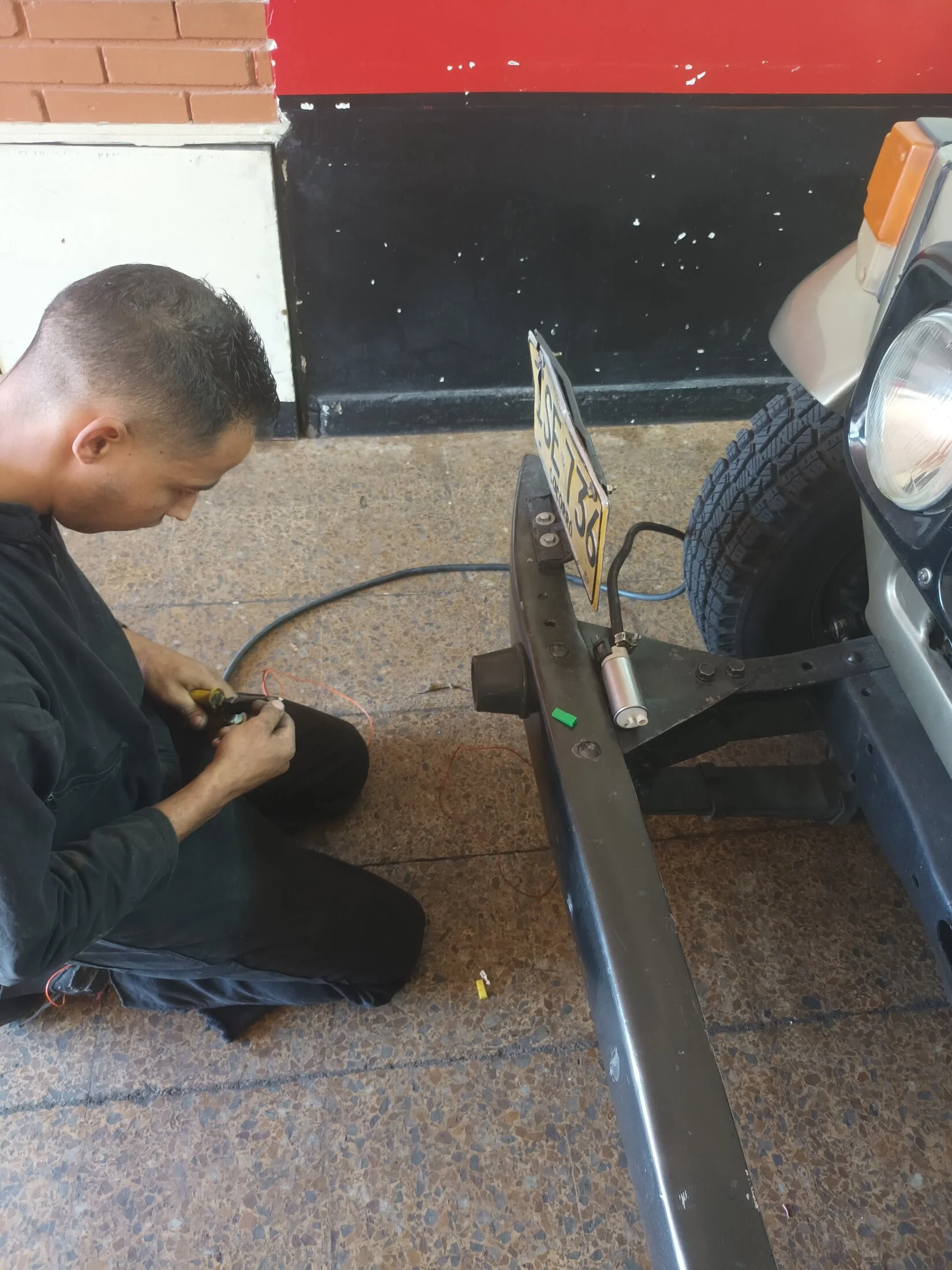

I've installed a little AC Delco electric pump in the meantime. Noisy...

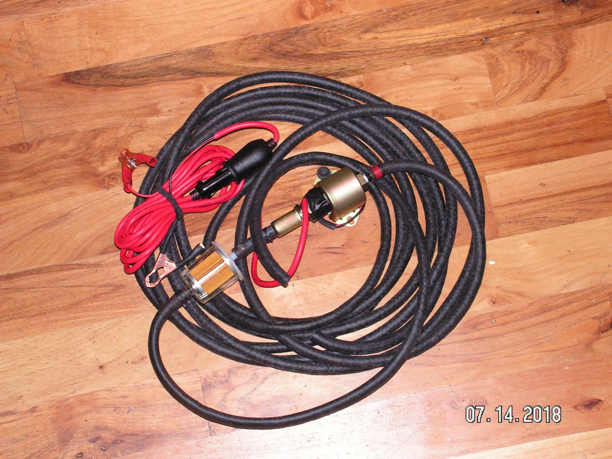

$50 Fuel transfer unit. Fuel pump Amoron/ebay $10, 25' roll fuel hose $25 ebay (20' on delivery 5 on suction) waterproof switch $5, 12' fused cig lighter extension cord $12, battery clamps $2, fuel filter $5 - it will also do diesel.

I've got an electric installed at the moment, yeah. I get some stalling but i never have more than $5 in the tank and the pump is on the wheel well just above it, so - yeah, could be overheating...pulling too hard...

My fuel transfer units can plug into the lighter or clamp on the battery.
The electric fuel pump in my F150 and Land Cruiser are wired into the ignition switch. My fuel transfer units can plug into the lighter or clamp on the battery.

My fuel transfer pumps are use to move fuel from 5 gallon gas cans into the gas tank or if I stitch the hoses around I can drain the gas tank on the truck or LC from the gas cap fill hole. I have given away several of these pumps to older friends that have issues holding up the gas cans to dump the fuel into their rigs.
