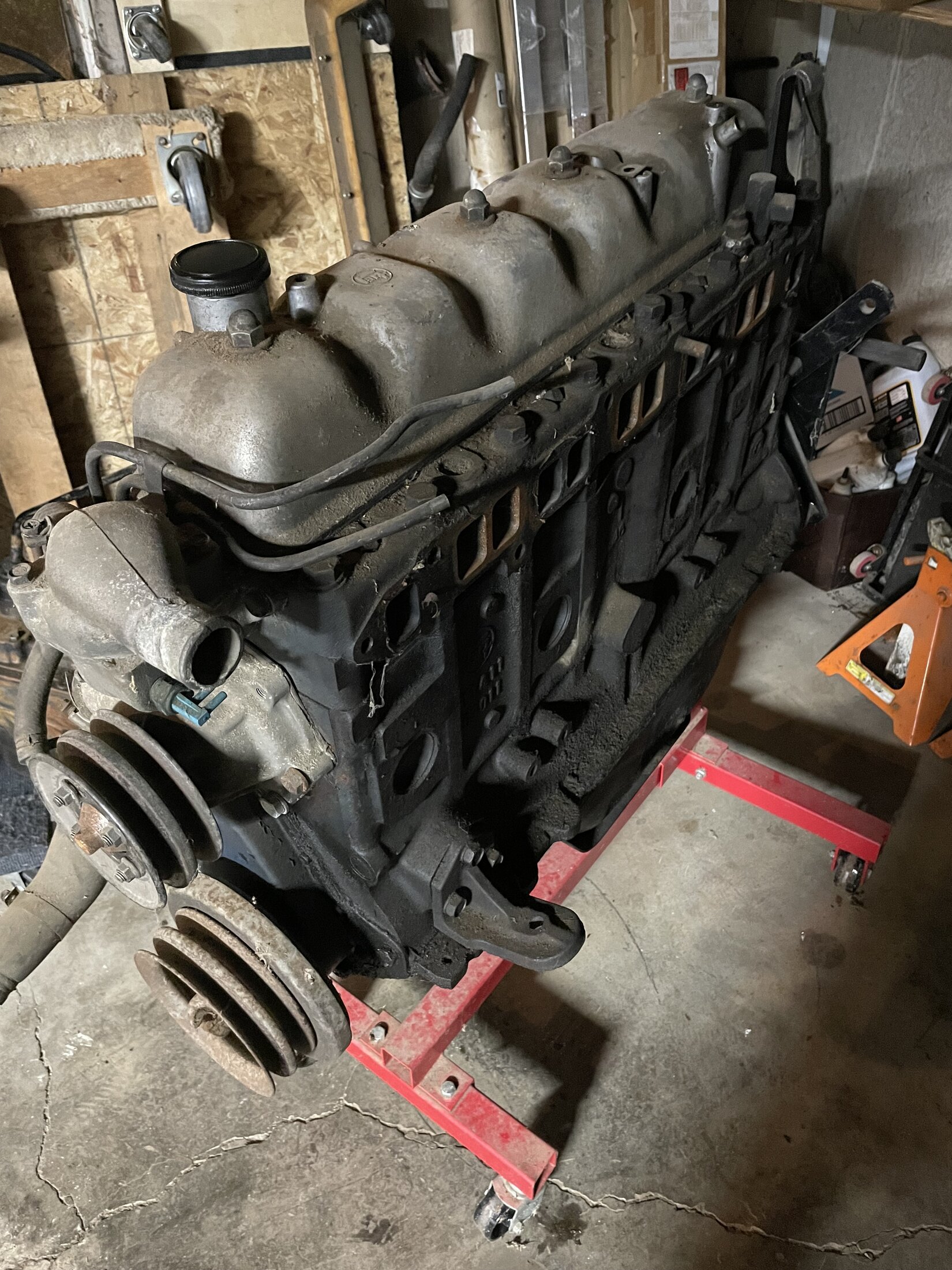

Afternoon everyone,
I’ve had this 2F for about a decade. I honestly can’t remember why I bought it other than it was close and probably a good deal. I do remember the gentleman said it was a good runner with no issue. He pulled it to put in an Isuzu diesel.
Is there any way on gods green earth to test the health of this thing with out putting a starter on it and hooking said stater up to a battery and doing a compression test? Would what I described even work?
Pull the plugs first and give them a shot of Marvel's Mystery Oil, let it soak for a day, to work on the rings. Hook up a direct read oil pressure gauge. I would invest in new oil and filter rather that circulate some unknown fluid. Bore scopes that plug into your phone are cheap enough to have a look.
Ok hook up starter to the battery and whirl it over until it builds oil pressure. Now test the compression - it will effectively be a wet test - better than risking issues from dry bores IMHO. Check the valve lash. Got a low pressure jug? Whack the valve in its plain of operation with a lead hammer just before TDC as the engine is rotating - maybe the compression blast will dislodge the deposit.
I bought a compression tester off Amoron for like $30. It has adapters to screw into the common sparkplugs threads - very handy when working alone.
I have little faith in most people opinion of "runs good" when they are trying to sell something, but maybe you will get lucky.

Hook it up and run the diagnostics no need to actually start it and perform a compression check? I did research on how to actually perform the leak down test when I purchased the leak down tester but want to confirm the leak down test will take the place of a compression test.

As stated, it is possible to do a dynamic compression test on a stand. Heck, I've done em hanging the chunk in the air on a cherry picker. come to think about it; might be safer on the cherry picker than that HF stand. if you wanted to hedge your bets, attach a cherry picker to back up the engine stand...
Starter, battery, yank the plugs, and block the carb open - even better if the carb aint on.

I used to start them up on the ground, so easy, jump the starter solenoid, 12 volts to coil positive and some fuel supply! Literally pan on the ground! It will start and idle like its in the rig. I have even seen bbc on a stand fire up, but would rather be on the ground for safety reasons!

I think I'd rotate the crank 2 revolutions by hand to confirm there are no internal restrictions, then pull the distributor and prime the oil pump with a drill.
The do a dry and wet compression test with the starter. I'd be looking for any weak cylders. Keeping in mind the compression is likely going to be down because it's been sitting for a decade or more, and the engine is cold. Any weak cylders, I'd probably do a simple leak down test listening for where the air is escaping.
It's junk; I'll come over and haul it away for you.😉
Honestly, a leakdown test will only help tell you if it's bad; a compression test will help tell you if it's good. Another good indicator of whether it's had a good life/is in good health would be to drop the pan and look at the main/rod bearings. I'd be doing this on anything that I was planning to install regardless.
