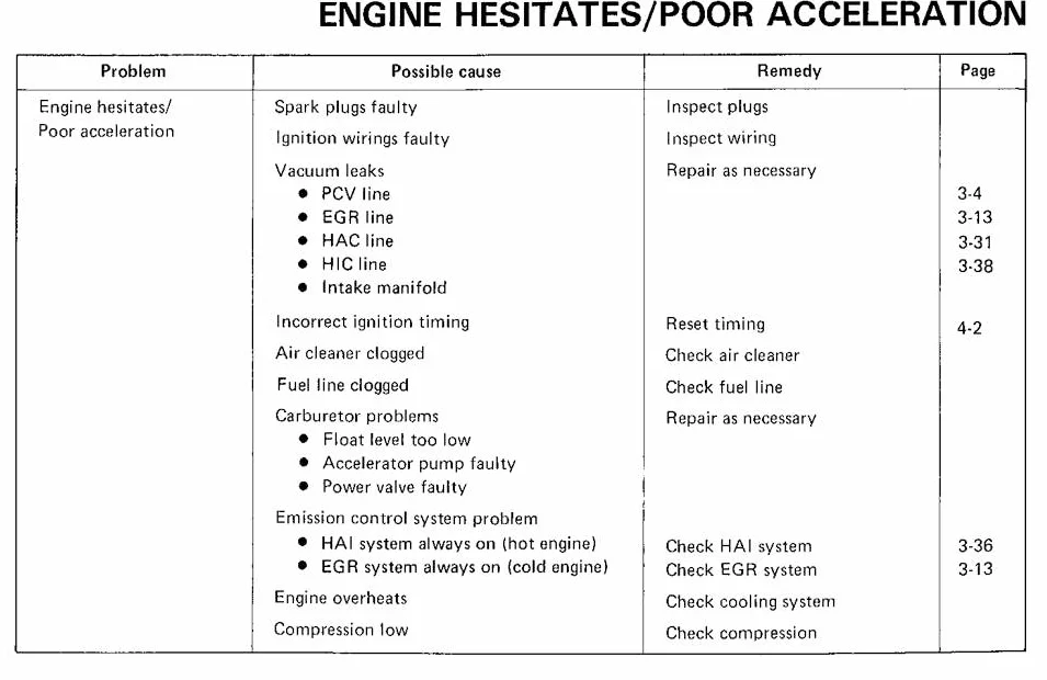

One other thing that causes a hesitation is the EGR modulator. Your EGR can be clean and functional but if the modulator is not delivering vacuum signal to the EGR it won't work when it's supposed to. Test for this by holding steady on the accelerator pedal in a certain RPM range roughly 1500 rpms to 2000 WHILE GOING DOWN THE ROAD. Don't test this with your choke or while idling at park. The hesitation will go away while excelerating hard through this rpm range or while above or below those rpms. There are tests in the emissions FSM to determine if the EGR modulator is bad. Also the check the EGR VSV. both the modulator and the vsv send vacuum signal to the egr to tell it to turn on and off while going down the road.
Also I didn't hear you say you checked the fuel lines. The fuel filter? Did you see if the fuel is 1/2 way up in the site window in the front of the carb? You can easliy disconnect the fuel line from the carb and have someone crank the motor and catch some fuel in a clear jar. Make sure to disconnect the coil line from the dizzy to prevent starting while you do this. You can check for obvious clogs and fuel quality here.
