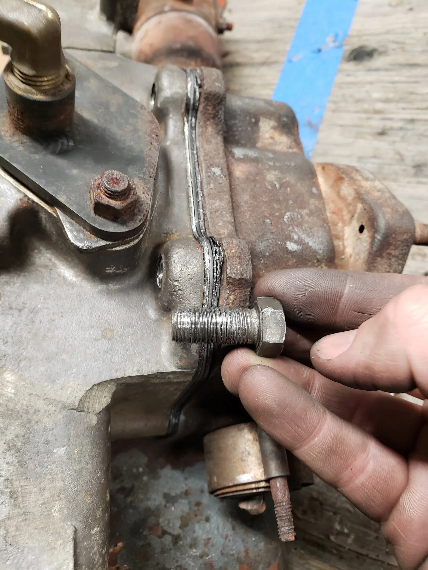

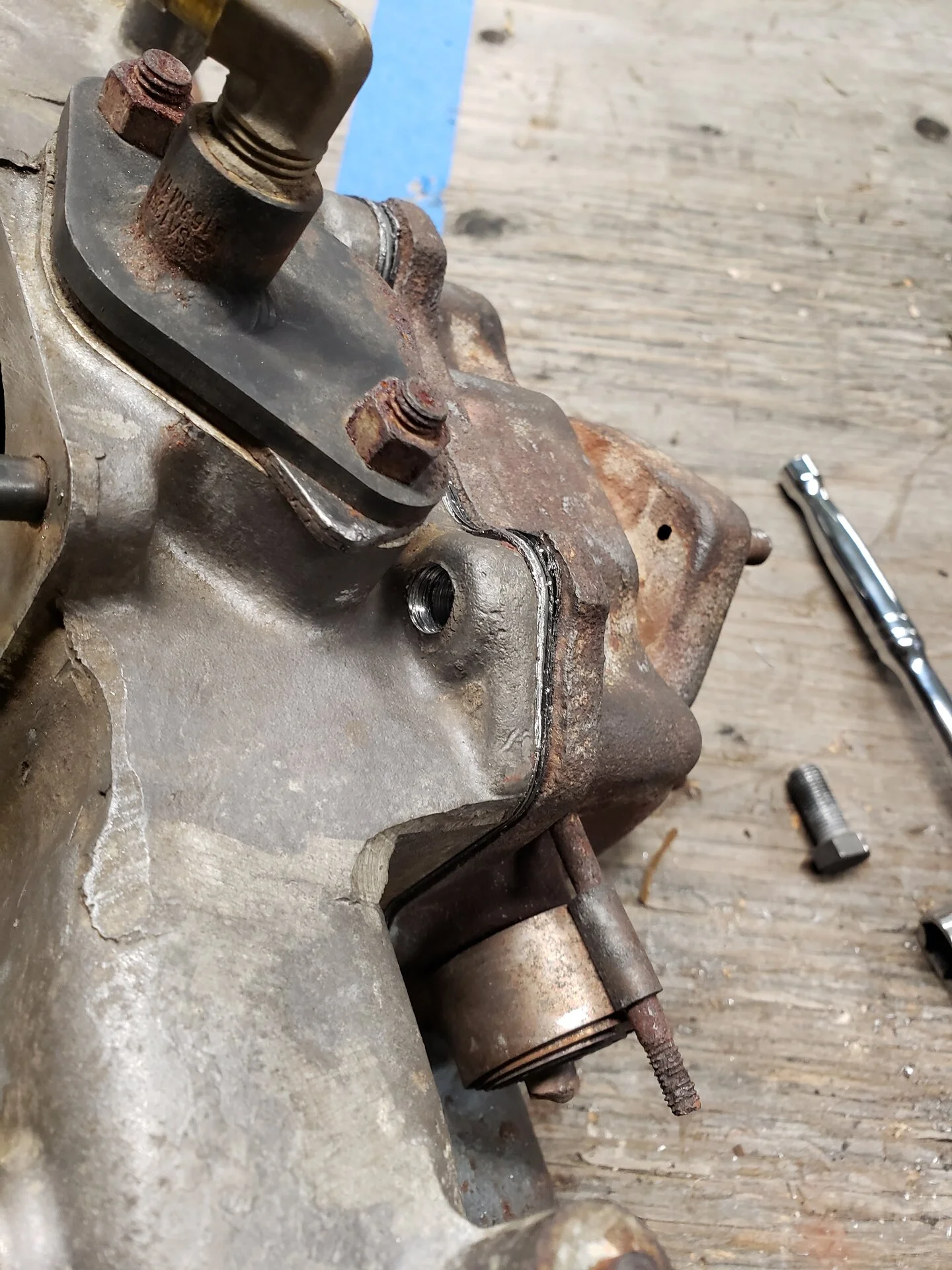

Ok, so I took the intake and exhaust manifolds off and got them resurfaced at a local machine shop while messing with the carb. I'm having an issue with these two bolts that connect the I take and exhaust manifolds together
The bolt holes stripped on the intake side and I cant find the size of the bolts in order to fix the holes/get new bolts. They're neither M10 (too small) or M12 (too big), so are they standard? Any help would be appreciated

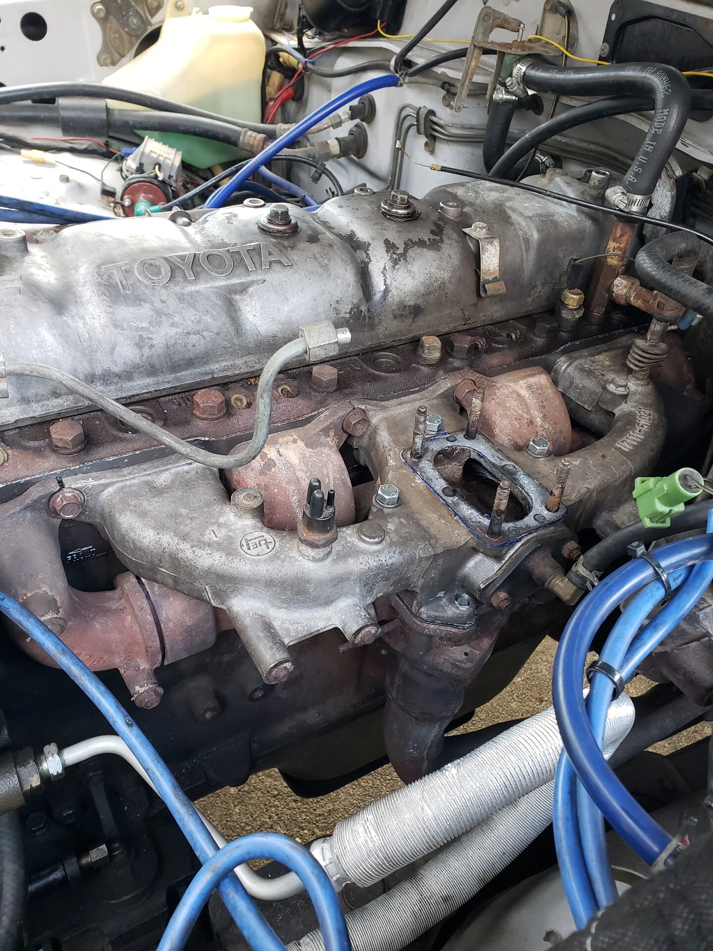

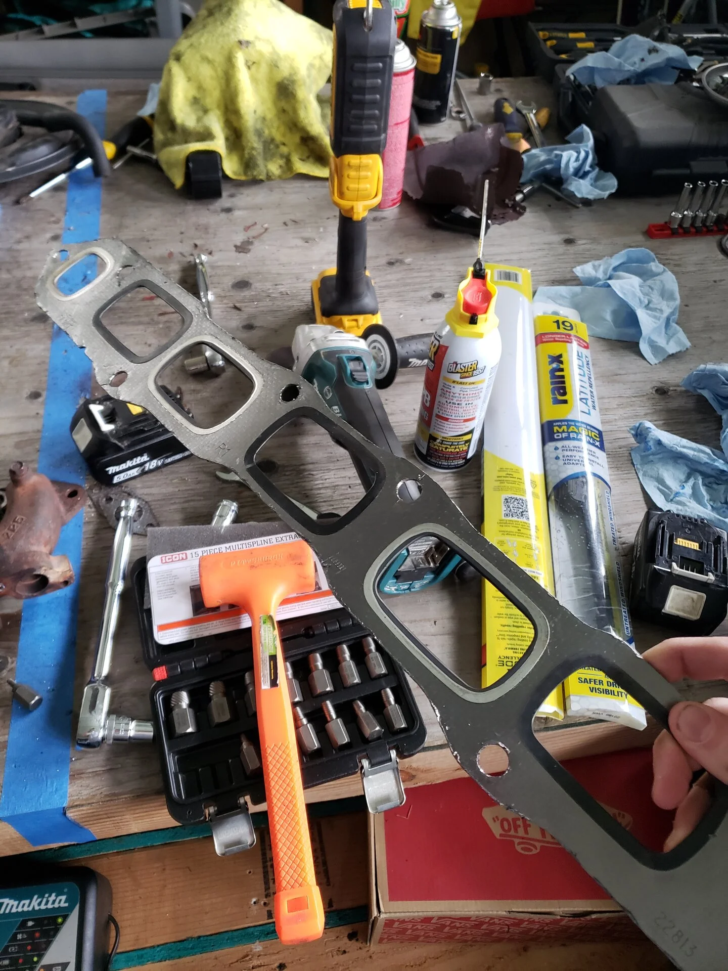

Ok everyone I'm back with some updates! I got the manifolds put back onto the engine with new gaskets and got it all bolted up with the exhaust downpipe and the carburetor.
I fired it up, and well, there is an awful high-pitched whistling and the truck is backfiring and sounds like it is down 2 cylinders. Could I have installed the manifold gasket incorrectly? Is too much air being sucked into the motor through the manifolds and it's causing these issues? Do I need to pull the manifolds off again and re-inspect? Here are some photos of the manifolds in place with the new gasket:

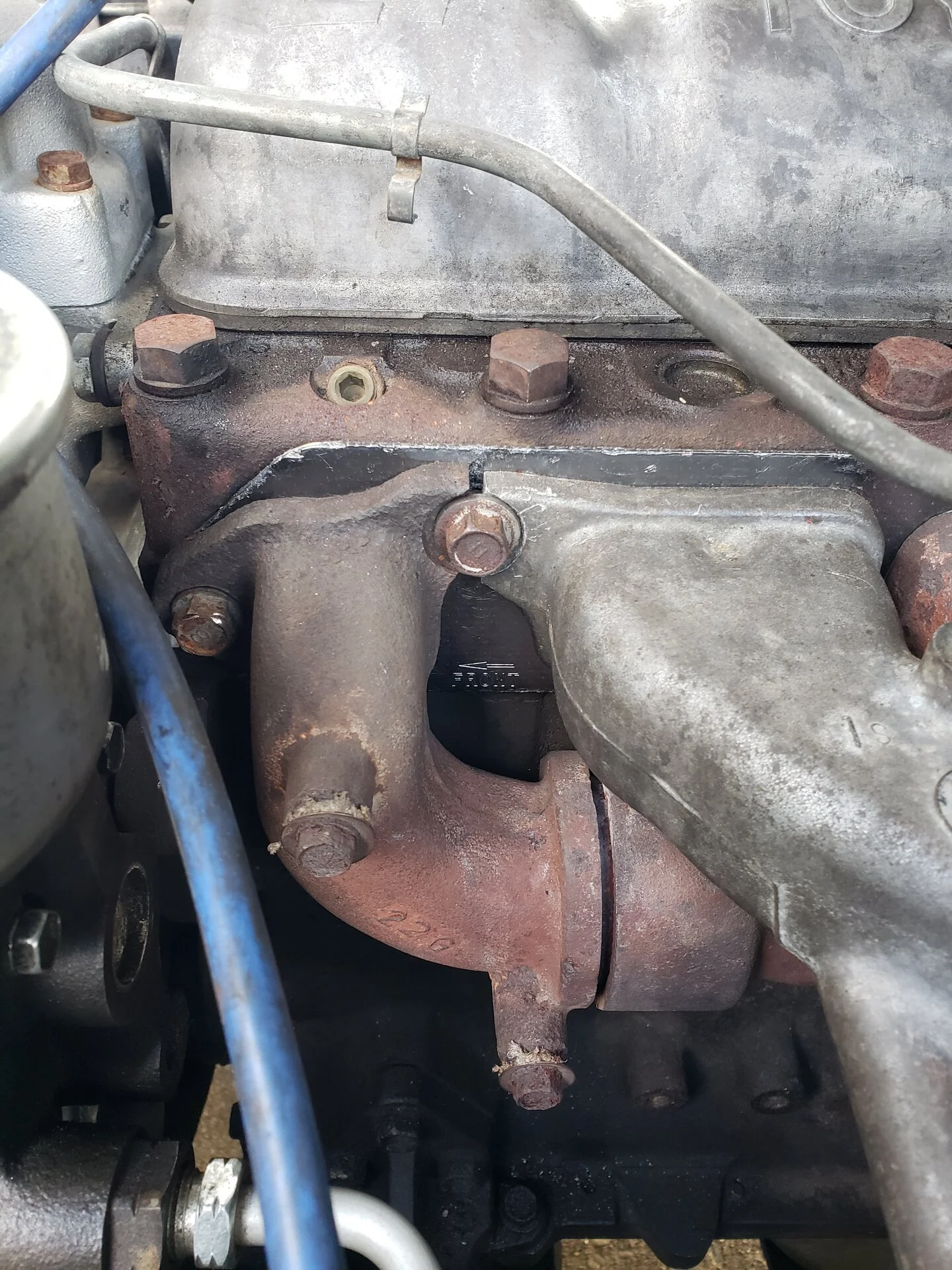

I'm also wondering if the gap between the exhaust and intake manifold is too big as seen in the 2nd image?

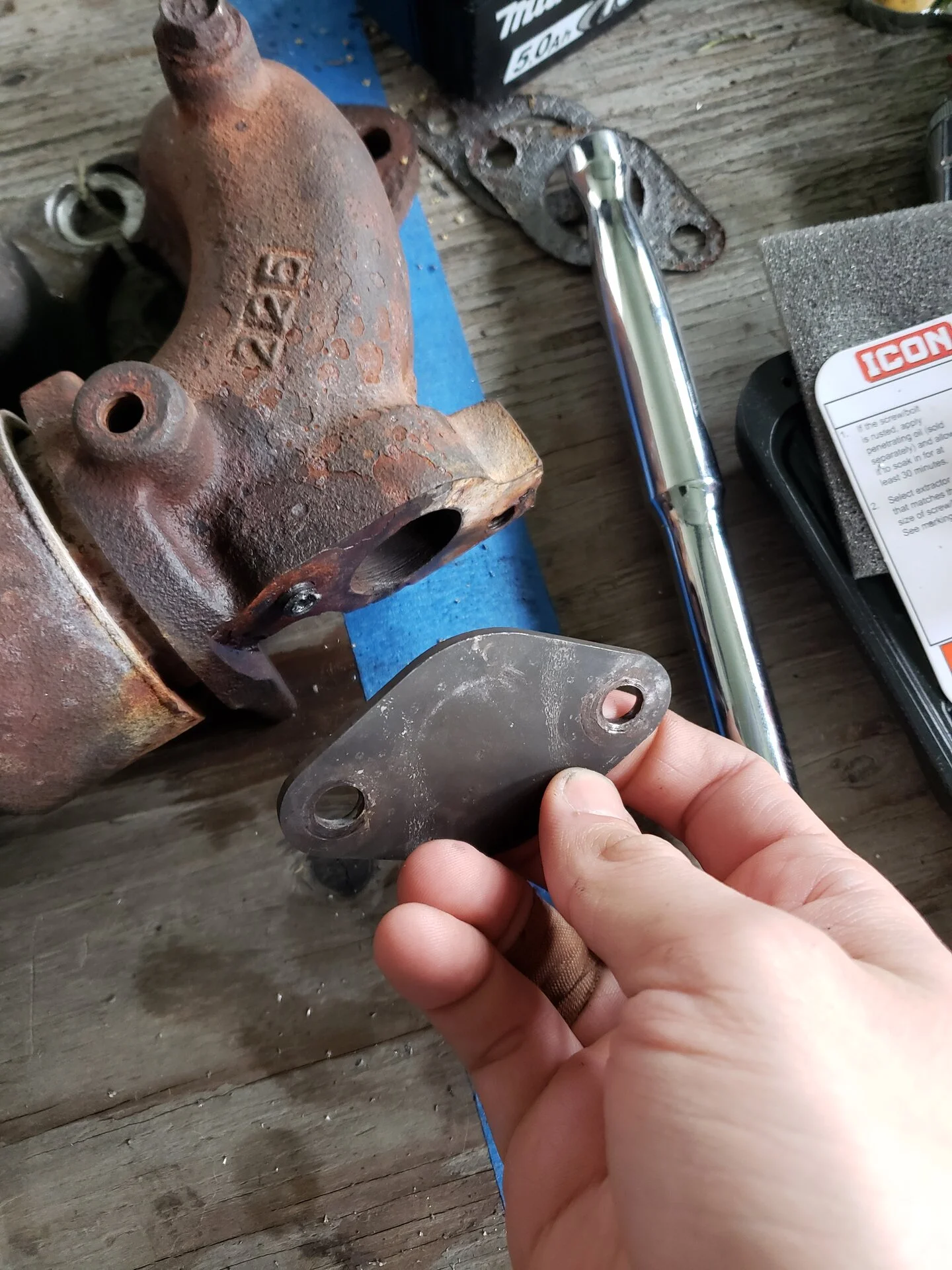

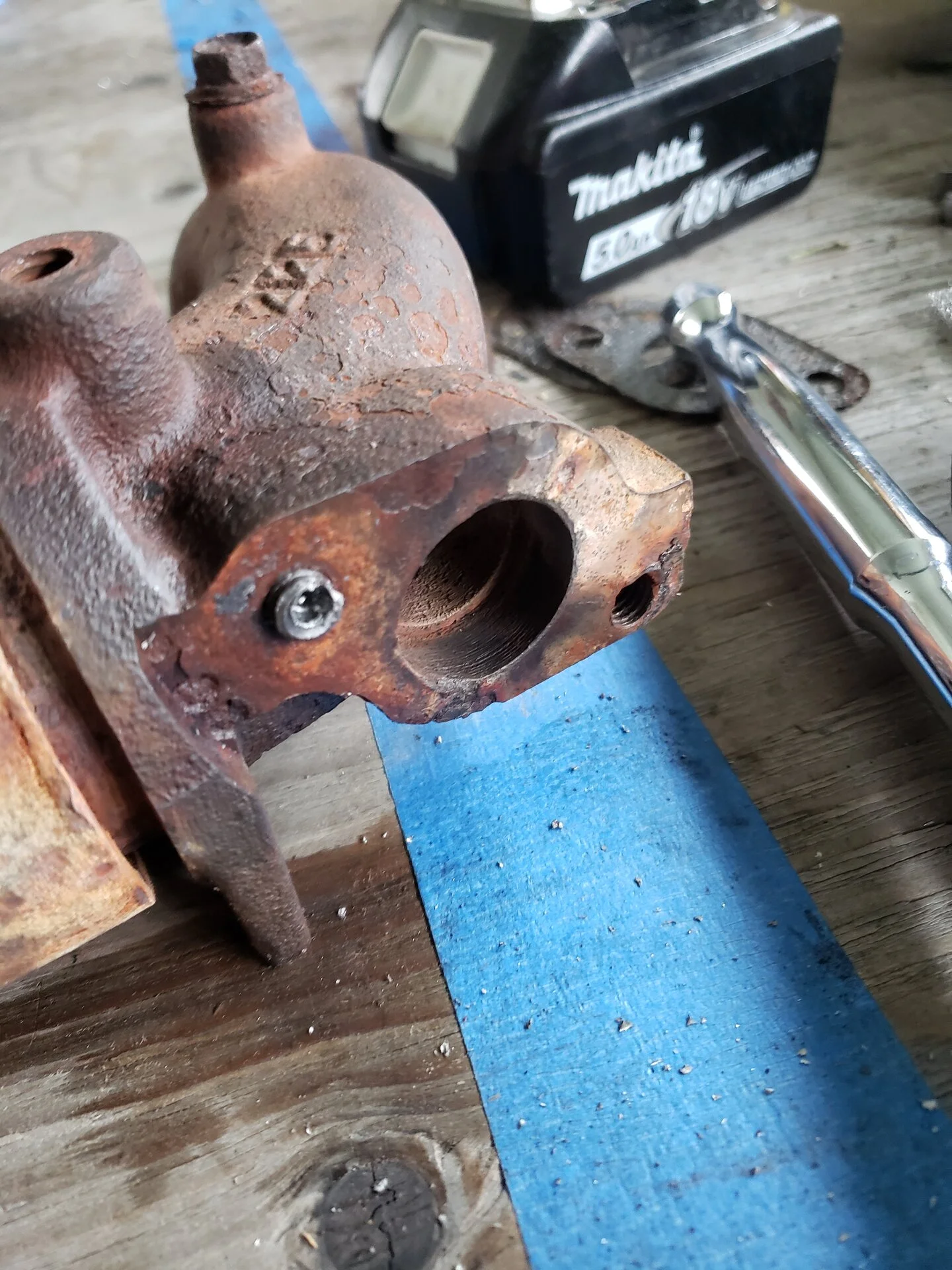

One thing I did notice was this piece here on the far right side of the exhaust manifold
It seems bent on not fully forming to the manifold and had two gaskets between it and the manifold, but it still looked like it wasn't forming a proper seal. Maybe this was causing the issue?

Also, is this Fel-Pro gasket for the manifolds a good one to use?

That plate you removed on the rear of the manifold arm is a previous owner attempt to block off the EGR exhaust port. Normally a pipe bolts to that spot that leads to the EGR cooler then up to the EGR valve.
There’s nothing wrong with doing that once the EGR system is removed but that plate may have been leaking. It would be an exhaust leak, not a vacuum leak.
Exhaust leaks can sound unpleasant but they typically don’t suck power. Engine will still run fine but sound yucky.
Yeah I was thinking it'd cause an exhaust leak as well, but that wouldn't cause the issue i started having once I had put everything back together. what seems to be the issue after I put the manifolds and carburetor back on is maybe there's an intake leak through the gasket, but I'm not sure as the front has been resurfaced and a new gasket was put in place.
Maybe it's a vacuum leak somewhere that came about when I tore it all apart? That wouldn't explain the loud whistling noise coming from the intake manifold however. Is there a way to test whether it's the intake or a vacuum issue?
Big Vacuum leaks can be seen on a vacuum gauge when the engine is idling - vacuum is low.
On a tight engine at sea level it should be around 20 inHg. At higher elevations it’s lower because the air is thinner.
That gap you pointed out on the exhaust manifold arms is normal. There’s supposed to be a gap.
A vacuum leak pulling air past a right sized oriface can definitely whistle. An exhaust leak generally creates a pft, pft, pft sound
Maybe one way to find that damn whistling sound is get the engine idling so it whistles — then start spraying a water squirt via a hand pump at every suspicious joint you see. If the water covers the noisy air leak for even a moment, you might be able to hear the difference - no whistling for a second or too.
Then explore that area more carefully
If the manifold assembly has never been machined flat by a machinist in the past, it’s guaranteed to be warped and not sitting flush on the head. At this point- all virgin 2F manifold assemblies are warped. Mine was warped in 1988 when the engine only had 42K on it.
