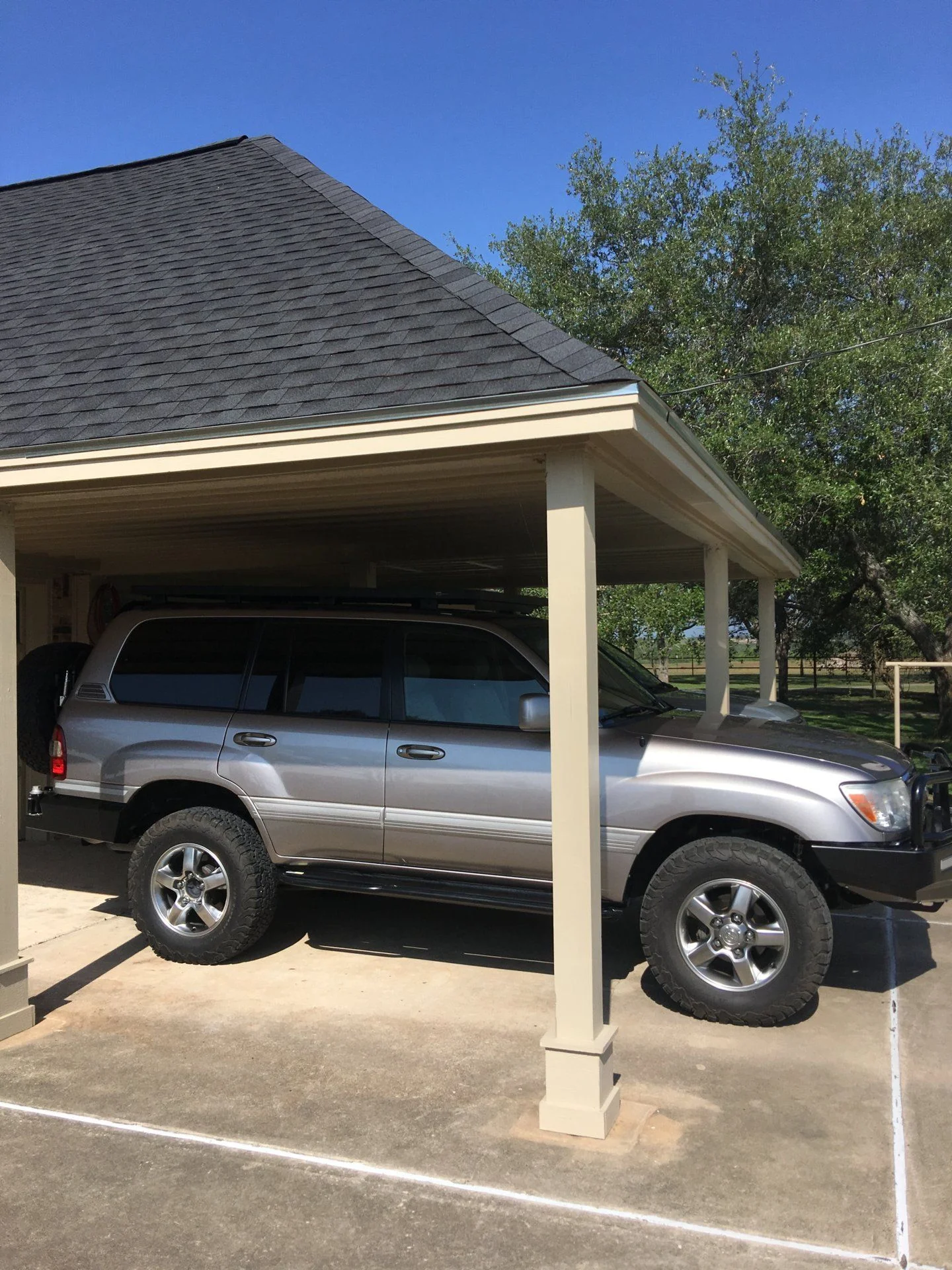

Love my 864s and I have bumpers and rack and most of the toys. Make sure you keep a little rake in the front. When I evened it out the truck did not drive right. Seems like the 864s are the ticket for lots of weight and big lift.
I was debating the same thing, I went with Icon 80 series stage 1 progressive springs (440-880 lbs).
Rides like a dream
23" hub to fender
