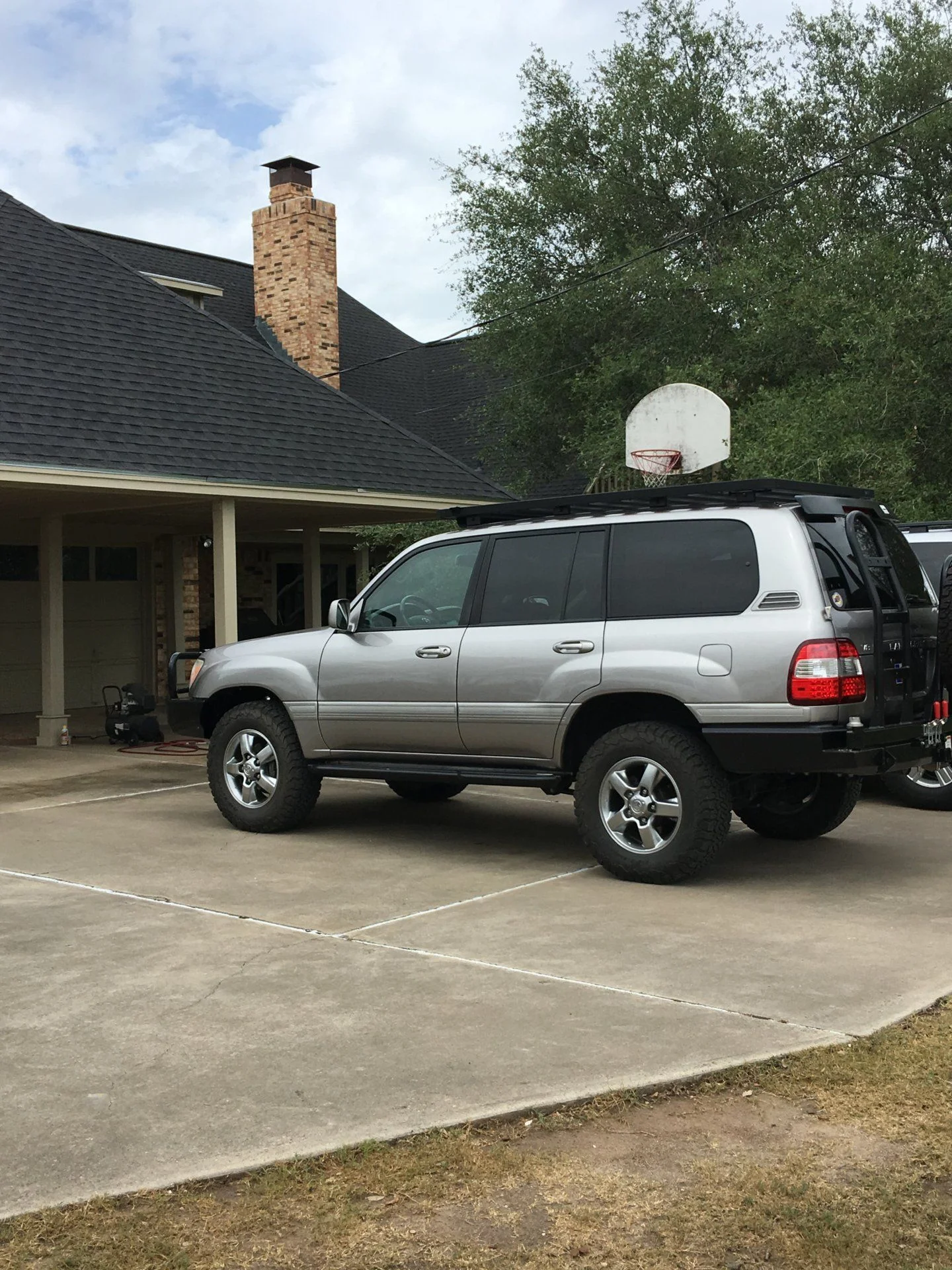

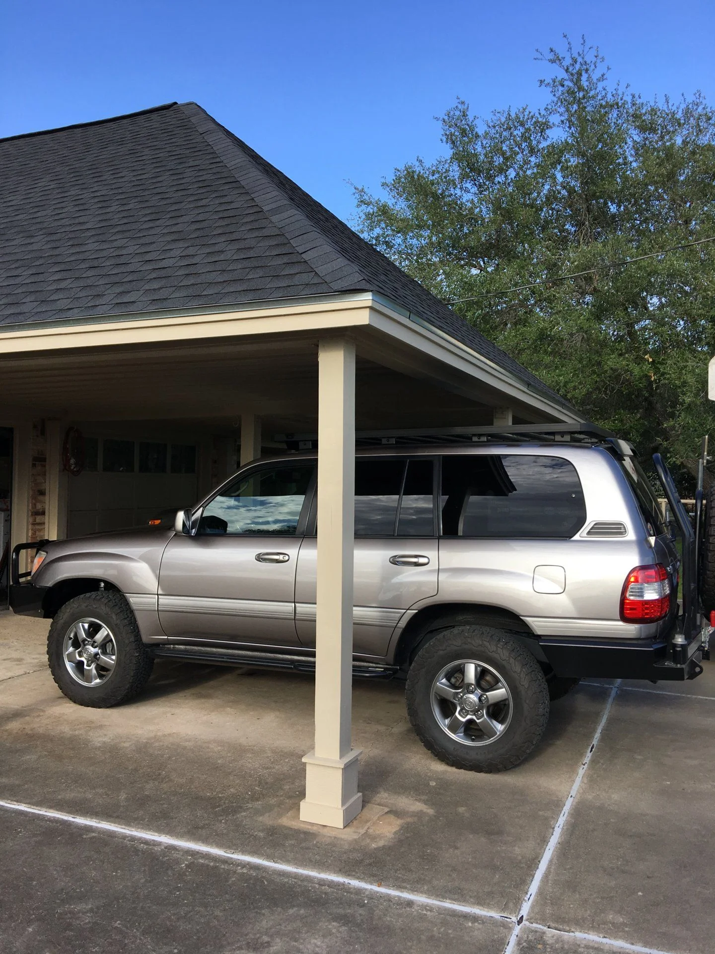

Cranked torsion bars today and front end is up to 21.5 inches. Rear has settled to 23
inches. Happy with the new stance. Before and after pics below.

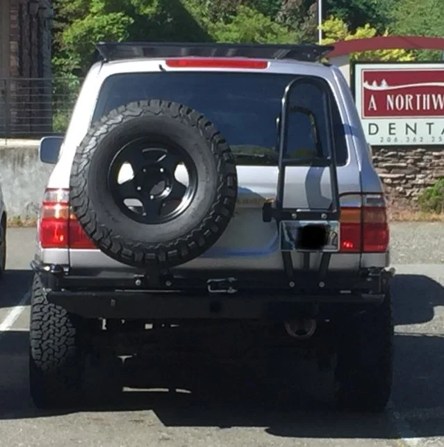

I'm going to resurrect this thread. I am adding a 4x4 labs rear bumper to the rear which will have a swingout for a tire. Are 864s overkill for this? No plan for overlanding gear, just a toughbox in the back with some misc recovery gear.
It might be a firmer ride with 64’s than 63’s. What kind of shocks are you running?
Agree with @fireball.
I had Slee heavies before the 864’s. I believe the Slee heavies are the same spring rate as 863’s but cut a little shorter to minimize the rake. Before installing the drawers and going to 864’s I had a similar set up as you (Slee bumper with swing outs) and the Slee heavies were perfect.
@Alibaster Check out the OME 866
At first I ran the 865 for 1.5” of lift and they were as comfortable as stock. When I got the bumper I moved over to slinky springs.
From my understanding and slee’s recommendation when I picked up their bumper was that 865 could be replaced with 866 or slee heavies.
